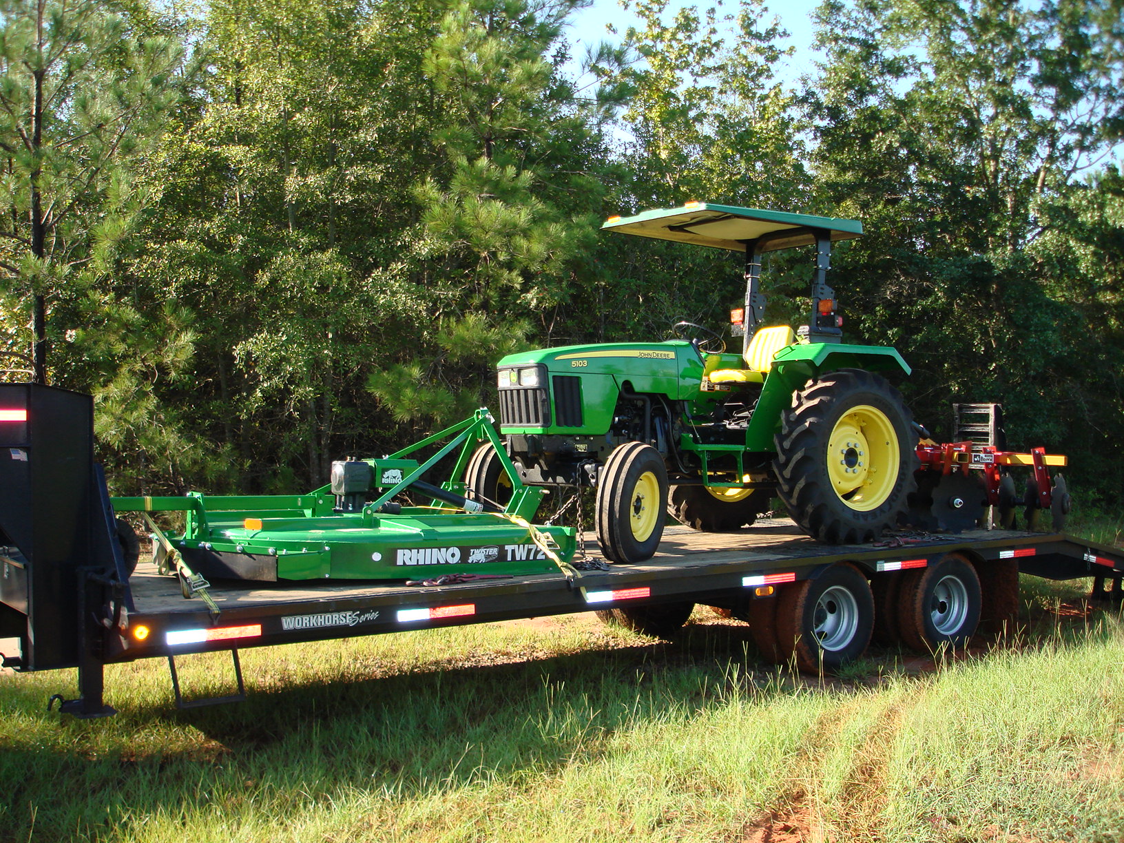

I bought a 5103 last September and have really enjoyed it so far. The local dealer here has 5103 advertised for $12,999. In GA there is no sales tax on farm equipment. I also bought a 6 foot bush hog and a 6 foot Brown disc harrow. I felt the disc was a little too heavy for the tractor since I was getting more front end bounce than I wanted and have since added 6 weights to the front, which has helped a lot. I have 160 acres of hunting land and my uses are similar to yours with food plots, roads and firebreaks. I would recommend getting a front end loader (FEL) with your tractor. I will be adding one next month. They can really improve the functionality of your tractor. I think the 5103 is a good value. It doesn't have all the bells and whistles, but it sounds like you won't need them. One thing for sure you want to add is a canopy top. Really keeps the sun off your face and neck when you spend several hours working. If you are afraid of getting the exhaust torn off the tractor from overhanging branches and limbs while mowing fire breaks or roads, consider having the exhaust turned down to run under the tractor. I'm very pleased with my set-up.
