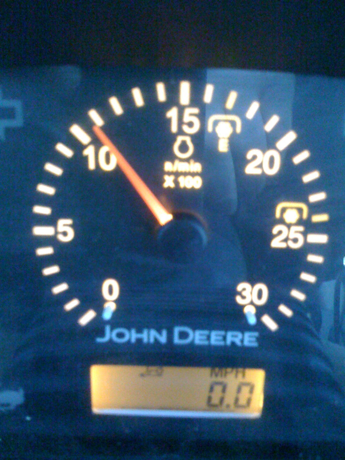

I know there was a thread on the ePTO and I could not find it. I was out working the 5525 today some and took some pics of the ePTO setup so people could see it.
The tach shows 540 RPM PTO at 2 different engine RPMS.

This PTO thing is not new. My 95 JD5400 has it also. Until I read this thread I never could figure out why there was 2 540 labels on the tach with several 100 RPM spread. Seemed to me PTO RPM would be linear with the engine.

I have to throw a lever and it uses a different gear to engage the PTO shaft. Thus a different engine RPM will maintain the 540 RPM PTO output.

I also throw a lever down to engage the PTO through its own set of gears. I noticed my tach does say 540e on the 1700RPM mark.
