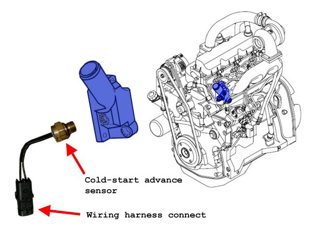

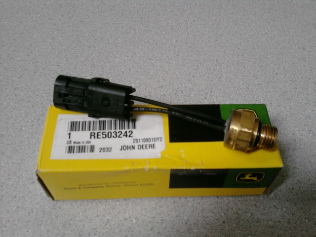

I believe the problem is the thermistor sensor (thermistors are temperature variable resistors used as sensors.). On the thermostat housing there is a sensor that is connected to a two wire harness that goes to the injection pump; this is the "cold start advance" portion of the system so it starts easier when cold by advancing the timing.
When the sensor on the thermostat housing fails it shorts out and blows the 20 amp fuse for the fuel soleniod. Try unplugging it, replace fuse and see if it starts and runs. The part # is RE503242, if you are quick changing it, you don't have to drain the coolant, just make sure it's not hot at the time. You will want a pan under the tractor to catch the coolant, so as not too have to clean it up.
To comply with the exhaust emissions regulation, the timing of injection pump should be around 6 to 9 degrees before TDC. These timing values do not allow proper start-up operations when engine is cold. To ease engine start-up, a cold advance system gives to the injection pump a temporary over-timing.
When coolant temperature is below 50 C (122 F), the solenoid valve is activated and opens the cold advance circuit.

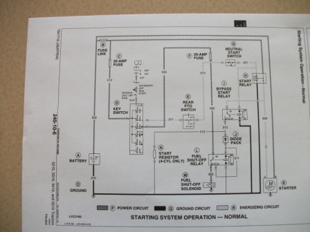

Having experienced the sensor problem myself the fuse blows as soon as the key is turned. I have attached a page of the starting system for the 5210. I believe it is the same for your 5220 assuming yours is open station. As you will see there is not much on that circuit. So it is either the key switch or the fuel shut relay. On my tractor 5210 the relay is located under the cowl to the left when seating on the tractor. I have attached a picture. If the other 2 relays have the same part number try switching them around. If you can switch them just turn the key to run no need to try and start it and see what happens. They maybe a little hard to get, so go slow. Also disconnect the negative battery cable before trying to get them out! I would not put the shut-off relay in other spot, no reason to move the problem around.
Not the best pic on the starting system PM me with your email address and I can send you a better picture if you want.
If you still have the problem from the attached diagram you have the wire number and can take a look at the key switch.

Did you test the diode pack? The diode pack does support a couple different circuit. I had an instrument light issue on my tractor and tracked it back to the diode pack. You could unplug the wire that goes from the key switch (on my tractor it is 22) to the 20 amp fuse and turn the key to start and see if anything happens.
