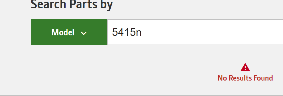

Engine oil disappeare to the radiator. From the highmark to under minimum in less than 10 min .
Where can I look for the problem ?
Engine sounds and starts fine .
/ JD 5415N #2
5415N appears to be incorrect model #

Well.....thats what the sticker on the bonnet tells me ! I am in South Africa.
You are referring to a JD? I was thinking engine oil in radiator caused by leaking engine oil cooler. PS: I knew your profile stated S Africa as your location & JD parts site is world wide.
/ JD 5415N
Green paint with JD stickers on sold by JD agents.....looks to me with a Carraro gearbox.....all green.
/ JD 5415N
#9
It is a N.....for narrow . The configeration is not in q.....problem with the engine . Please help me with that ?
