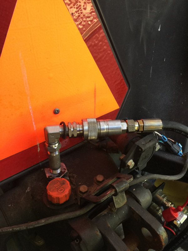

I have completed drilling and tapping the rockcase plug
If anyone has any recommendations, please feel free to comment.
Thank you all for your help.
