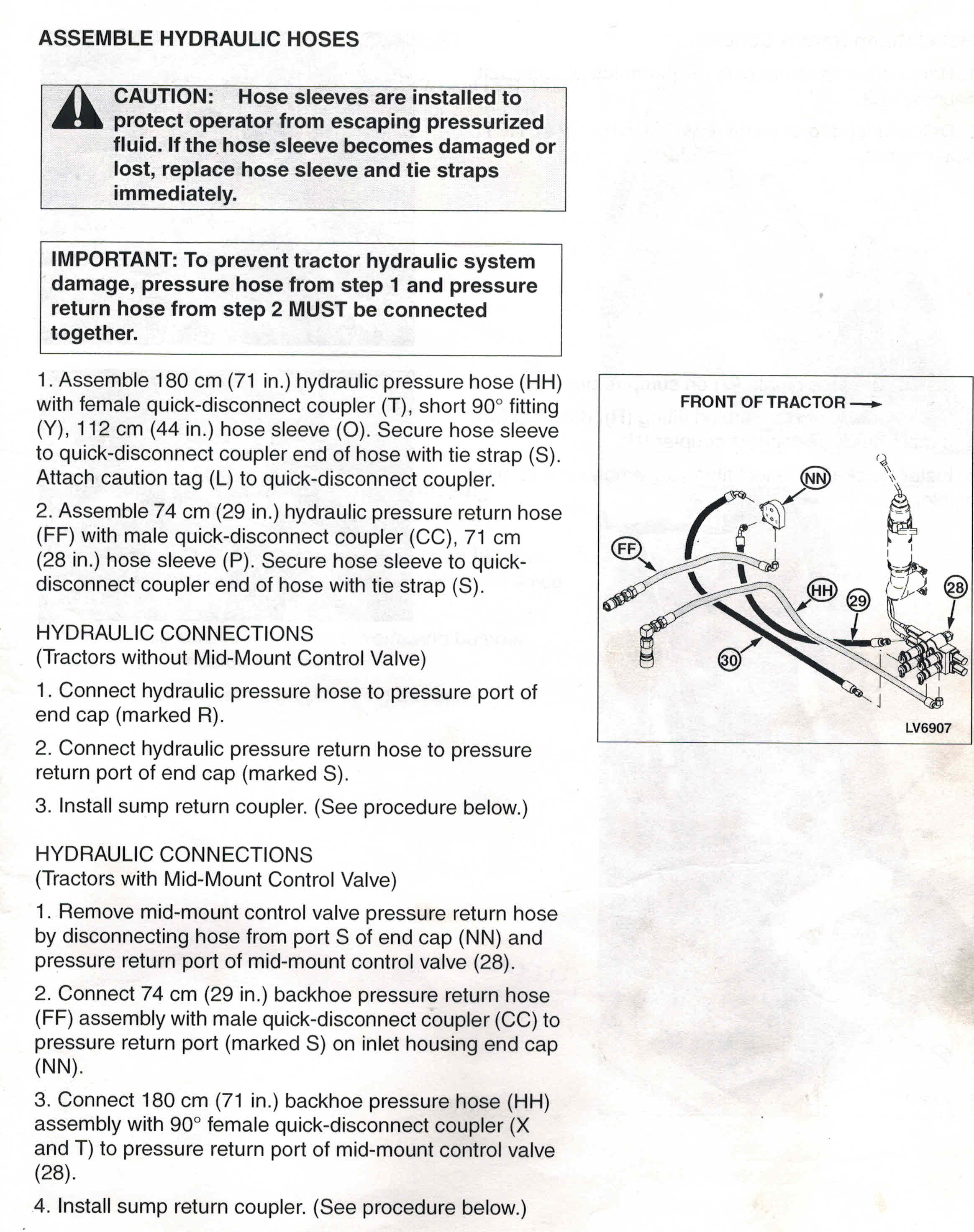

My 48 backhoe is set up to have just two hoses connected to the tractor but I notice in the Installation Instructions there is a mention of three hoses.
1. Backhoe Sump Return Hose
2. Tractor Pressure Hose
3. Backhoe Pressure Return Hose.
On my set-up there is no Number 3.

I have re-checked and can now confirm that there are 3 hoses on my backhoe. The 3 couplers on those hoses are:
Pioneer Female Coupler 4050-15 3/4-16 ORB
Pioneer Male Hydraulic Coupler 8010-15 3/4-16 ORB
Faster HNV 38 12 SAE EFJ 06NO with "Made in Italy" (I am guessing this is metric as the male Pioneer coupler will not even fit into it.)
In attempting to understand how these 3 hoses connect and function? I want to Thank Quebecguy for his help.

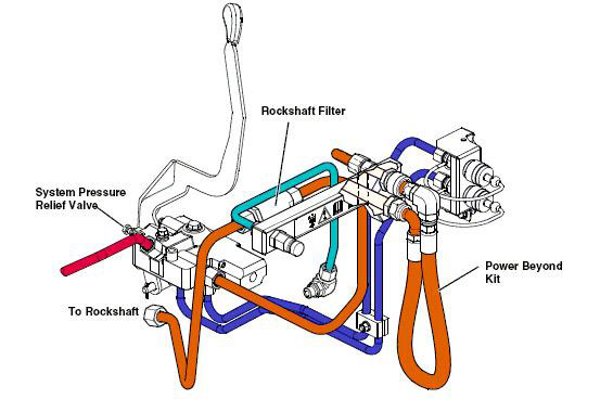

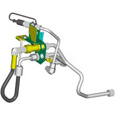

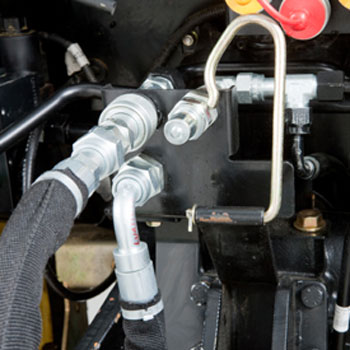

I've searched for pictures of a Power Beyond installed - the pictures I have found seem to indicate that the Power Beyond when it is not connected to the backhoe is in a loop back into the hydraulic system (can someone confirm if I am right):
I found a different picture that seems to confirm:
And then I found an explanation and picture
The PB (orange) is plumbed into the DSCV block which is located behind the joystick. The lines run to the top back where a bracket mounts above the 3 point. And a return line (teal) runs to the side of the hydraulic fluid fill. The dark blue is the 3rd function.

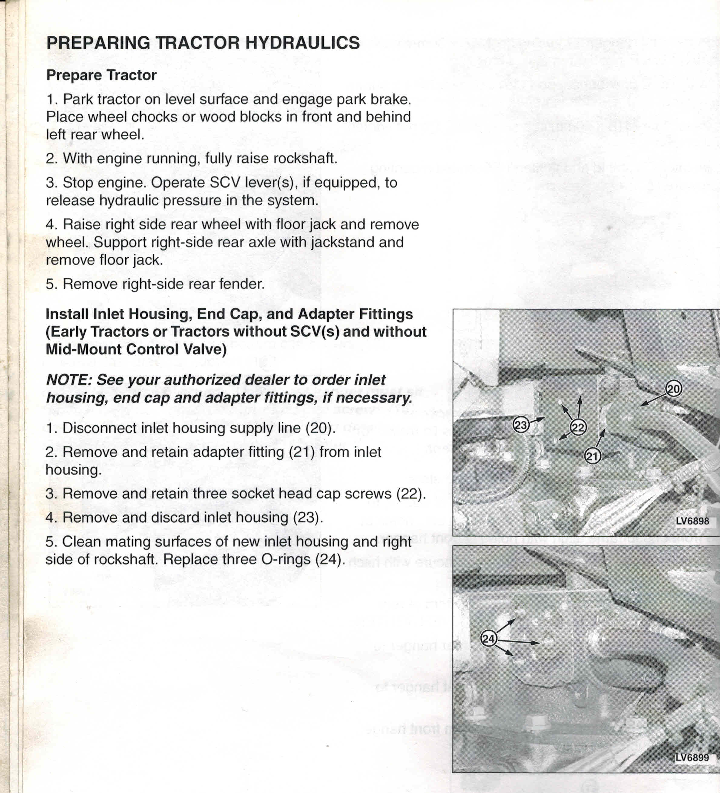

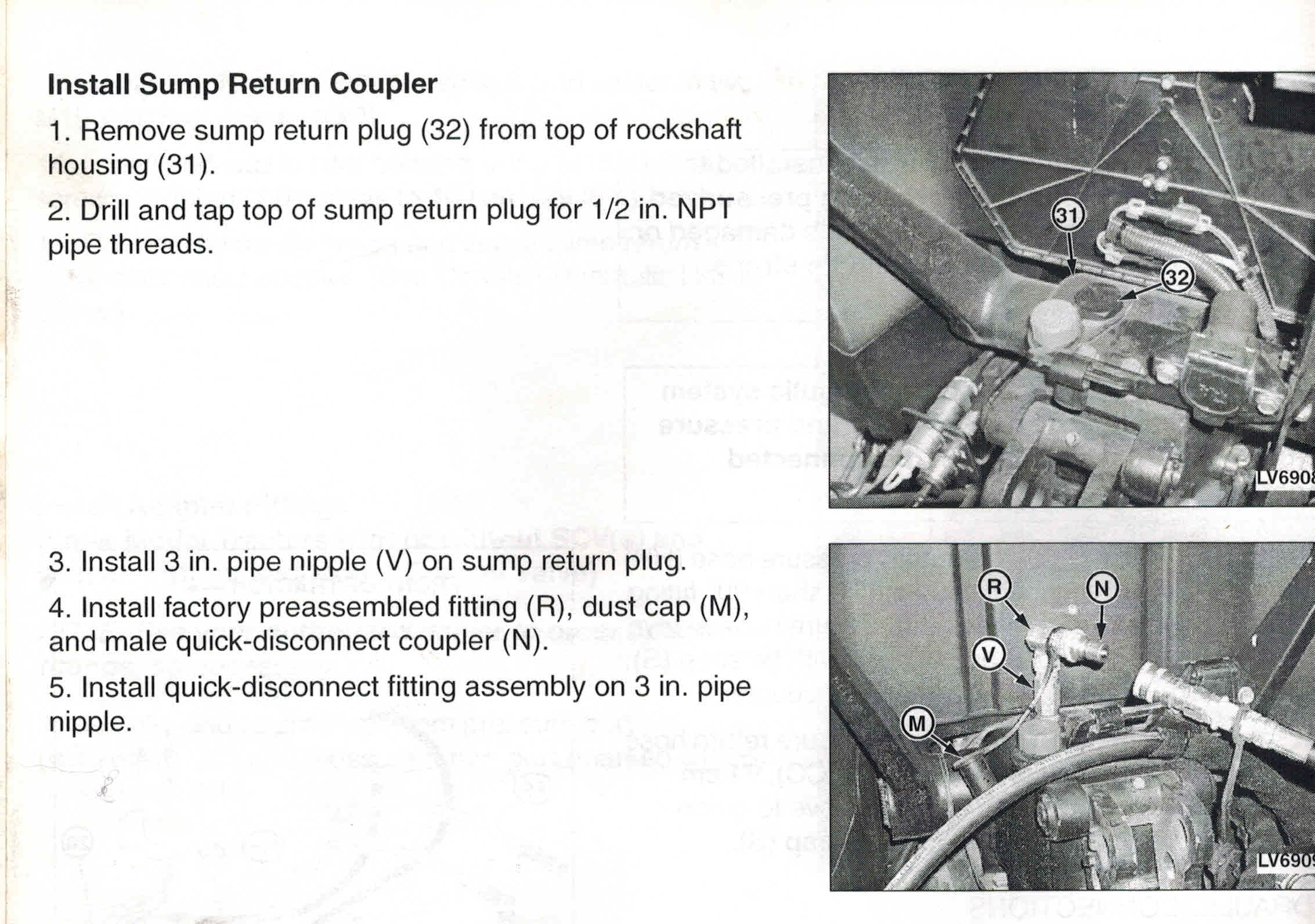

Since the Power Beyond Kit is not available - I wonder if the individual parts might be? Comments?
Can anyone make a recommendation of finding the kit RE73308 or sourcing the individual parts?
