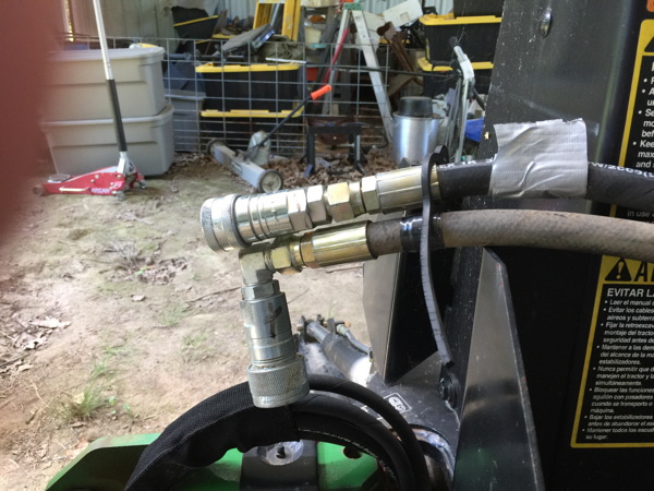

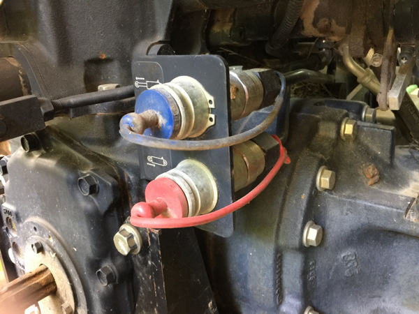

It sounds like the same setup - there are 2 hydraulic hoses with female connectors on the 48 and there are 2 female hydraulic connectors on the 5205. The 2 connectors on the 5205 have a control lever that I identify as the draft control (?). I assumed that the 2 female connectors on the 5205 are a supply and a return (those little icons sure helped:). It makes sense that a third supply port would be able to supply power to the 48.
02 JD Backhoe Hydraulic Connectors.jpg 01 JD 5205 Hydraulic Rear Connectors.jpg

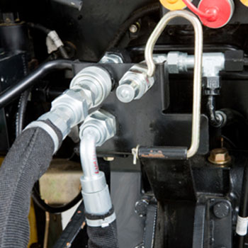

The 5205 FEL is factory installed and I am assuming the joystick is OEM. There are 4 hydraulic connectors at the mid-point of the 5205
04 JD 5205 Hydraulic Distribution 03.jpg 05 JD 5205 Hydraulic Distribution Close.jpg
However, I do not know and certainly do not understand the plumbing necessities or the part requirements. My greatest concern is that there may be some pressure relief necessities built into the Power Beyond that will save me burning up a hydraulic pump that I am unaware of. I just can't believe that adding a supply connection is as simple as splicing into an existing hydraulic line.

Looks like you have the mid mount joystick plus a single SCV, often referred to as a single set of rear remotes. Agree with JD5210 on explanation of levers.
Can you get a look at item number 24 on from the following diagram on your tractor?
John Deere Parts Catalog
It appears to have 2 or 3 plugs threaded into it. If it was in my shop I'd pull that plate off and see how the oil flows through it. It likely has provisions to divert oil out to your backhoe but may require inserting a plug internally. It may or may not be covered in the tractor tech manual.

1) Connect the loader to the quick connects next to the PTO shaft at the back of the tractor in your second pic (blue and red caps) then use a bungee cord to hold the control lever when using the backhoe.

What are those 2 hoses in the first picture? The one with the duck tape. I would say to the right of the seat you have 3 levers. 1. Raises and lowers the 3 PT. 2. Draft control. 3. For the third SCV.
I own the Operators Manual and I will buy the Tech Manual in a few minutes.
The backhoe operator faces 2 levers used to control the dipper stick and the bucket with additional 2 levers for controlling each stabilizer leg
The 2 hoses in the first picture are attached to the backhoe. However, I need to check and re-check if my backhoe has 2 or 3 hydraulic lines - as I was re-reading the posts I started to wonder if I had correctly stated that there were only 2 hoses - I keep thinking there are 3 hoses - I'll need to check. The duck tape was on the 48 when I bought it - maybe some identifier for supply and return - just guessing.

I need to check and re-check if my backhoe has 2 or 3 hydraulic lines - as I was re-reading the posts I started to wonder if I had correctly stated that there were only 2 hoses - I keep thinking there are 3 hoses.
My 48 backhoe is set up to have just two hoses connected to the tractor but I notice in the Installation Instructions there is a mention of three hoses.
1. Backhoe Sump Return Hose
2. Tractor Pressure Hose
3. Backhoe Pressure Return Hose.
On my set-up there is no Number 3.

I have re-checked and can now confirm that there are 3 hoses on my backhoe. The 3 couplers on those hoses are:
Pioneer Female Coupler 4050-15 3/4-16 ORB
Pioneer Male Hydraulic Coupler 8010-15 3/4-16 ORB
Faster HNV 38 12 SAE EFJ 06NO with "Made in Italy" (I am guessing this is metric as the male Pioneer coupler will not even fit into it.)

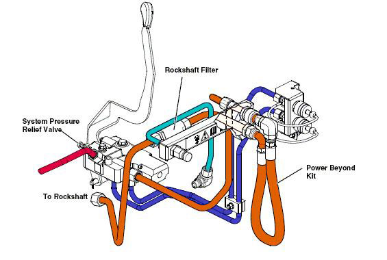

I've searched for pictures of a Power Beyond installed - the pictures I have found seem to indicate that the Power Beyond when it is not connected to the backhoe is in a loop back into the hydraulic system (can someone confirm if I am right):

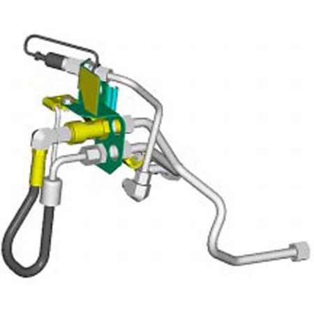

I found a different picture that seems to confirm:
And then I found an explanation and picture
The PB (orange) is plumbed into the DSCV block which is located behind the joystick. The lines run to the top back where a bracket mounts above the 3 point. And a return line (teal) runs to the side of the hydraulic fluid fill. The dark blue is the 3rd function.
Since the Power Beyond Kit is not available - I wonder if the individual parts might be? Comments?
Can anyone make a recommendation of finding the kit RE73308 or sourcing the individual parts?
