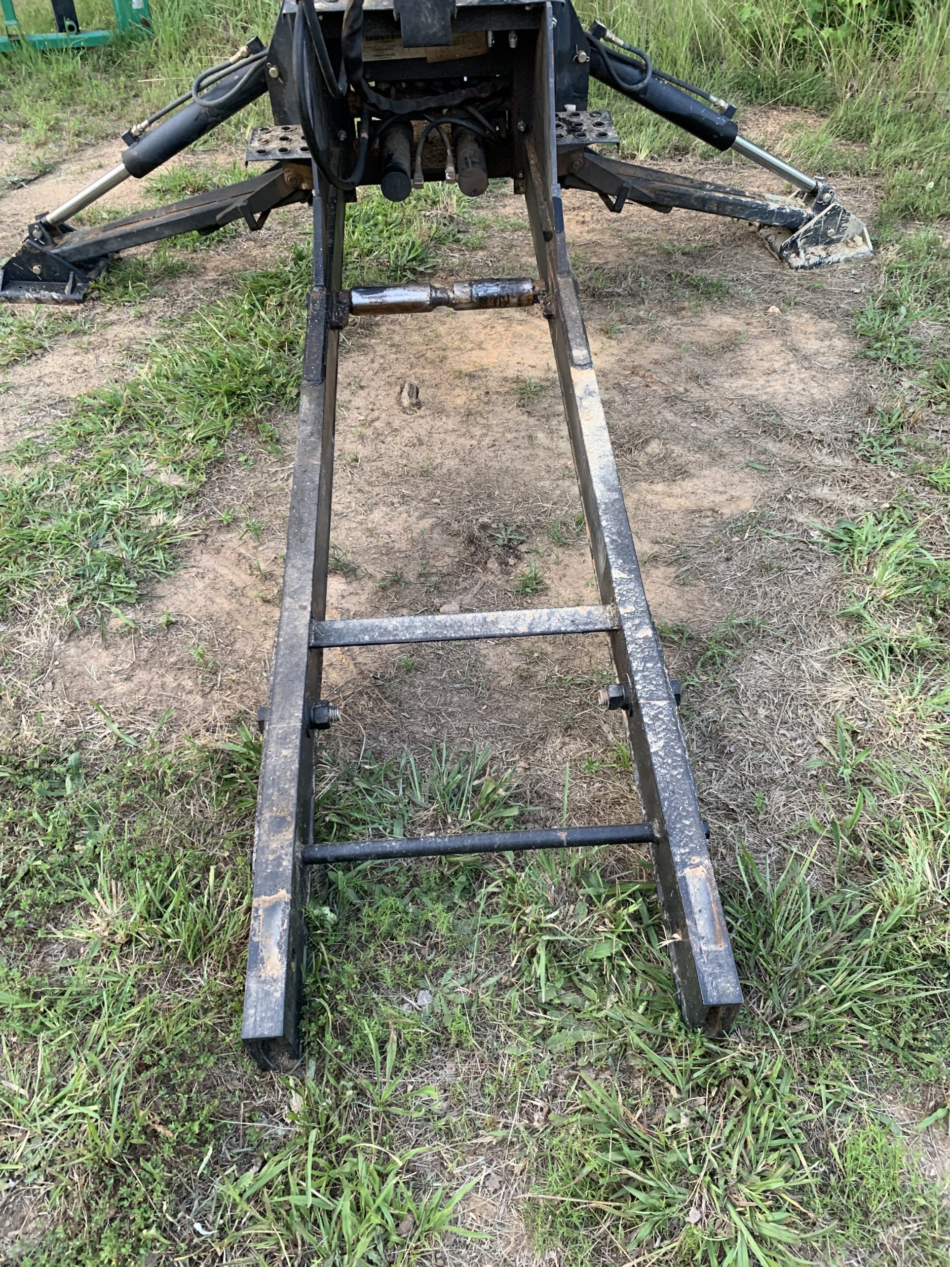

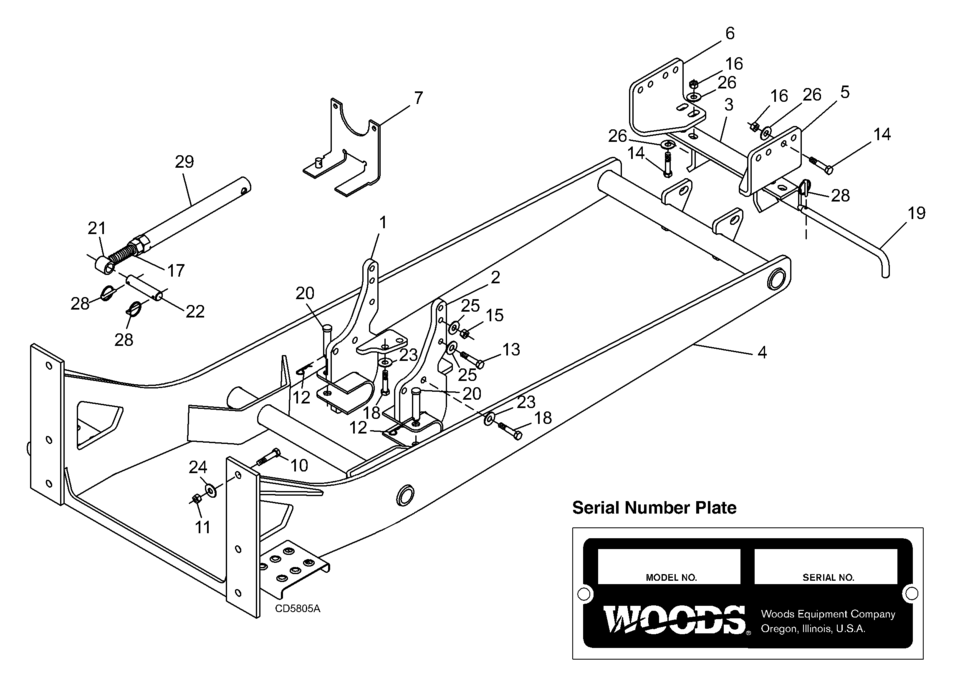

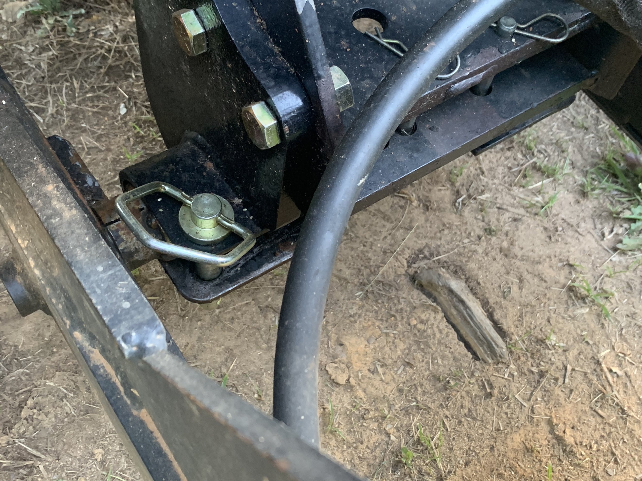

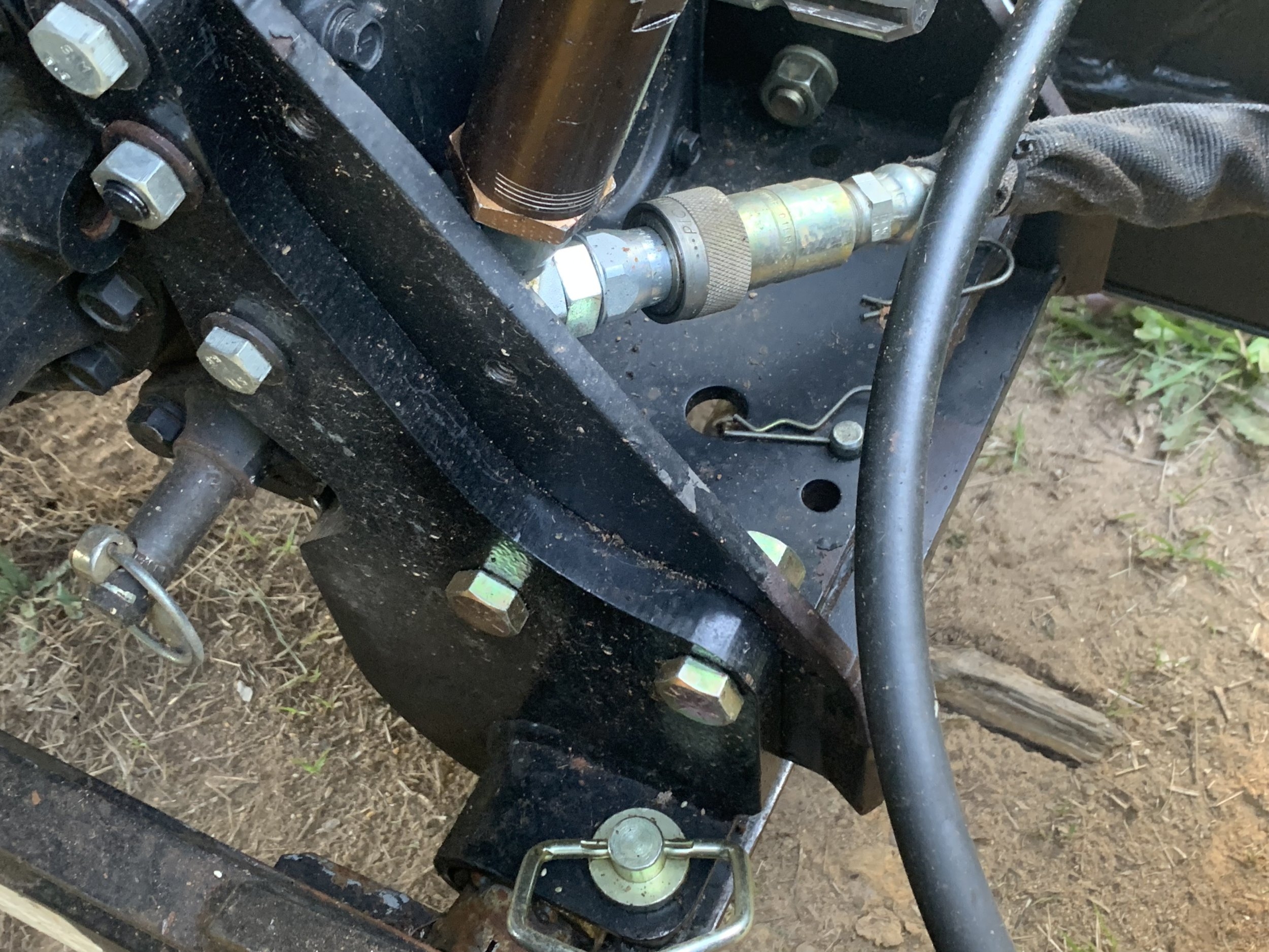

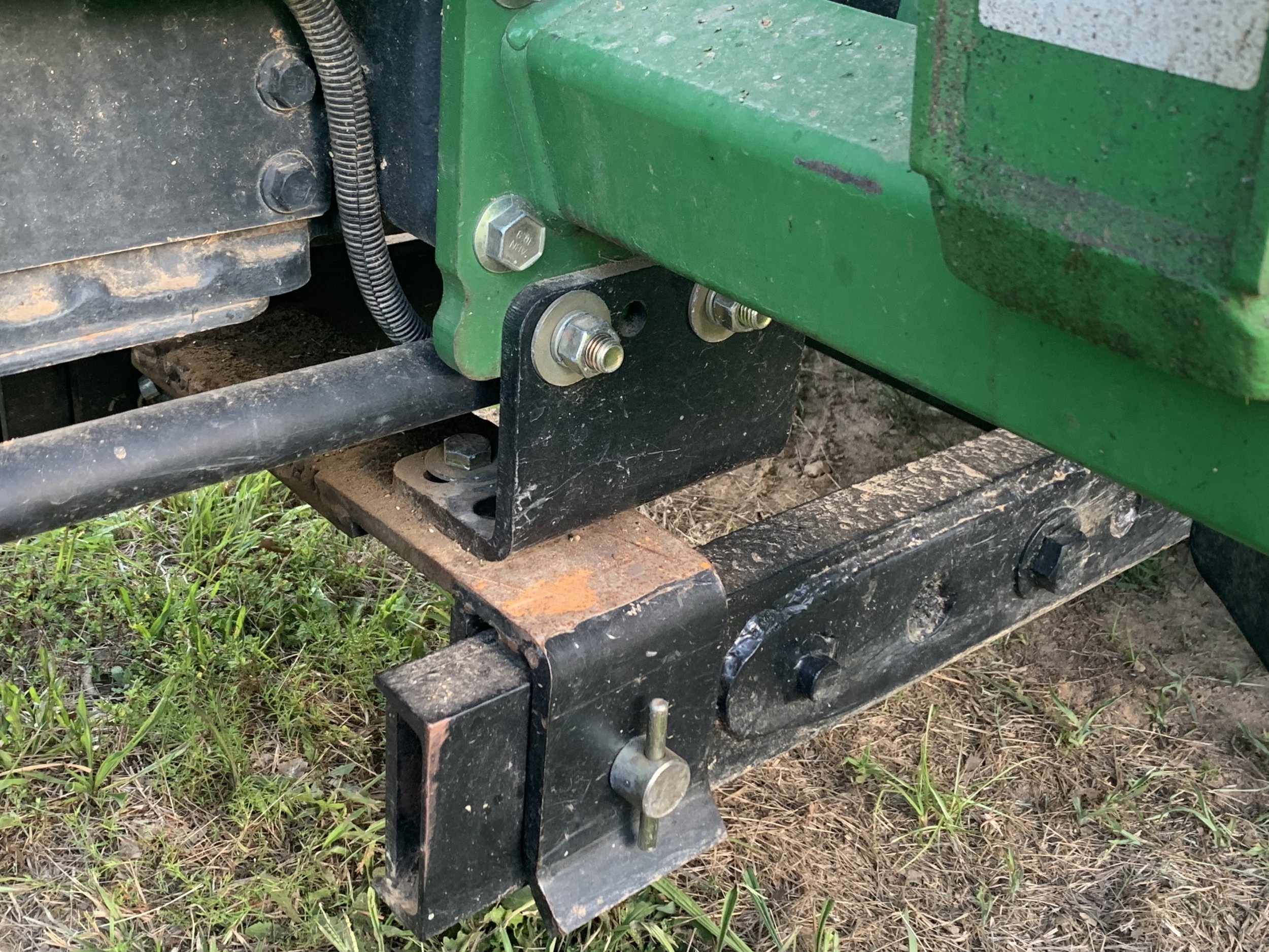

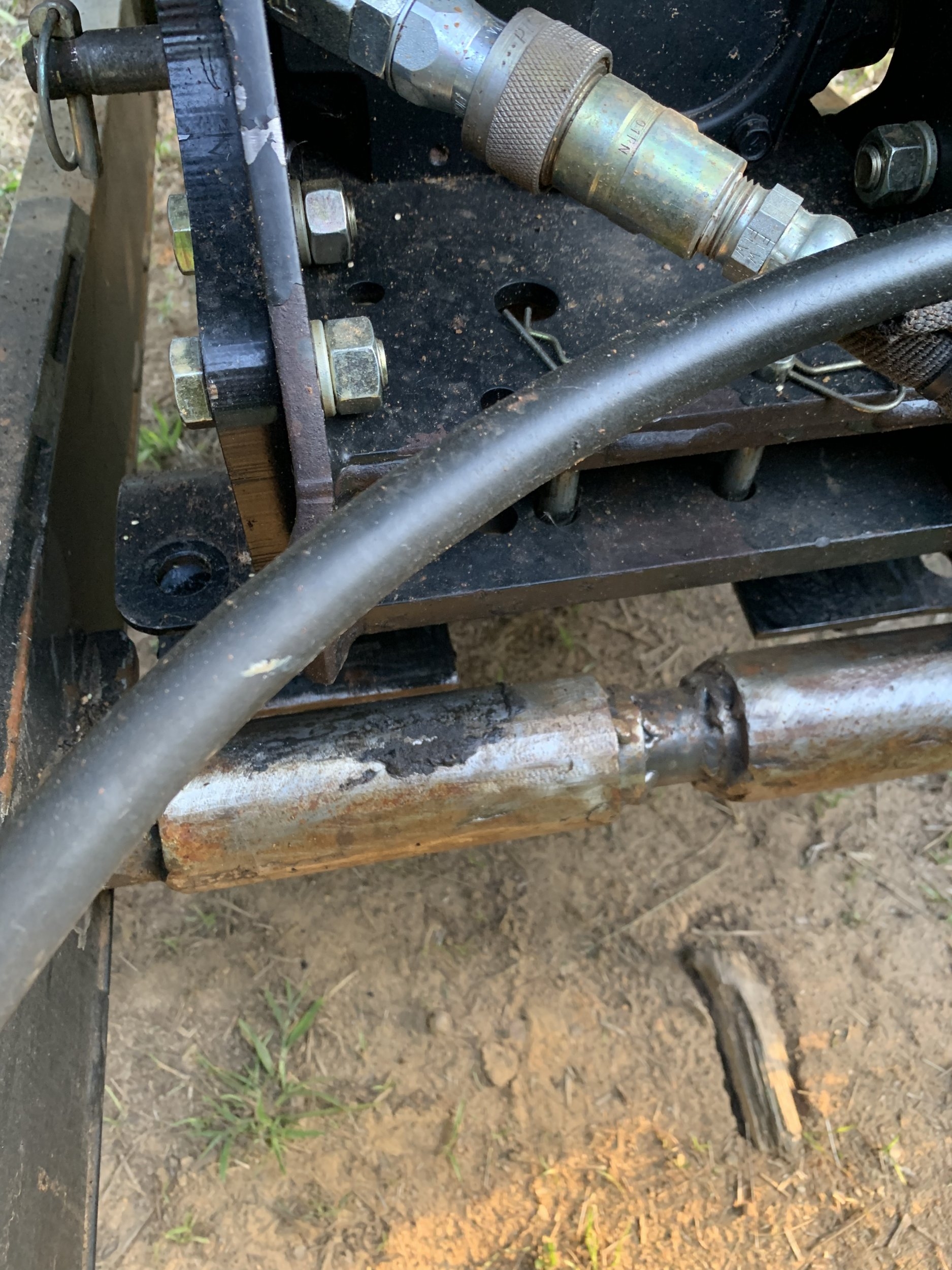

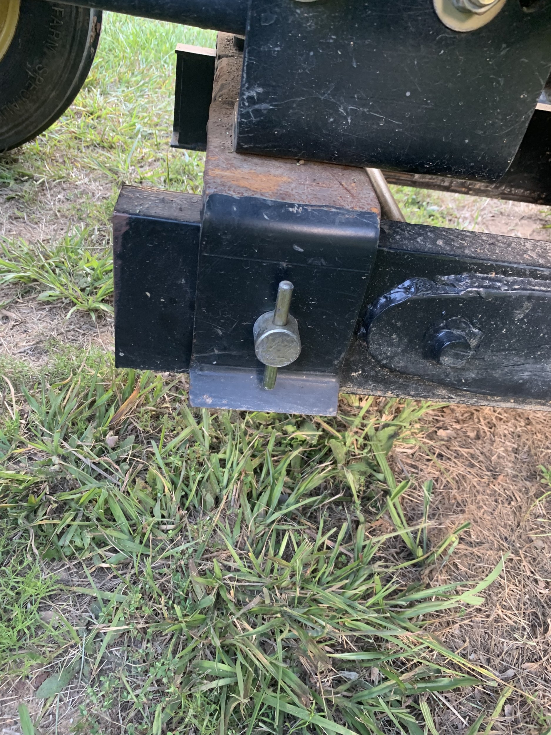

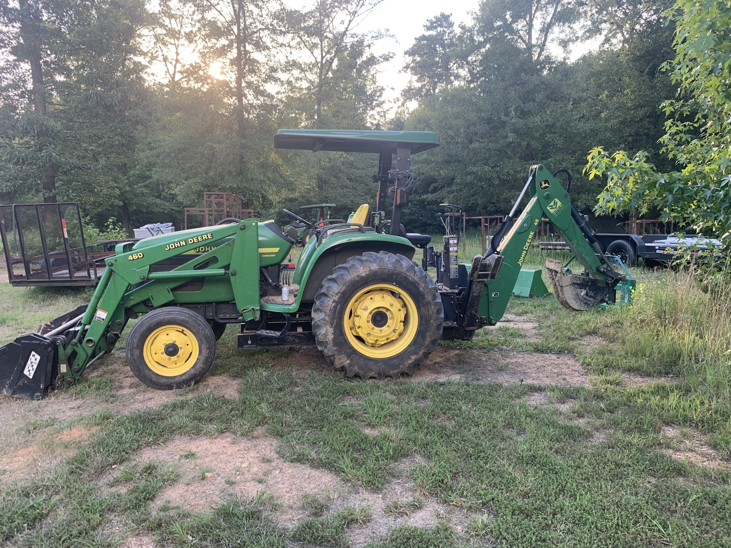

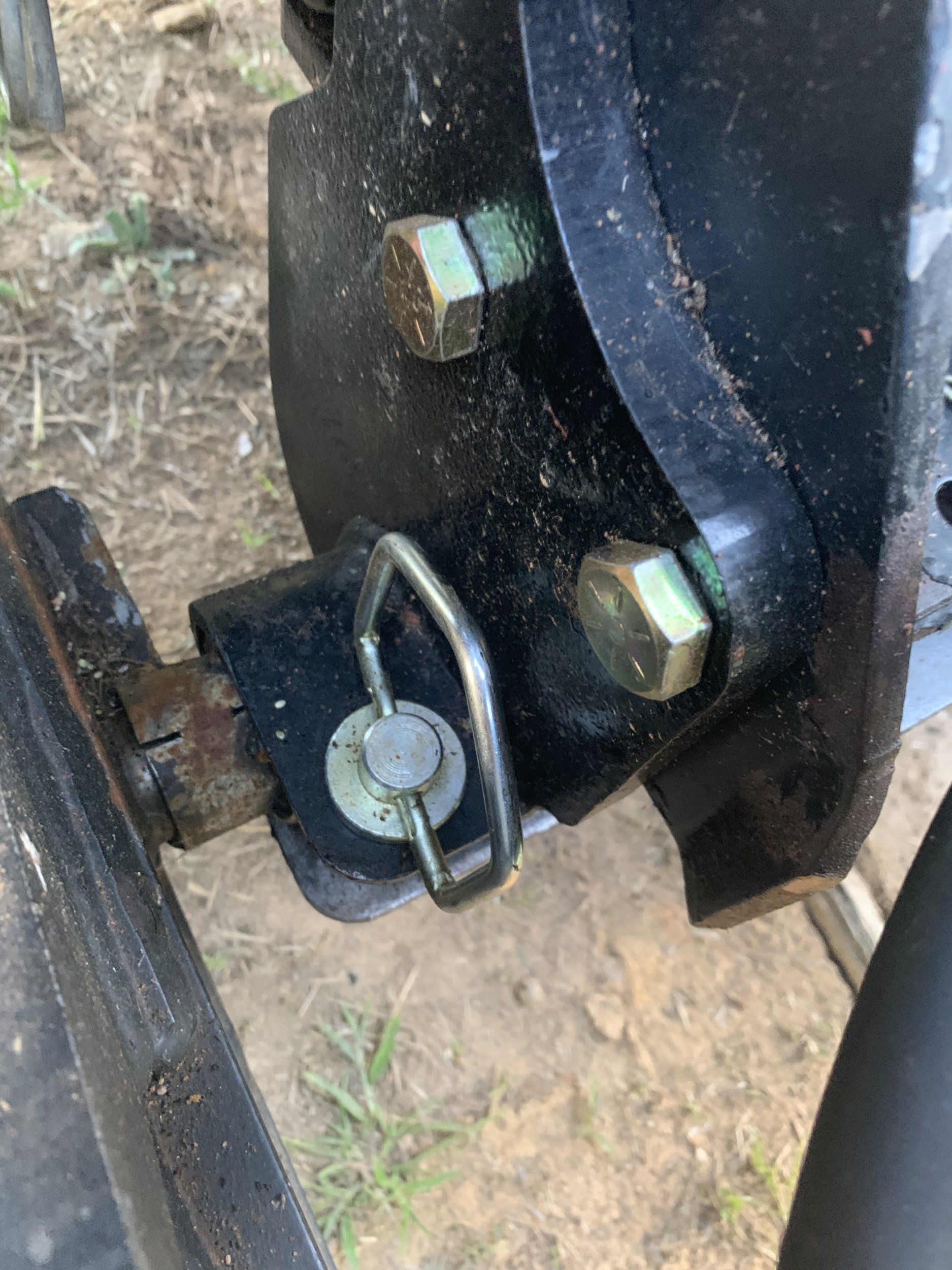

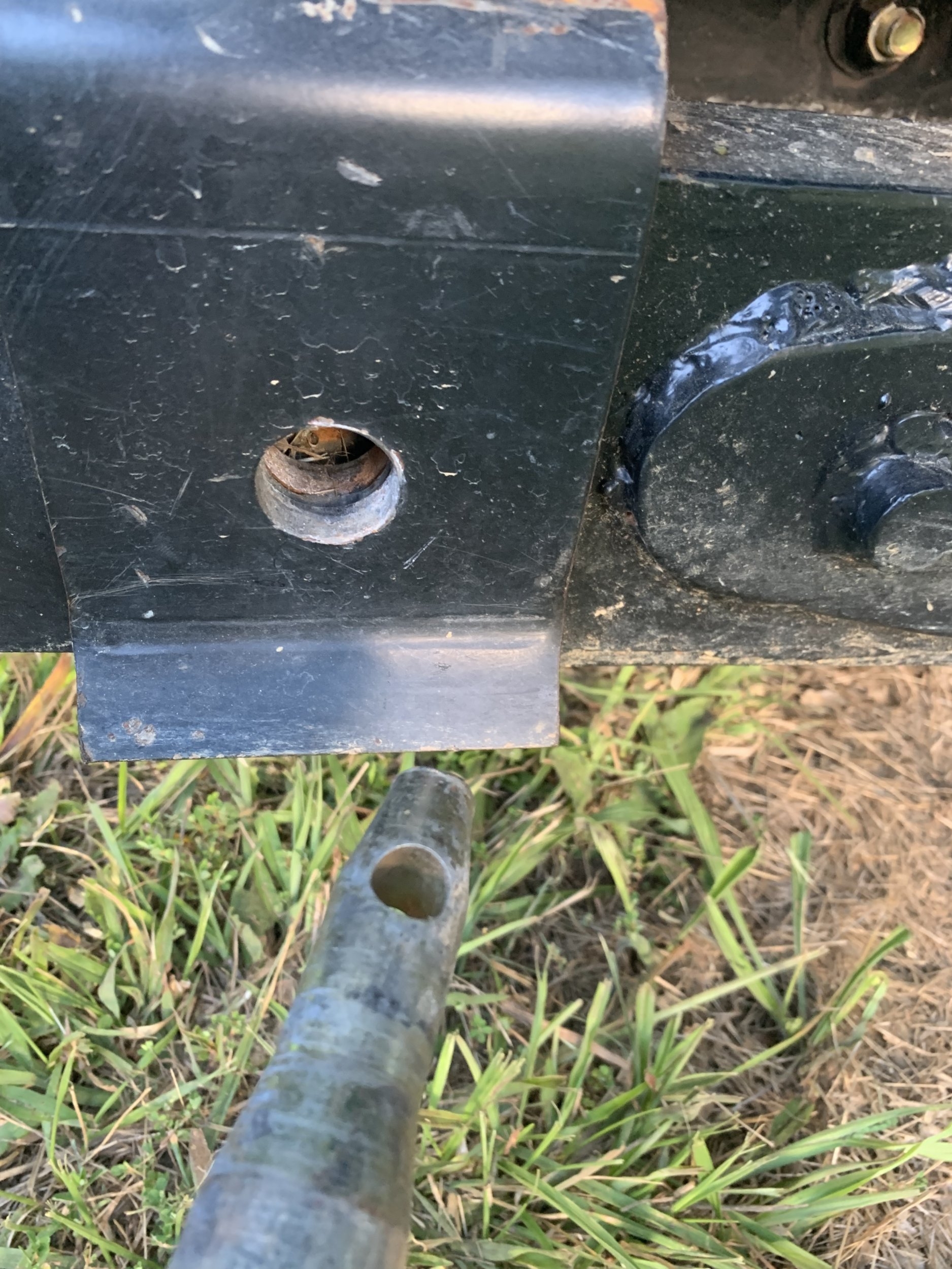

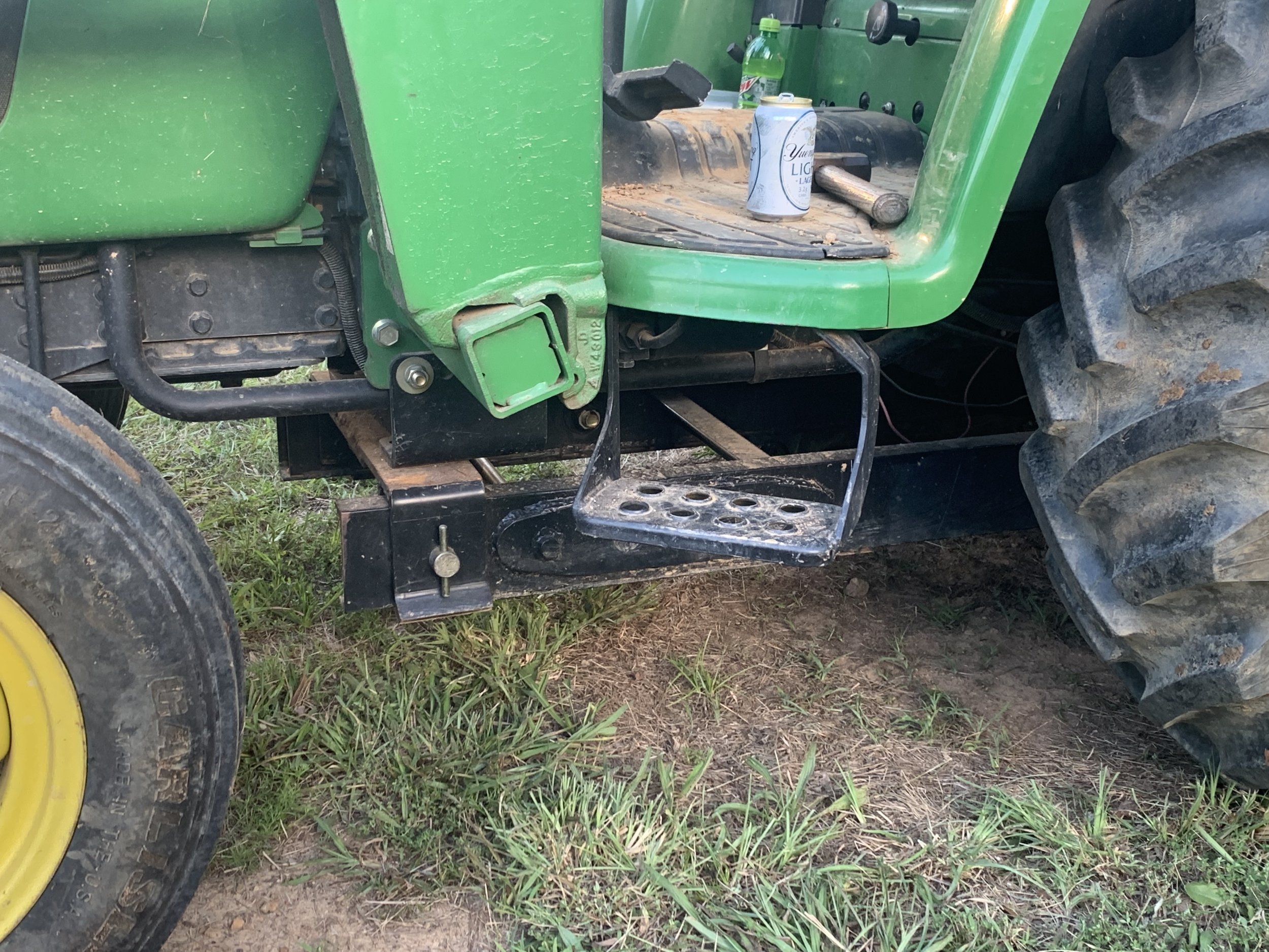

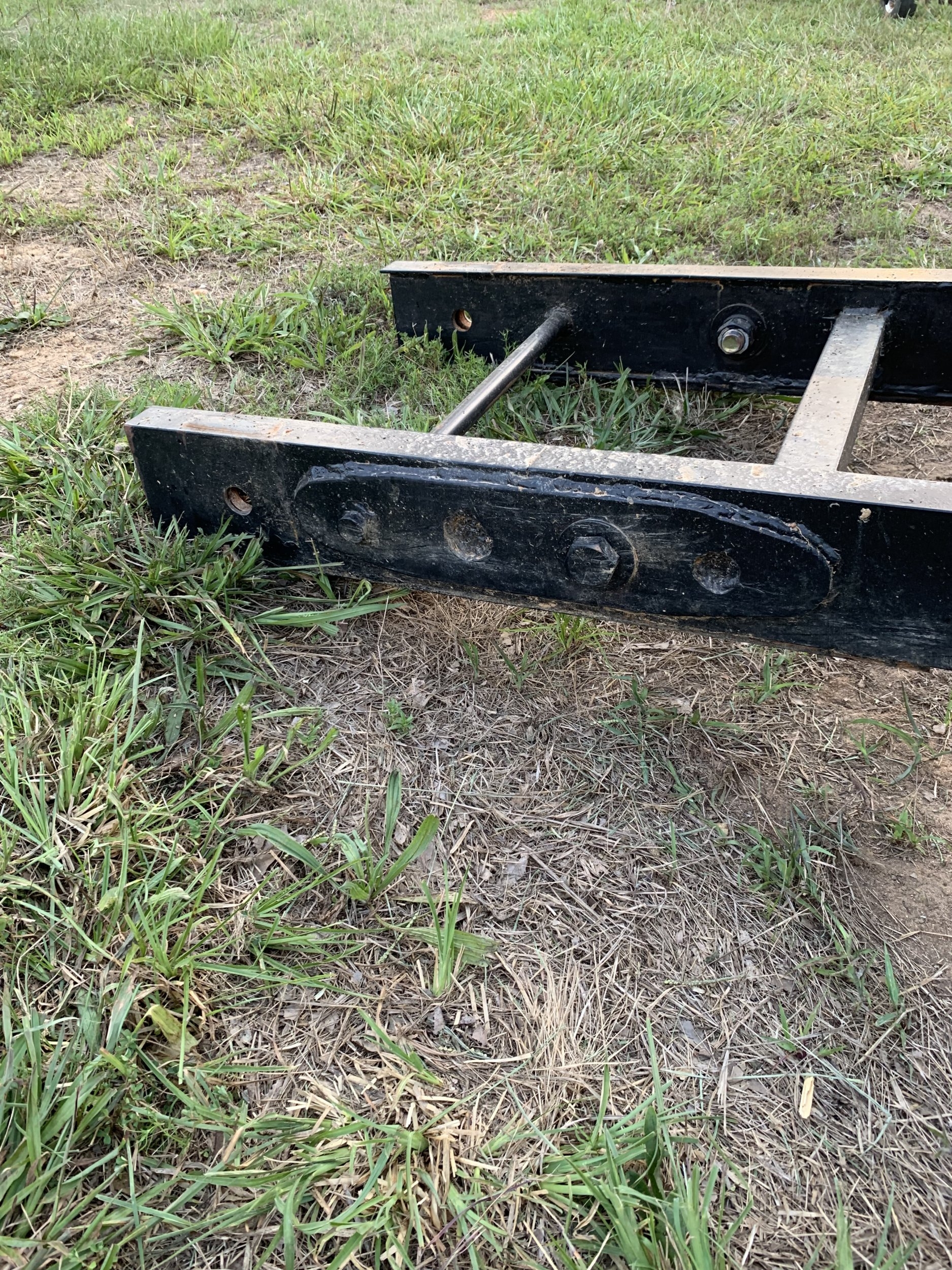

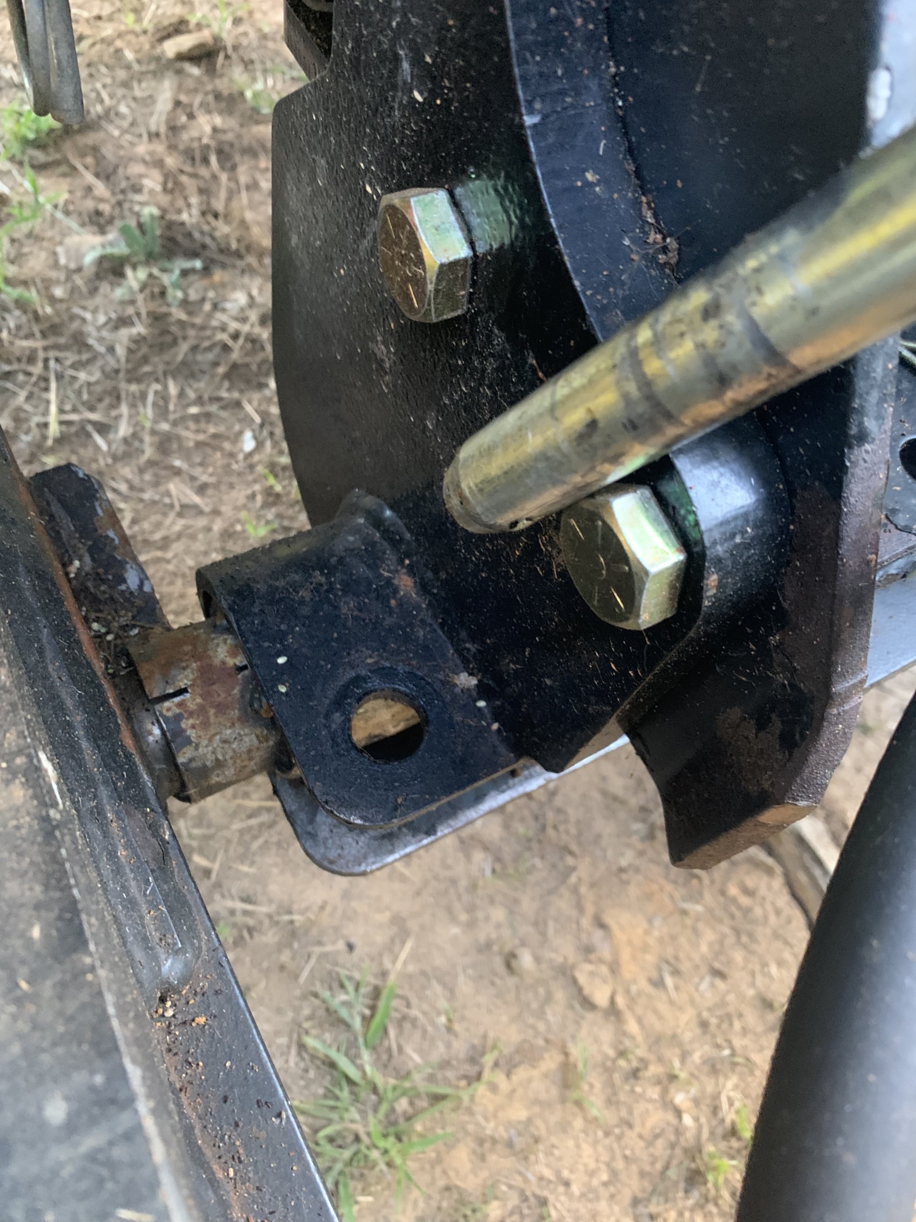

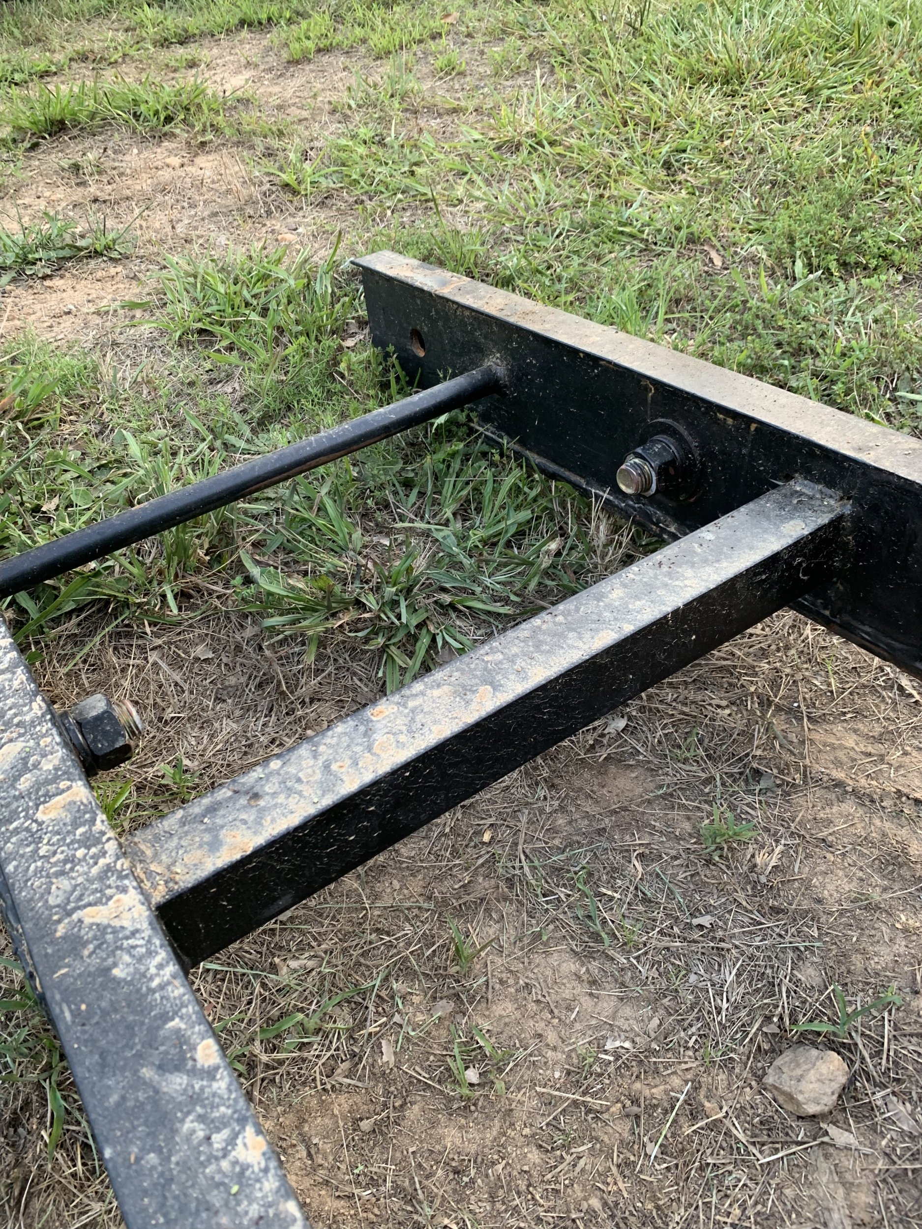

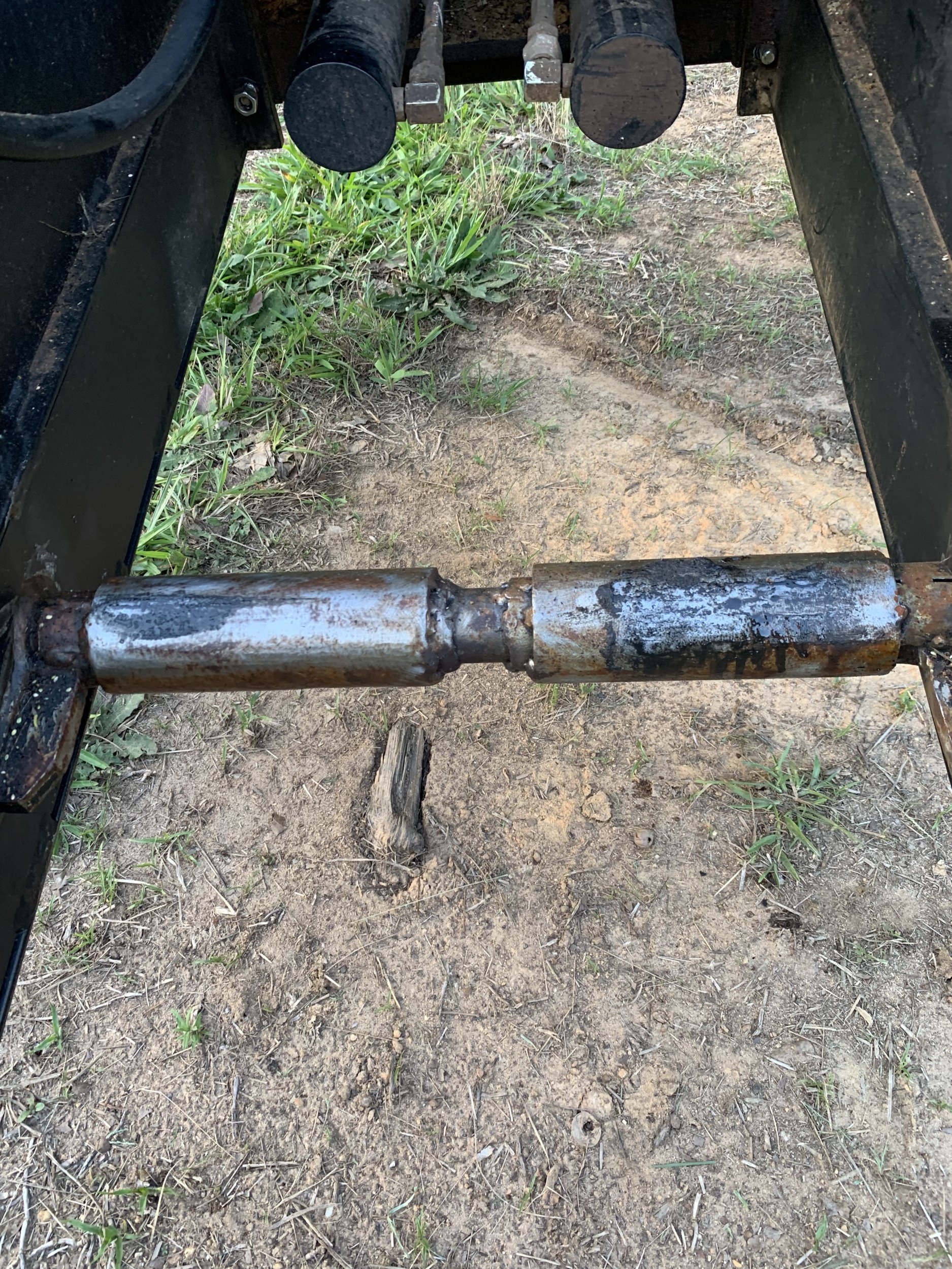

I purchased a 48BH for my JD 4500. It had the subframe with it that connects under loader brackets of a JD 5205. I could not located the correct mounting brackets either.
I decided to use the subframe because it was a better way to mount. A Woods 9000 has a similar subframe. I purchased the mounting brackets for the Woods subframe then I had to modify the JD subframe some.
The rear mount on the JD is a smaller diameter rod than the Woods. Instead of replacing the rod I found some DOM tubing with correct id/od and cut it lengthwise wrapped it over existing rod and welded it back together.
It came with the front mount for the JD 5205 but I had to cut part of it off to bolt it to the Woods mounts.
Now the frame was to short. The JD subframe is c channel that is boxed almost end. I extended the subframe using same size c channel. I extended the boxing on the inside and used oversized fish plated on the outside.
I can take it on or off in 15 minutes. Tractor is very stable/solid feeling while using backhoe. The mount does take up alot of ground clearance but it has not been a problem yet. I will get some pics today.

Pic of the Woods and JD frames.

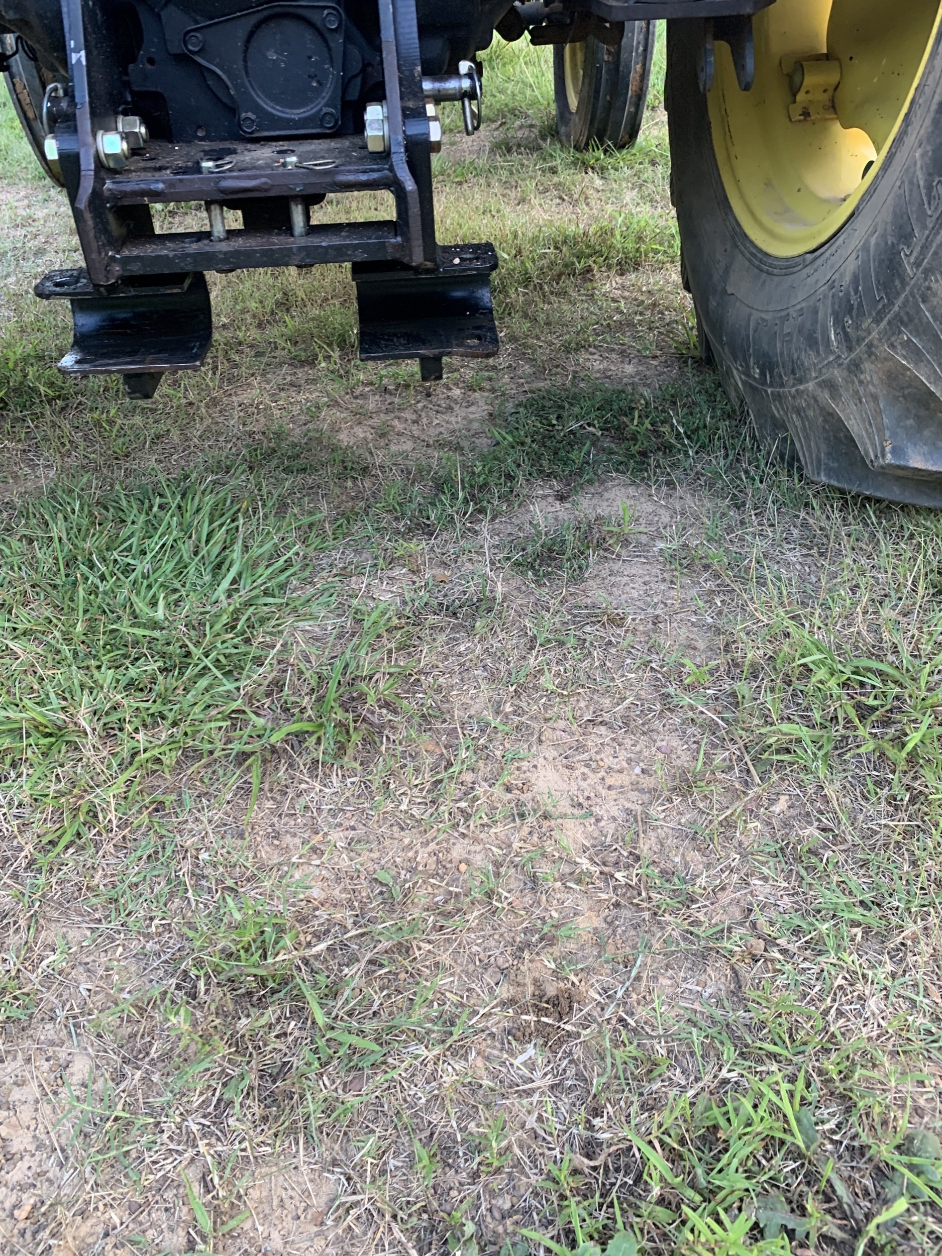

Sorry for the delay on pics. I had/ have a kidney stone. I took the backhoe off today and got some pics

more pics
