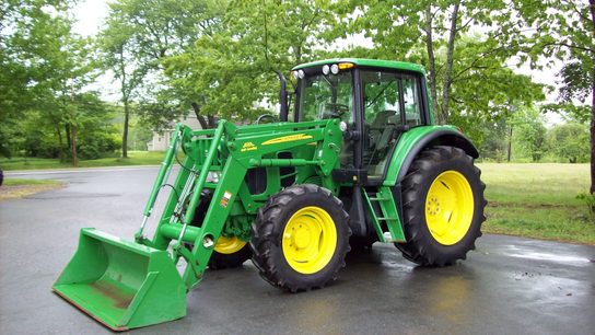

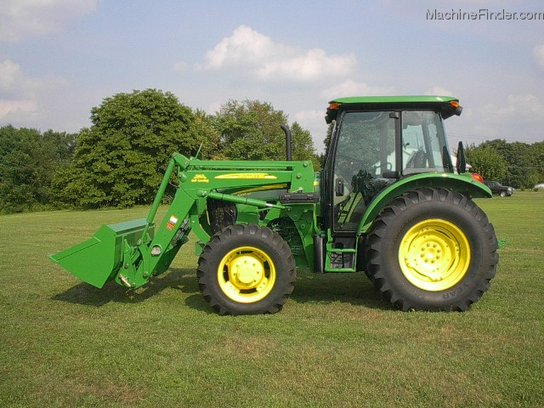

I´ve been a member of this forum for a while now reading and researching John Deere tractors in the 75-100 hp range. A little background first. My father and I have 45 head of cattle and bale around 350 round bales of hay per year in east central Kansas. We have our JD 535 baler paired with a 1992-75hp JD 2755. Currently we cut the hay with a JD 260 disk mower paired with a 1975-84hp Ford 7000. This tractor has been rock solid through the years but we've decided to update this fall.
We have narrowed our decision to either a new 5105M or a slightly used (<500 hours) 6330. The 5105M is 90hp at the PTO and the 6330 is 85hp. Both tractors are priced in the upper $50´s.
I visited the four-state farm show a couple weeks ago in Pittsburg, KS and was able to see a 5095M next to a 6330. Both tractors would be fitted with SL-loaders, MFWD, and cabs. Both have the power reverser and several options for transmissions. We have no intentions of working ground; these will be used strictly for baling hay and feeding hay during the winter.
In talking to the Deere dealers, they're trying to persuade me into a 6-series in the possibility that we expand our operation in the future. I'm leaning towards the 5-series because it will satisfy the needs I have. We not looking to expand, as we both have full-time jobs besides our small ranching operation. I've heard it said that the 5M Series is basically a 6-series tractor in a 5-series body. I like the idea of a smaller size with the same amount of power.
I'm looking for suggestions. Which of the two tractors listed above would you choose and why? Thanks for your time.

what is the price difference between the two? if the 6330 cost less you will get more for your money. just my Opinion.

Reviewing prices on machinefinder and tractorhouse, a new 5105M is around $58K. A like-new 6330 can be had for right around $62k. More for your money, what will the 6-series do that the 5-series won't do on a small ranching operation? I understand the difference if I was engaging ground work. Thanks.

I have a '96 85 hp 6400 that's been a great tractor. I've never driven a 5100 series tractor but looking at them side by side the 6000 series looks much more substantial. I also pull a JD 535 baler and I think the 6000 series will handle the weight of the baler better.
/ JD 5105M vs. JD 6330 #7
The 6330 has more hydraulic flow capacity, class II/III hitch, longer wheelbase by about 8-9 inches, more weight about 1,500lbs. A slightly larger tractor overall which when handling bales in the winter of the same size will have a slight edge over the 5105M.
I would prefer the 6330 over the 5105M, while both will handle the bales and haying operation why limit your ground engaging capabilities? Better to be prepared since who knows what the future may bring.

Either tractor will suit your needs. All things being equal I would go 6330

The longer heavier tractor will ride better on a rough field.
The lighter tractor will tread lighter and won't leave as bad of ruts in wet conditions.
If the price were the same, I'd vote 6330.

Everyone is voting bigger is better. I don't. By the 5105M. It is big enough, has a long enough wheelbase, and is heavy enough to do everything you are doing and more. The bigger tractor is going to use more fuel, which is going to be getting a lot more expensive. Save that money for fuel, feed, repairs, fencing, dinner, another cow... There is always something to buy.

They both have the same size engine so power should be about the same. A large round baler like a 535 is a heavy load and the heavier tractor would handle it better.

I would just like to address some of the points that have been discussed. Same motor, so that's not an issue. Hydraulic flow: the 5M series is actually higher. Interior noise level: 6330 is 71db, 5105 is 80. Not much difference there. I can talk on my cell phone and nobody believes that I'm working the tractor. The 6 series is a little bit longer and a little heavier, if that matters to you. (for me, I PREFER the shorter tractor for stacking hay in the barn) As far as the ride comfort, if you get the radial tires on the 5M, I'll bet you won't miss the weight or wheelbase of the 6. As for fuel usage, the 5M series has the option of a 540/540E pto selector. For pto powered equipment that doesn't require as much hp, the 540E position develops 540rpm pto speed at only 1700rpm engine speed. Now, that will save fuel. (all of the above quoted specs are straight from Deere's website) Another thing to consider is that the 6330 would be "as is." You have to take it as it comes. If you buy a new 5M, YOU get to pick the options. Also, financing on the new tractor is 0% through Oct 29th. How much interest will you pay on the 6330?
I recently bought a 5085M (Cab) to replace a NH7610S open station tractor. Both are MFWD with loader. I cut hay on 60 acres with a JD 265 mower and bale with a JD 457 round baler. I didn't even consider the 6 series tractors becuase of their size. (that's why I sold the 7610S - it was too big for many tasks)
