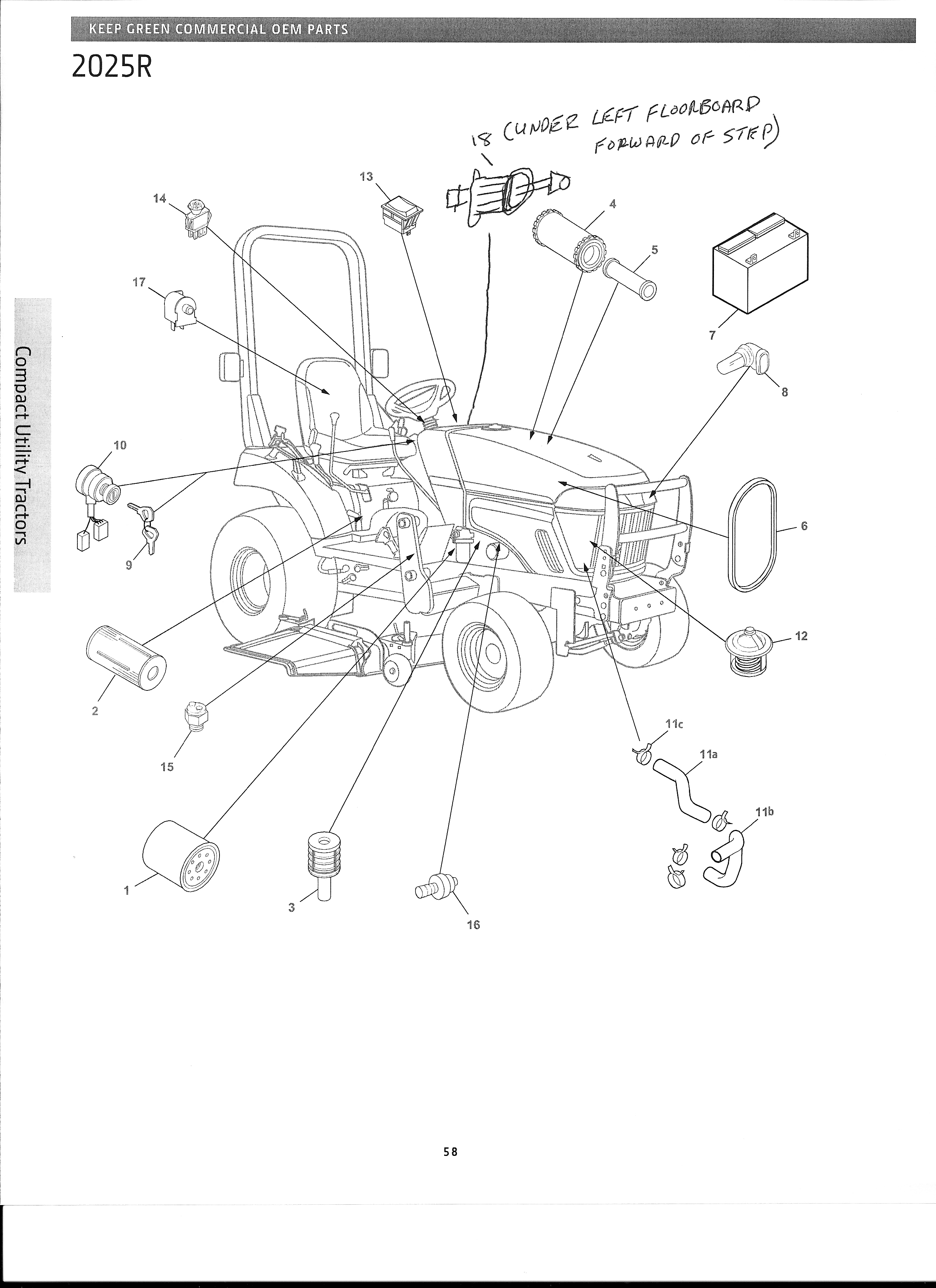

They did the same thing with the 2025R Gen2. It is tucked up under the left floorboard. Not listed in the Parts Guide or the Service schedule. Dealer unaware of it. It is mentioned in the Operator's Manual on how to replace it but you have to really hunt for it.:mur:

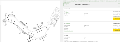

Thanks gejandsons, and that part # of that filter would be helpful to others for future reference.
/ JD 5105 filter location hidden #6
John Deere In-line Fuel Strainer - RE220719, but you could replace it with an aftermarket 3/8's barbed in line diesel filter like a Wix 33270..
It is item #29 here on JD Parts. Picture is confusing because the filter is between firewall and the back of the engine.
John Deere Parts Catalog

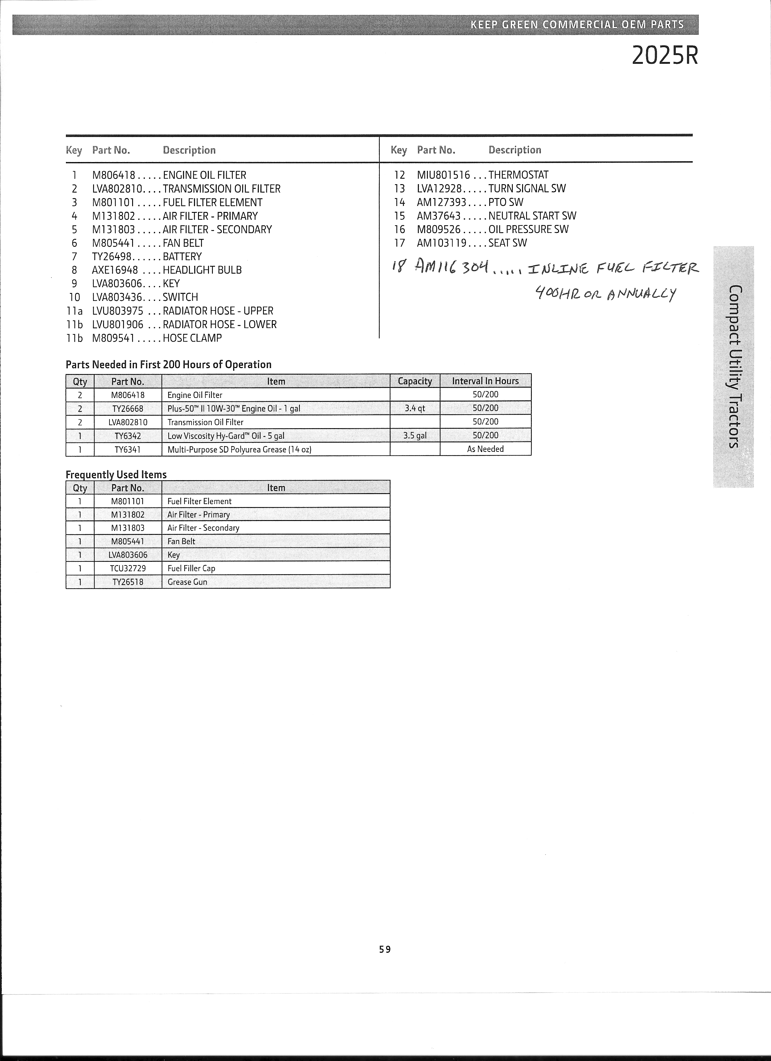

Isn't filter(key 2) shown in JD parts the one you replaced?
That's the one but the dealer's service documents didn't show it and they did not replace it when they did the 50 hour service. I pointed it out and got the deer in headlights look. I doubt they will come out and change it for free and due to surgery, I can't do it right now. I'm thinking of just putting a piece of copper tubing in it's place. I never had that filter on my 2305 for 14 years and had no problems. I don't use off road diesel. These are the pages the dealer gave me and I added the filter and part number.
