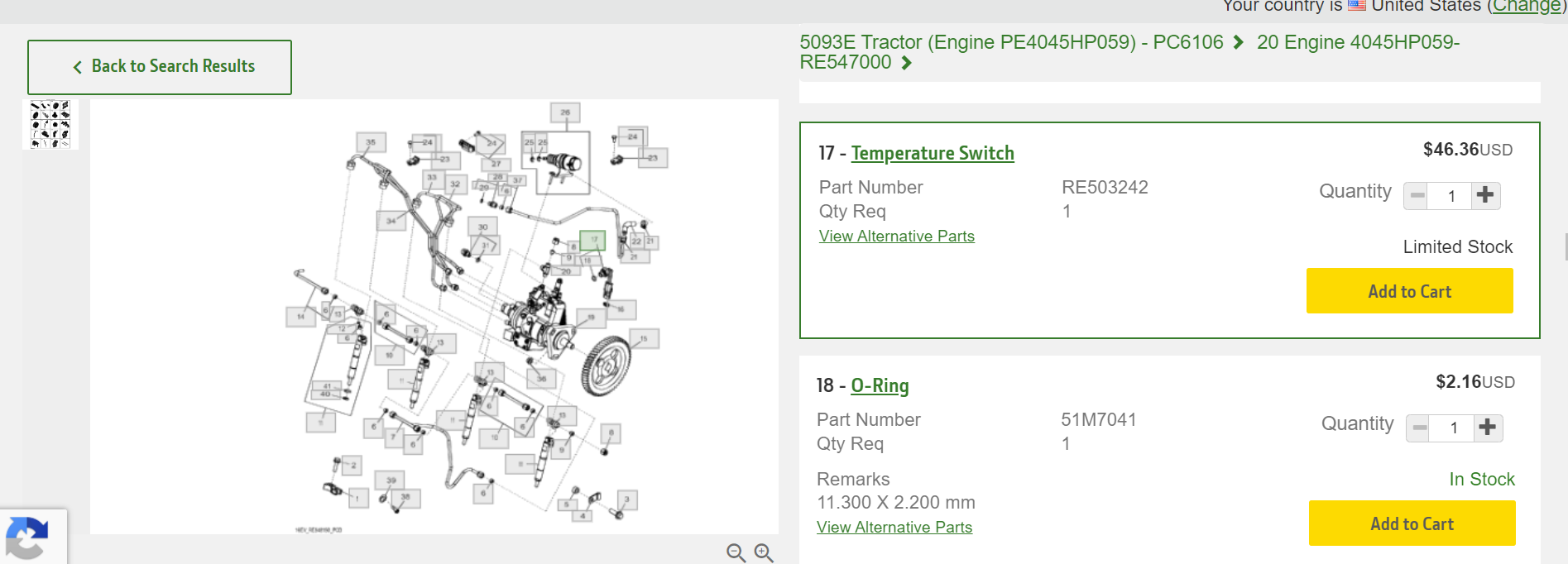

I thought the sensor that shorts out & blows fuse may tell the intake heating element OR the glow plugs when to come on for winter time cold starts idk
maybe it does control injection pump timing in really cold temps.
Congratulations on your repair & thanks for your update. NO glow plugs were ever offered on a 4.5 L engine in a model JD 5101E.

so when you push the ign key strait into the spring loaded switch it heats an intake heating element since it doesn’t have glow plugs ?
   / JD 5101E Open Station won’t light up dash or spin over. #13
That is correct Brown Dog

Will pushing in on ignition key still heat intake since I have the shorted sensor unplugged ?
   / JD 5101E Open Station won’t light up dash or spin over. #15
Thanks beenthere.
Good question. Let us know.

I'll bet heater intake will power up without cold start sensor that controls inj pump timing. What's the ambient temp when you're attempting to start engine? If temp is 32°F & above I'll bet your tractors engine will start running without the aid of a functioning intake heater

i bought a new cold start sensor from JD today $46
The parts guy knew the # in his head lol
he said he sells them regularly.

So is it a cold start sensor or a coolant sensor, the box I bought only had the part# on it but no description.
   / JD 5101E Open Station won’t light up dash or spin over. #20
RE503242 is referred to as a temperature switch in 5093E, 5101E & many other JD parts catalogs. My understanding is this temp. switch senses coolant temp & aids in altering injection pump timing during colder ambient temperature initial engine start process.
That same type temp switch has been failing since introduction of the 5X10 model JD utility tractors. I wonder how many 1000 of those temperature switches JD dealers have sold in 20+ yrs
