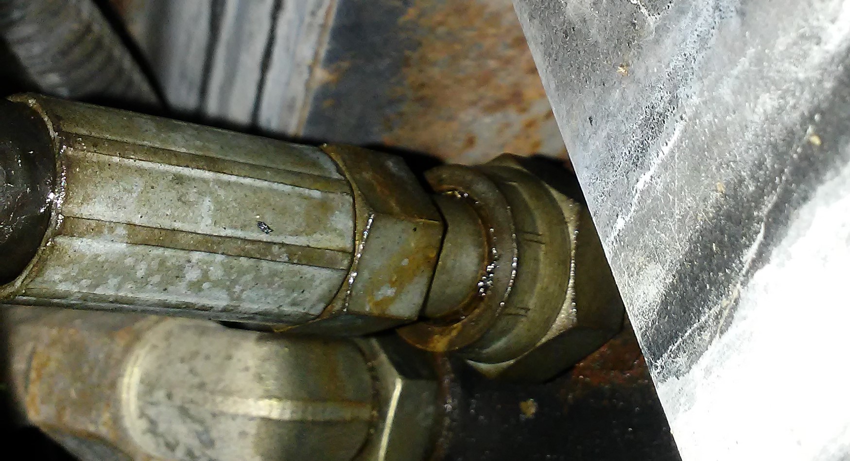

Here are a couple of pics. Looks like this may be a non-JD hose already replaced with a swivel added. Tractor Serial is --340242. Tractor as 6000+ hours and the AC lines are a little brittle. Would like to get ontop and avoid the AC lines and the other two steering lines on the right. But before I start I want to know if this connector requires replacement O rings. It looks like the later models do not use the O ring but my current connector looks like the older (pre-34000) and open operator hose. Thanks
You have it backwards. Later models, 340001 and up, hose, P/N SJ12165, use an O-ring. They are ORFS 8 (1/2") hose end. O Ring Face Seal. The O ring is P/N T77857. .489" ID .629" OD .070 thickness (diameter of o-ring stock used to make it). This is the end at the steering valve. I ASSUME other end is also same size.
JD parts has you use the late hose and change the adapter to P/N 38H5003 which is a metric port to ORFS straight adapter. If you have a 340000 or lower serial number.
The hose end at the steering valve is ORFS 8. It will be a female swivel. I can't tell what angle, but it does not appear to be straight.
I would ASSUME the other end will also be ORFS 8
A John Deere dealer parts department should be able to give all the specs for this hose from the P/N. Length. Each end fitting.

Thanks! That helps and the line sump side is female with about 3" of straight from the connection into a 45 degree. So I think the hose on there now is either backwards/reversed or is a non-JD replacement. Concluding I Have to pull it off, park the tractor, determine the type of connectors then order or have made. Thanks for the response.

Just an FYI the thread size for ORFS 8 is 13/16"-16; threads per inch. From the picture sounds like it might installed backwards. But all it has to do is fit.
A hydraulics shop should be able to provide correct o-ring just asking for ORFS 8 or 1/2"
Is the leak at the crimp (fitting to hose) or the fitting? It might be just loose or need a new o-ring, unless it is the crimp.

Thanks Zebrafive. I got some better conditions rolling in in about 48 hours. I'm going to keep the tractor under cover until then and then get it up next to the house/shop outside for a couple days if it takes a day or two to get it apart and find a replacement. The hose is leaking at the ferrule/crimp but the connections are dry. The pictures show hydro fluid around the valve but that appears to be leak down from the hose end of the crimp. The current line is labeled at 3/8" hose so this has to be a replacement. Kinda feel like I looked into everything I could to prepare to do in one morning (get parts in advance) but with the extra connector between the hose end and the adapter at the valve end I don't think I'll really know until I get it off. Thanks for the responses.

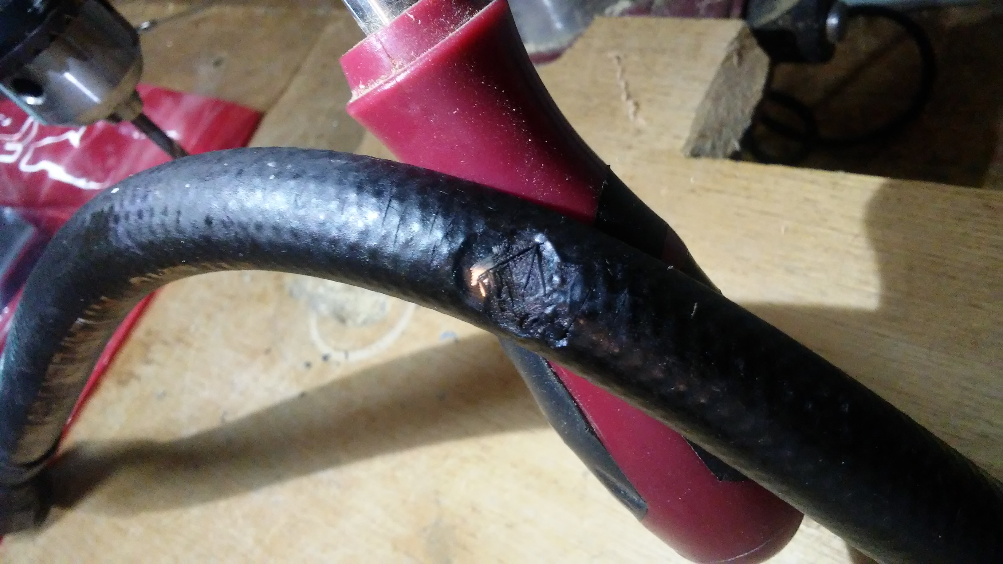

Zebrafive you were exactly right! The set up was just as you said (SJ12165) and the replacement hose was installed backwards. Once I got the hose off it turned out the ferrule/crimp was just the collecting site of the fluid. Because the hose was installed backwards it was rubbing on the support frame for the hood and wore a hole in the hose and was tracking down to the ferrule crimp. I couldn't see the puncture because of the hood frame and the AC hoses. Turns out getting the hose off was the easy part. Turns out too that this hose was a lot closer to rupturing than I thought.

Good news; bad news; can live with it for now. I got the steering return line made up locally and got it installed with no leaks in the original orientation so that it no lower rubs on the hood support bracket which caused the original abrasion leak. Then worked on the sheared off bolt after make-shift soak bath in a penetrating oil. Tried a counter-clock-wise small chisel, carbide, titanium and left handed drill bits, ran the tractor to heat the manifold, allowed to cool. Tried everything again. No luck on the bolt. For today, with the sun setting, wind blowing and temp falling (both outside and beer) and salmon on the grill.......I hammered out a strip of sheet metal I had to mock up a temporary support and shut it down for the night. A buddy boasts about his welding prowess both torch and mig. If my make-shift support rattles or allows too much play I'll invest more time on getting this
