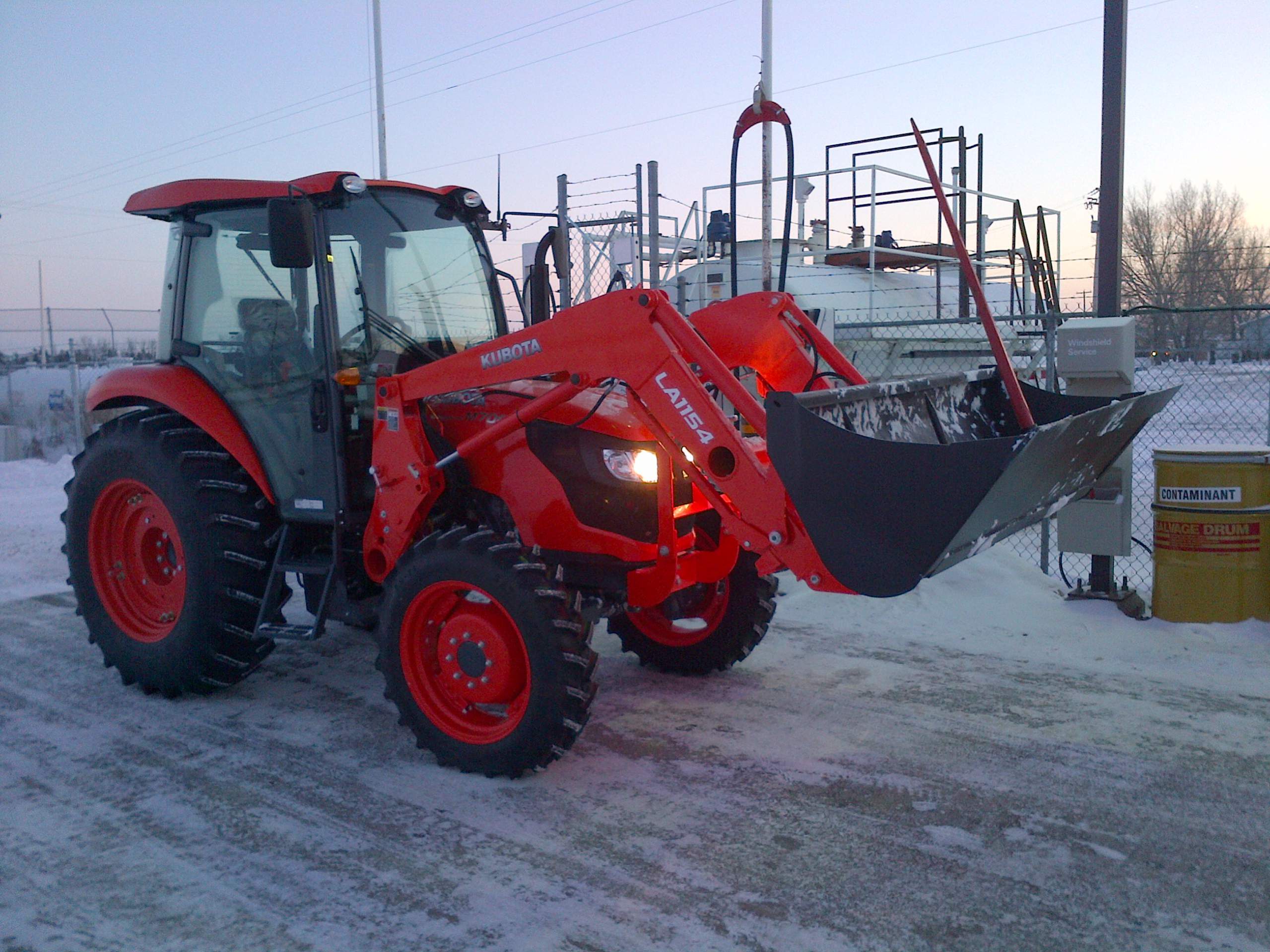

Here is the new machine... I finally picked it up today and broke it in on the way home. I cleared some snow with it on the way home at a friends place. This is a real pleasure to run. I have no regrets on not going green.
Congrats on the new Kubota, I recently bought a Kubota myself, very impressed with my L3800.
   / JD 5075E vs Kubota 7060 both with cabs #33
Congrats UncleBilly, she's a Beaut!!!!!
   / JD 5075E vs Kubota 7060 both with cabs #34
Looks great! You're going to love that tractor.
   / JD 5075E vs Kubota 7060 both with cabs #35
Congrats!
