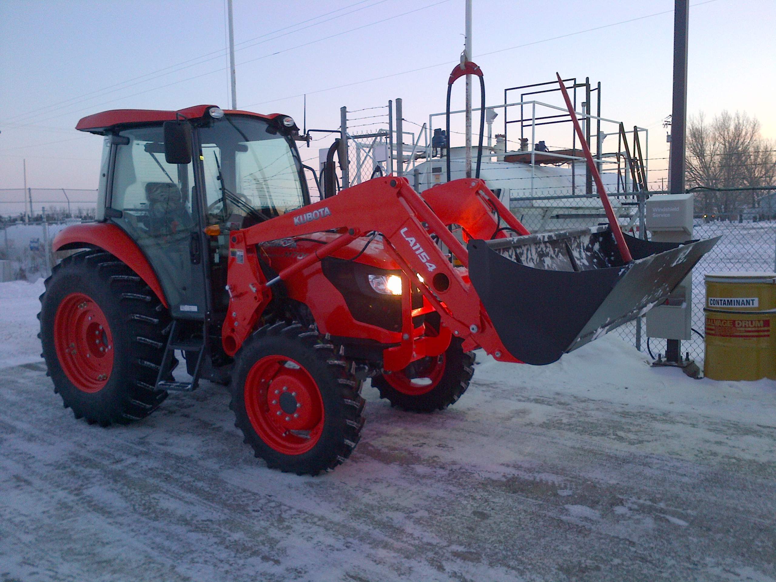

Here is the new machine... I finally picked it up today and broke it in on the way home. I cleared some snow with it on the way home at a friends place. This is a real pleasure to run. I have no regrets on not going green.
   / JD 5075E vs Kubota 7060 both with cabs #30
Very nice 7060.:thumbsup:
