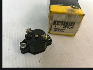

I advise to change 24 volt elect system over to 12 volts & save yourself a lot of grief. I served as a JD dealer service manager from '74-'87 & I'll bet I understand the quirky JD 24 volt system much better than the average member of tractor discussion forums. Does your tractors electrical system have 2 large circuit breakers that were field installed that help keep wiring from shorting out & causing a fire?

Sorry about the muiltiple posts. This is my first time and I'm just figuring out how this works. Definitely haven't seen these breakers.
