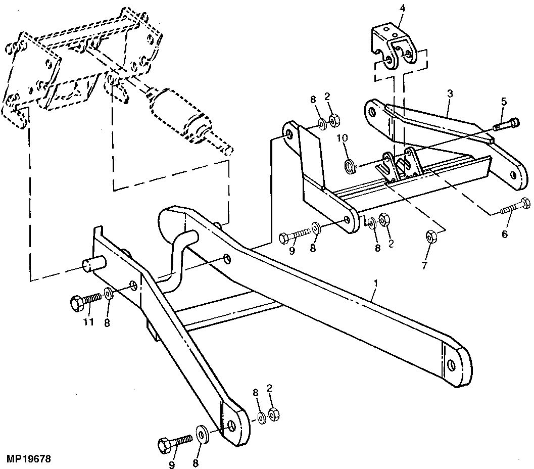

I have an older JD855 tractor. JD front mount snow blowers are hard to find and harder to find the correct mounting hardware.
I have the CORRECT mounting hardware where I can get my hands on it in a minute or less...........
Now the problem.......
The 59" snow blower body are few and expensive..... But I know they will bolt up to the brackets no problem.
The 47" blower is also listed as an option for that size tractor. Problem is I think there are several versions of the 47" blower. That is the blower part may be the same on all, but the brackets welded to the rear of the blower may be different for the ZTR type machines, X series lawn tractors, or newer model tractors about 30hp or less.
I know there are more than one 47" snow blower serial number prefixes to these implements............
I need to know what blower body matches up with my mounting hardware.
Local JD dealer is ag oriented and NO HELP with CUT or SCUT questions.
Anyone with solid info ?
Thanks

buckaroo,
you need the older 47 in blower with the
gearbox on the back instead of the chain drive.
they are not the quick hitch blowers, and have the
same mounting holes as the 59 blowers.
there are 2 varieties of these 47 blowers also,
ones for tractor mount, and ones for front mount
mowers. they modified the gearboxes to make them
fit the different power units, depending on the
pto rotations. front mount mower pto's turn in the
opposite of our normal cuts.
they also used those blowers on old 400/420/430 and
occasionally the 318. the blower head should be
the same, with the different lift parts and drive
shaft etc. this pic shows the lift arms that are used
on the 855
