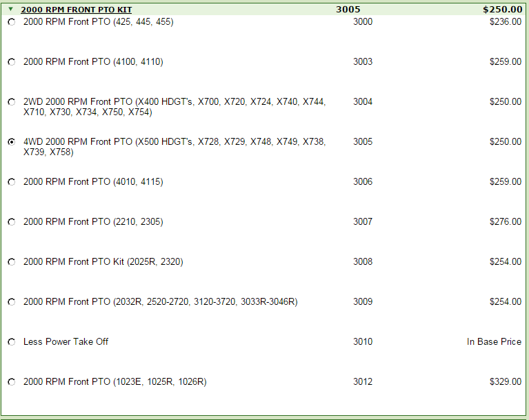

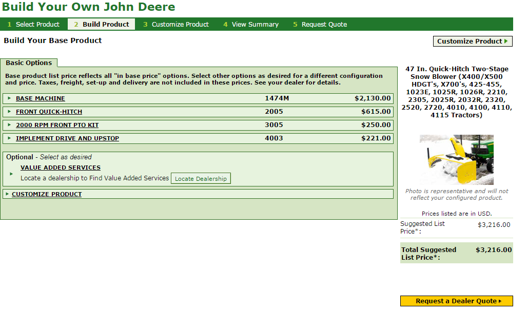

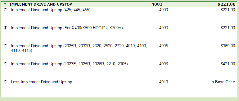

Hi,

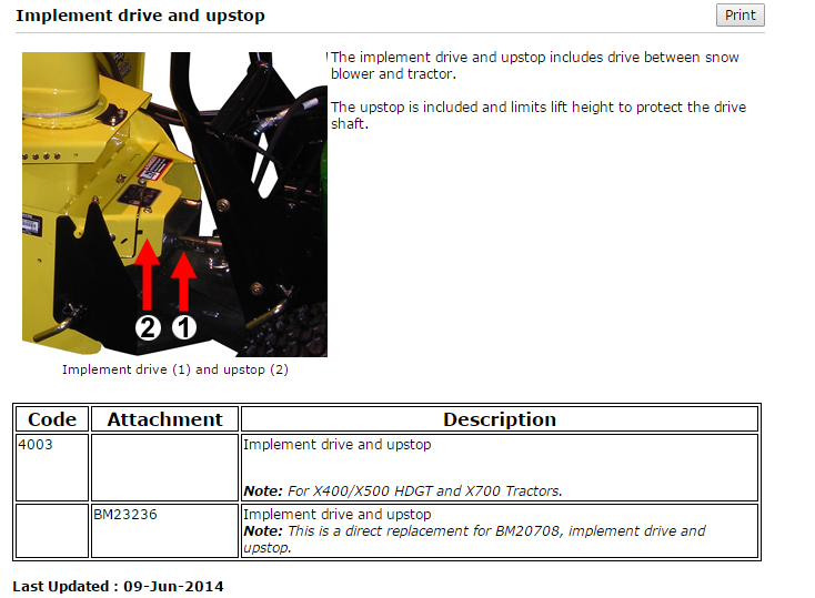

My father is looking for a JD 47 Snow Blower for his x595. I found a used one on CL for him that was on a x475. He is trying to find out what he would need to purchase to get this blower to work on his x595. From looking at JD's website it looks like the blower, quick hitch, implement drive and upstop are the same from the 2wd x475 to the 4wd x595. Is only the 2000 rpm front pto kit needed to get this blower to work. Does this front pto kit include the stub shaft that will be needed to be added to the front axle? If not, does anyone have the part # and price for that part? His local dealer told him he will have to buy $1,000 worth of parts to adapt it. From my little bit of research, I do not think that is true. Thanks in advance for any help.

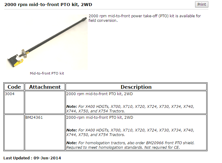

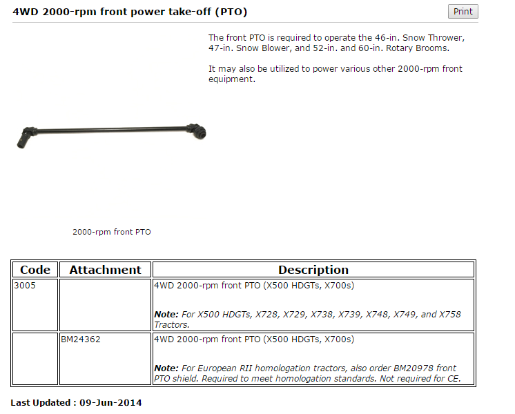

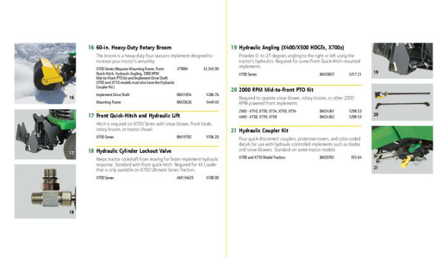

A few more/ better pictures I found. Unfortunately it still does not show the shaft that would run through the front axle. Any ideas?
Thanks,
Russ

you have it right, the short shaft in the picture goes thru
the front mfwd axle with bearings and seals to complete
the front pto kit for the blower. there is also a hydraulic shutoff
valve that comes with a new setup, that usually doesn't go with
used kits. that can be purchased separately and goes up behind the valve
and is the shutoff for the mower lift cylinder when using the front attachments.
it improves the spout control performance while the blower is on by eliminating
the mower lift cylinder taking oil in addition to the spout cylinder.
/ JD 47 Snow Blower for x595 Question
Hi Dutch,
Thanks for the info. So do you think the short shaft comes in the BM24362 kit?
/ JD 47 Snow Blower for x595 Question #6
yes, it's item #3
here is the install instructions. this new kit has parts for the new
autoconnect tractors which you will not use (the little "C" clip and it's hardware)

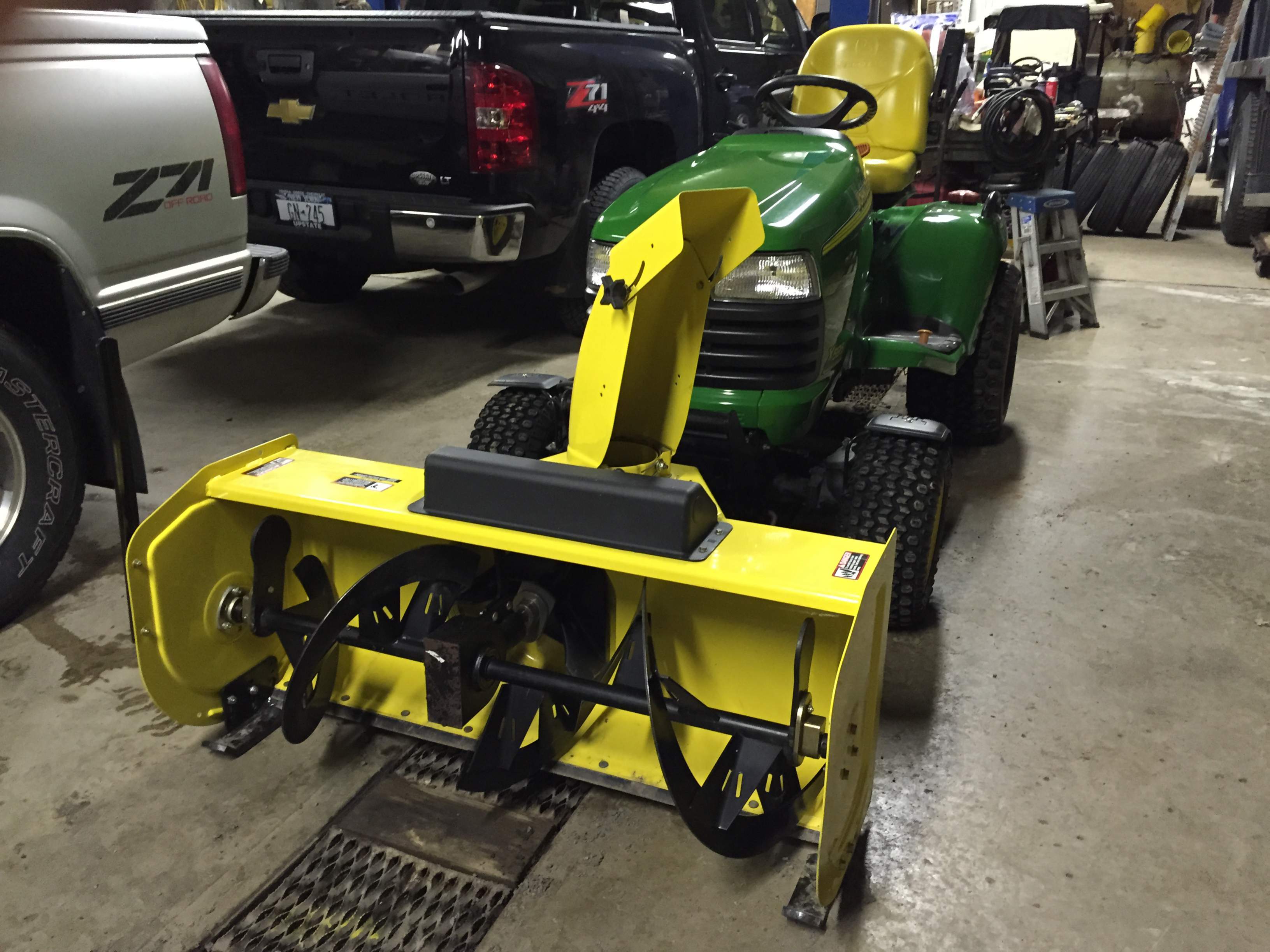

Just a quick update. My father did not buy the blower that I posted the question about. I ended up finding just a quick hitch on craigslist that came off a x595. It was a divorce and the seller never got the tractor back from the ex but had the quick hitch. He was able to get it for $280. New ones are now over $700 even though the build it online still shows $615. Then I found a really nice 47 blower with the implement drive and upstop, along with the main PTO shaft, missing the quick hitch the previous owner kept, for $1,500 at a local JD dealer on MachineFinder. The only problem was he still needed the shaft that I was questioning that runs through the front axle. The dealer with the blower sold him the complete 2000 Front PTO Kit for $293 and then discounted it $50 if he gave them the old PTO shaft back since the kit came with a new one. So all said and done he has $2,216 w/ tax into the setup. The blower looks like brand new and had maybe been used once or twice according to the dealer. Though not a steal, he ended up with a really nice blower for at least $1,257 less than a new, with the tax figured in, setup. The savings is probably a little more considering the dealer said prices have gone up on the new since he got the original quote last year. Thanks again for the help and info to know what he needed to get a 47 blower working on his x595.

Well, so much for insurance, but he is awful happy that he bought the blower. He lives in Attica, NY, which is in the snow belt, not too far from Buffalo/ Lake Erie. Had lots of snow last week. I was back home for a funeral and got to take a look at his purchases. He got his plow truck stuck a couple of times and used the JD to help clean out around it. He also did alot of cleaning up with the blower. He really likes it and glad he made the purchase. He did get the JD stuck at one point, so we added an old elevator weight on the 3-pt. Hopefully it helps. Here are a few pic's. Thanks again guys for the info and help.
