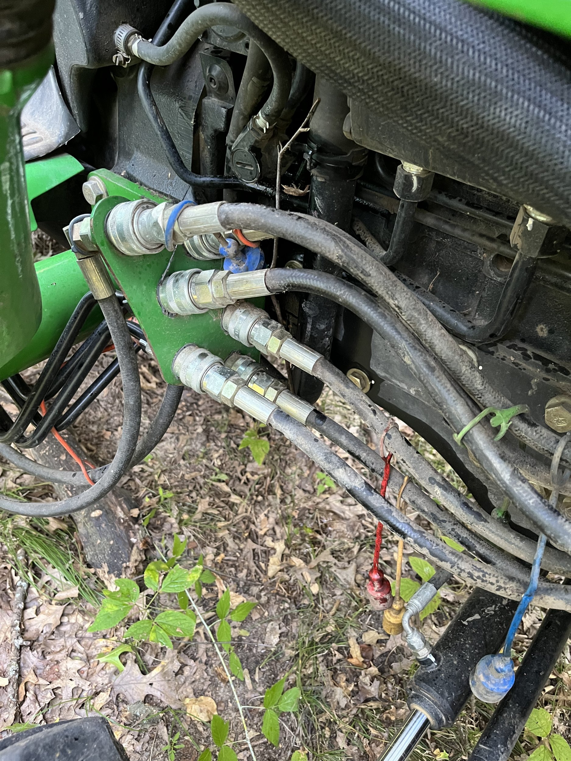

I need help
Was brush hogging and a large branch hit one of the hydraulic lines shouting off tractor. I removed the branch but now will not start. A tiny. Bit of fuild escaped
Turns over but no start. I’m in the middle of no were
Any suggestions??? I will go to dealer tomorrow

I would carefully go over (and under) the tractor to see what else may have been hit. You do not say whether the tractor will crank but not start or will not even turn over. If it's the latter you may not be satisfying one of the safeties. Did you perhaps leave your PTO engaged?
/ JD 4320 sub compact #3
Hydraulic line will not keep the tractor from starting. I would look closely at the wire on the fuel solenoid. Could have pulled off.
/ JD 4320 sub compact #4
He said turns over but no start. Tells me it is not a safety switch. Must be fuel related.

It cranks. Turns and turns. Did turn off pto

Branch hit middle hose
/ JD 4320 sub compact #8
Look beyond the hoses. I see the lift pump in the picture. Follow those fuel lines to the injector pump. Look for wires pulled apart. The branch hit in the right area to pull something.

Thanks I’ll look at in am

When you say "bit of fluid escaped", is that what is running down the side of the engine block or is that possibly fuel?

Got new part

I replaced this part. Cranks over but does not start
Any suggestions

Have service come out. Looks like cam shaft that spins were fuel sensor goes is frozen
They r going to have to take in
I afraid on how much it will cost

Sorry we could not help you get it going. I really can not imagine it will be too bad price wise to fix. Most likely it is a simple thing that will just take time to locate.
Please Let us know how it turns out.
