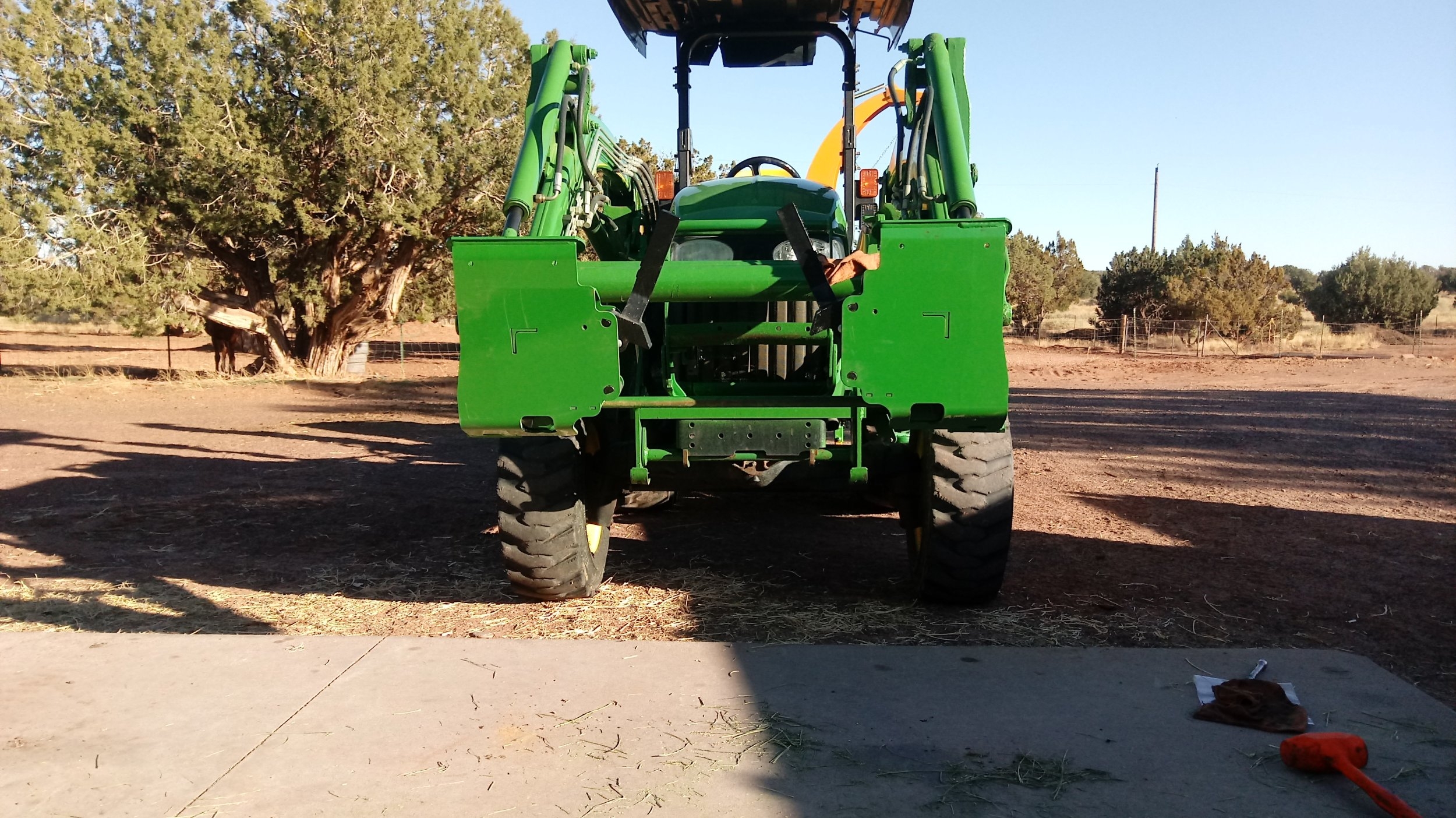

Switched out my JD quick attach to skid steer. That way, I can use all attachments for either loader or tractor. Also, didn't like the small flimsy oem bucket, so I bought a CNH Dirt & Foundry bucket, 5/8 yd.

Deere had two choices for buckets when I bought my 4300. One was a light weight snow bucket and the other a heavy duty bucket. Think your Deere bucket shown is the snow bucket.
Your new one looks good.

If I were you I would consider a cutter bar for your new CNH bucket. I have the JD heavy duty bucket on a 4320 with the cutter bar. You would be surprised how fast you can wear out the factory lip on that new bucket without it. Your new bucket looks like it is drilled for one. Just a suggestion.

I also modified my quick release loader mount. The locks are worn and it will come apart at the worst possible time. I replaced one of the mounts but that didn't help. I think the mast is worn the most and don't want to buy one of those expensive suckers. So, I bolted them together with a 7/8 bolt. I wanted 1" but I didn't have a good bit. The 7/8" has been working fine.
I have the 400cx loader, I don't like it at all. The spring dampers makes it floppy. I do like the self leveling part of it. I am using a self locking nut so I can give the bolt a little slack for slight movement of the mast.
