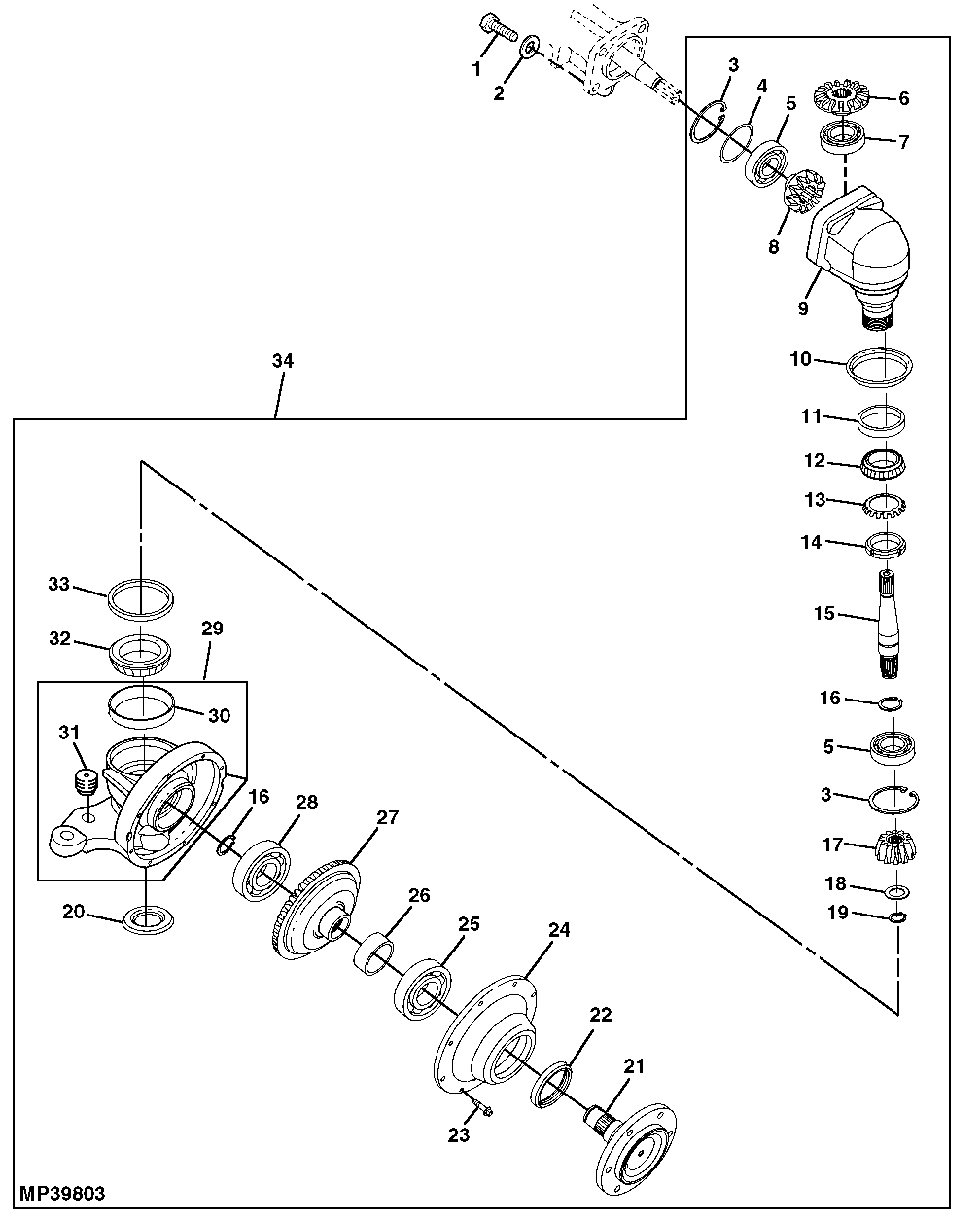

Found a good size oily wet spot running down my right front wheel, enough to make a 5" dia stain on the floor.
I've heard of axle seal leaks here, but not sure what I'm up against.
Anyone able to direct me me where to start?
Thanks, JB.

This what you're looking for? This is from the JD parts site - 4310 front diff. - Sorry but evidently you cannot copy/paste a link to a particular page on their website anymore. Maybe this is of some help.
Thanks, that's the right schematic, but no part descriptions?
Also never had any luck on the JD parts site, looks like I need to learn.

Do you know what part the seal is in this blow up? 22 maybe? because mine dripped on the outside of the wheel I think it must be coming from the end somewhere? Let me know what you find, what model do you have?

Do you know what part the seal is in this blow up? 22 maybe? because mine dripped on the outside of the wheel I think it must be coming from the end somewhere? Let me know what you find, ......?
The seal is 22 and the part number is LVA16814. AXLE OUTPUT W/INSTRUCTIONS, (SUB FOR LVU10836)
Hope this helps, my reply in bold letters.
/ JD 4310, Front Axle Leak? #10
JB,
Part # 22 is listed as a "seal" on that drawing - it has a JD number of LVA16814. The only other part shown there is #33 - which is'nt where I would think your leak is. I attached a link below directly to the JD parts page - just enter 4310 in the model block (left upper portion of page) then scroll down and pick the 4310 tractor.

Just finished one side on this job, taking a lunch break. The job is not too bad, but If one is not a moderate/advanced DIYer, I would not recommend it. I ended up *not* having the tapered bearings (which is a more difficult job). A hydraulic press is required to do the job properly -- would not touch it without it.. Harbor Freight had their middle one on sale today and, with the 20% coupon, came out to be a little bit more than $100. The thing that makes the job more difficult is that the instruction sheet that comes with the seal specifies a .060" rise above the housing. I have depth gauges, so I was able to measure it precisely. I assumed that JD must be having problems with these seals because 1) they have been updated and 2) they have a precise depth for the seal. Now, of course, the reason for the precise depth is that the new seal also has a "flange" that "rides" on the hub facing the tire (in addition to the "typical" sealing surface) -- hence the precise depth measurement. During assembly, when I put the outer bearing in and seated it, the hub had a little more resistance than I was comfortable with when turning to check it, but I assumed that this was because of the additional mating surface for sealing. However, by the time that I had installed the inner bearing, the turning tension was less.
For those that are uncomfortable doing this job, the removal of the hub from the axle is *easy* and, if done by an owner that is not putting the seal in, this would enable you to take the hubs to any repair/machine shop and have the seals installed without taking the tractor.

Good evening, JB --
I have a 4300 but I reviewed a few previous posts on the site and I would bet that your hub is the same as mine.
A little more discussion on the seal: it is not the "traditional" one-piece seal, where the sealing surface "rides" in the surface of the hub, instead, it is a two-piece seal and the second part of the seal is attached fro minside the housing after the outer seal ring is installed on the housing. Also, the second part does *not* rotate on the surface of the hub; instead, it is "fixed" to the surface of the hub (read: a resistance fit, not bonded) then, as the hub rotates, this inner seal rotates against the "outer" seal (the one pressed into the housing.
I have done a lot of automotive work through the years and had never encountered one of these before. After doing a little web research, apparently they are quite common in heavy-duty applications and quite common in the trucking industry.
After doing the job, I agree that, if you don't do it yourself, I would take it to the JD dealership and let them install it.
If you do end up doing it yourself, the seal installer from John Deere is just $30. The part number is JDG11067.
Note that I have posted the procedure on a new thread called " Replacing Front Seals in John Deere MFWD Tractors With Two-Piece Seals," so that it can be found easily if needed . . .
