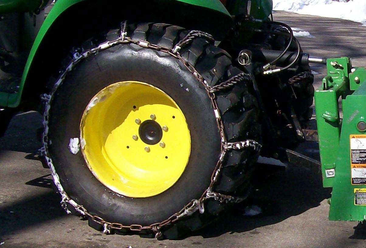

On my JD 4300, I made my ladder tire chains that fit in the hollows of the Industrial tread by using shorter cross links and longer side chains. Works very well to avoid problems with the narrow clearance. All the commercial chains come down a ways on the sidewalls and leaves too little room between the fender and the tire.
In addition, primarily to gain stability (less pucker factor) on side slopes, I added 2-1/2" spacers to both rear wheels.
These were obtained through Motorsport Technology Racing Division (per suggestions and posts here on TBN). That was 9 years ago and the cost for both adapters $275.
They work very well and have been no problem since adding them.
