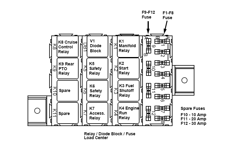

my 2004 4300 did that a couple times for no reason. if i removed a random relay from the fuse panel and replaced, it would suddenly work. after i got it running (in the morning), it would start throughout the day. this happened twice, and both times i removed the same relay (pto). then it hasn't happened again. i was going to try different relays to see if i could figure anything out, but haven't gotten a chance as it keeps starting.
JD part #: relay #RE68327, thermistor #LVU10323
i've been told that the relays are just standard automotive SPDT 30/40A relays, but i haven't checked it out for myself yet.

I'll check out the sediment bowl and thermistor this weekend. Anyone have a diagram where I can find the thermistor? I guess I could run by the local JD dealer to see if they can print me out a copy. (I just need to break down and buy the FSM).
/ JD 4300 won't crank #29
It is on the back side of the fuel shut-off relay socket.

Small Updated.
Finally had a chance this week (after ordering the service manual) to check a few things. Fuses test good (although they were really dirty; so I cleaned them up). Looks like the thermistor had been replaced before. On/Off switch on seat tested good. Fuel solenoid was clicking on and off properly and had power to fuel pump (using test light).
I'll try this weekend to go through the book replace the fuel filter and clean out the sediment bowl.
/ JD 4300 won't crank #31
Thank You everyone. Turned out to be the Thermistor after all. Snipped off the old one and wired up the new one. Fired right up! Now I have some shredding to do!
