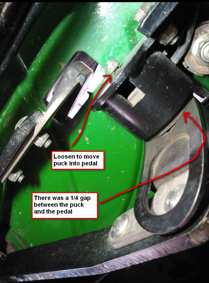

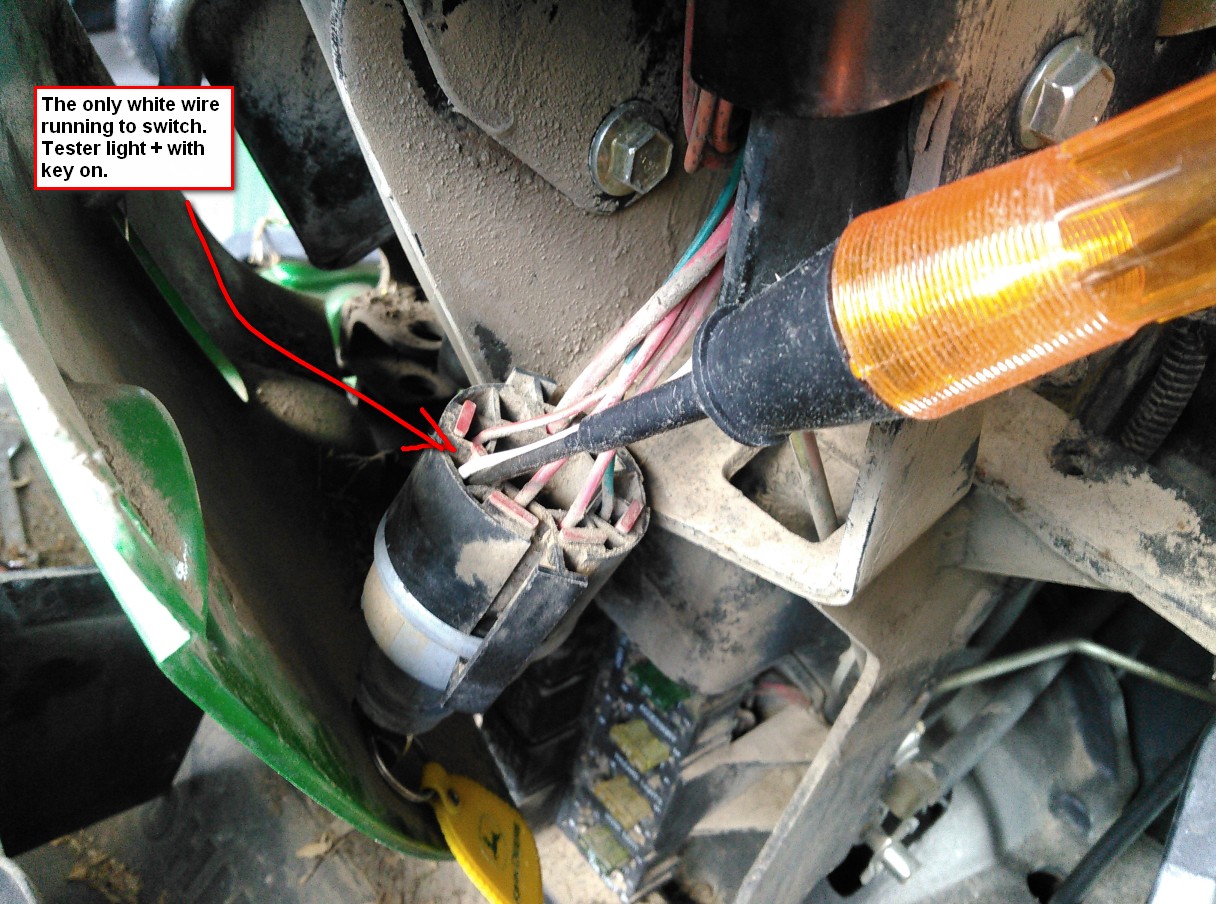

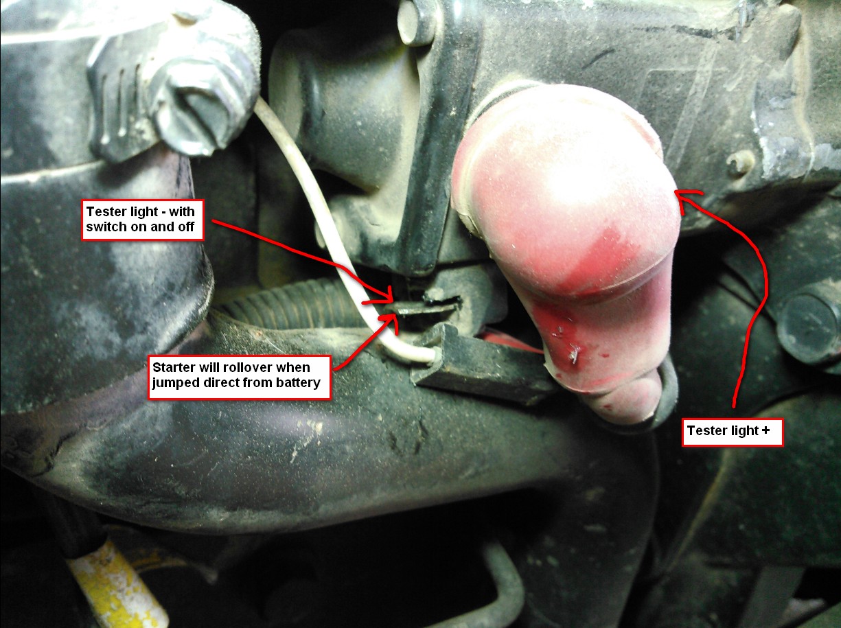

OK I had some time today to play around with it. I still can't get it to run or turnover but there is some positive news. When the turn the switch I clearly hear a click from the fuel solenoid. Then I was also able to get it to turn over by jumping from battery to one of the wires running into the starter. So I feel the starter works. I have some things I tried below. Hopefully someone can point me in the right direction.
1. Neutral safety - This appeared to need some adjusting. I first jammed a screw driver in between the puck and the pedal to see if the puck need to be pushed in further? This did nothing. I then thought the puck must slide against the pedal to sense the location of the pedal. There was a 1/4 inch gap between the puck and the pedal. So I released the puck by about 1/4 inch so that it rides along the pedal. I really do not know how this functions. So my adjustments may not have actually done anything. I followed the wires as far as I could and they appear to be in good shape.

3. Starter - The starter wires all look good as far as I could follow them. So I took a tester light and made contact with the red terminal (#2 on pic) on the starter - it lit up. I then made contact with the white wire running into the starter (#1 on the pic) with the key on and off. Tester light negative. I am not sure what this is but I was able get the starter to turn over by jumping to this. I followed this wire as far as I could and it looked fine also.
4. Switch - I pulled the dash off to clean everything up and to try and track some wires. I took the switch off and cleaned all the contacts. I placed the tester light in the only white wire going to the switch (thinking this was the same white wire at the starter) Tester light lit up. I then inspected the wire and both are numbered but are different numbers.

From your trouble shooting reports it would seem to be one of the position relative shut down switches. Start on the easiest accessible and so on. I believe seat switches are troublesome.?
Consider it as a yearly electrical maintenance program.
/ JD 4300 Will Not Turnover #13
What I am seeing in your item #1, is you are working with the adjustment of the cruise control magnet that holds the forward pedal in whatever position it is in when the cruise control is switched on. Don't think it is the neutral control switch.
But I may be wrong.

You are correct. The neutral safety switch is located approximately 1 foot from the cruise control magnet toward the center of the tractor. It's not easy to find since it's located within the tractor's frame to protect it. But the good news is the bottom of the frame is open which allows access to the switch. The best way to find it is to manually depress either the forward or reverse pedal with your left arm while laying on your back looking up and watching the linkage move. You can see the switch being engaged/disengaged when a pedal is released/depressed. "Engaged" means the switch's button is pressed by the linkage allowing the tractor to start.

I had typed up a response this am and must not have hit post. Anyway after doing some more reading the "puck" is not the neutral safety switch. I did find it and also find the PTO safety switch. Both have been jumped and still no go. The only think left for me to check that I know of is the key switch. Which I have pulled and will test if I can find my voltmeter.

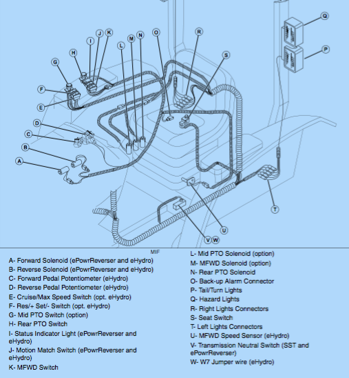

It almost sounds like the F/R potentiometers if either of them are sending a signal that the Forward or Reverse is depressed than it will send an override to not allow the tractor to turn over. All other electrical will work like the lights and turns but when turning the key you will get nothing.
I believe they are normally open switches switches so it is worth it might be worth disconnecting from underneath and see if it will start. If it starts up than you know it is one of the switches. Just be sure not to reconnect them when the engine is running if the tractor should does start.
I will see if I can pull up a schematic of the wiring system but it definitely sounds like you have a safety switch issue. JD's safety system is way over engineered where there is a multitude of things that can prevent the starter from turning.
