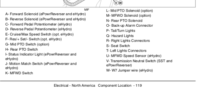

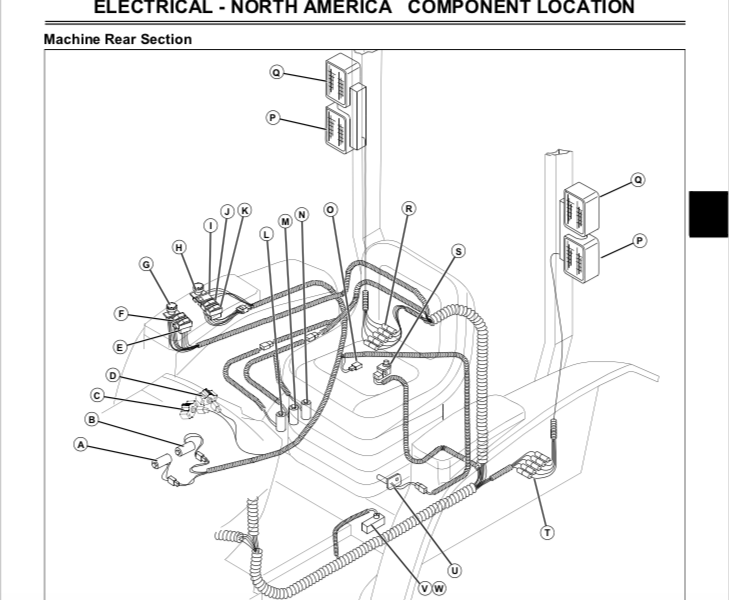

The tractor defaults back to 4wd when the 4wd solenoid doesn't work. It's letter "M" on the schematic. I believe all the solenoids in that stack have the same part # so you might be able to swap them out to rule out it is definitely the solenoid.
