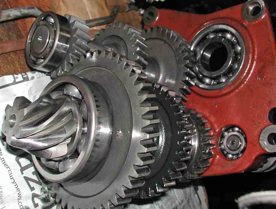

, the existing ring and pinion do not show excessive wear or sharp edges.
So Tom, to be clear, the gear that is stuck on the shaft is the big one in
my photo? I assume you bought that gear and the shaft, but you also
already bought a new ring/pinion pair? Have any photos of the damage?
It IS a much bigger jpb to remove the ring gear/differential, so I understand
why you don't want to do that. You have to take off the axle
housings to get the diff basket out.
It is certainly not recommended that you change only the pinion gear and
not the ring. But, if you decide to do so, go thru the shimming process and
paint the gear faces for proper contact. One thing in your favor is that
your tractor's final drive goes thru one more huge gear reduction before it
turns the wheels. This significantly reduces the forces on the ring/pinion
gears.

Thank you dfkrug for the reply. Yes, the large gear pictured was stuck, I was able to press it off the pinion shaft to revel the damage. I purchased the pinion and ring set, new gear, sleeve and a new bearing, I also picked up more shims. I had all intentions to make sure the pinion was shimmed as per JD specs. I am not the type of person to do a half-*** job but to me it does not look to be necessary to change the ring gear with all the work involved. I have seen and changed some bad ring and pinions before. This is not much different then a car or truck diff, just more things to take apart to repair it. If I cannot get the old ring and new pinion to mess properly I will be sure to replace the ring. By the looks of your pic, you have already gone through what I am doing. I do not have any pics of the damaged parts as of yet, but will post some soon. I still do not know how some thing like this got damaged, the pinion sits in six gallons of oil! I was driving along the road way in high gear and the machine came to a dead stop, after that nothing but low gear.

I feel like I have a problem with the assembly pictured by @dfkrug. I am pretty much a novice and never split a tractor. My gears whine/drag in all ranges (A,B,C) and all gears (1,2,3). I thought maybe it was my hydraulic oil, so I drained it all, replaced the filter and suction screen. When I took the suction screen out, that area was filled with bits of aluminum, which I removed. Since the previous owner claimed to have replaced the transmission, I thought maybe this was leftovers from previous work. I also found a single ball bearing. Didn't think much of it. Refilled the machine with new oil. Still dragging/whining. I thought maybe too much hydraulic oil, so I drained about 1/4 qt at a time to see if I could get it to quit whining. No luck, but I did find another ball bearing.
Looks to me like if one of the bearings in the assembly shown by dfkrug was losing balls it would cause every gear to whine?
Can you help me with a diagnosis?
Clearly, one bearing has failed, and this has caused some mis-alignment of gears. Since it happens in all ranges, it is most likely the main shaft of the trans, which turns in every range. Regardless, you need to stop driving it before you break a gear ($$$).
When you split the tractor, you should check for smoothness of all bearings. They are not expensive, but gears are.
Also note that if this happens in neutral on range selector or neutral on gear selector, you may be able to deduce which shaft is likely to have the bad bearing. You still have to open it up to find it.
