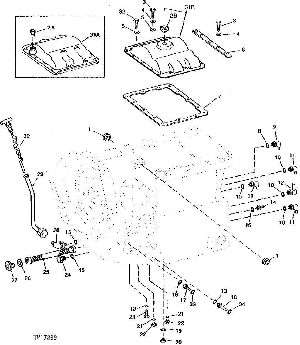

1st check to be sure frt pump shaft is turning with engine crankshaft. How long since hyd filters were changed & sump screen(parts key 25) checked?? I agree that one needs a hyd gauge and perform some diagnostics. Many frt hyd pumps have been replaced only to find out that hyd pump that was removed wasn't the hyd problem. JD CC hyd's such as a 410C should bleed any air out just by operation. Personally I think air isn't your tractors hyd problem. It's possible that a piece of trash has gotten lodged in the stroke control valve seat area which puts the frt hyd pump out of stroke therefore stopping pump from pumping oil.

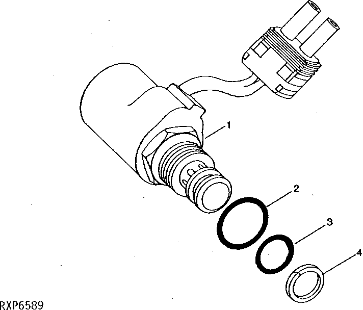

Does your tractor have the electric destroking solenoid? It would be located on frt hyd pump on I think LH side.

What does the electric destroking solenoid do ? just curious..
/ JD 410C lost all hydraulics. #7
Tx Jim
It takes the hydraulic pump out of stroke so that it isn't pumping while you crank up the engine. Performs the same task as an unloader valve would making the pump easier to turn.
/ JD 410C lost all hydraulics. #8
Ditto what jenkinsph stated. Makes engine & hyd pump easier to turn over/start running

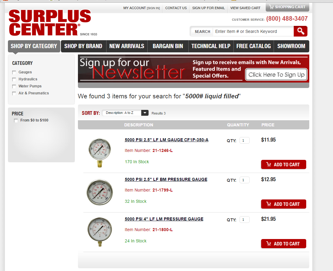

I think you need to get a 5000# gauge and check stand-by pressure. Pressure according to Tractordata.com should be 2755 psi. Just for grins after engine is started disconnect the electric destroking valve to be sure it's not causing the hyd problem.
