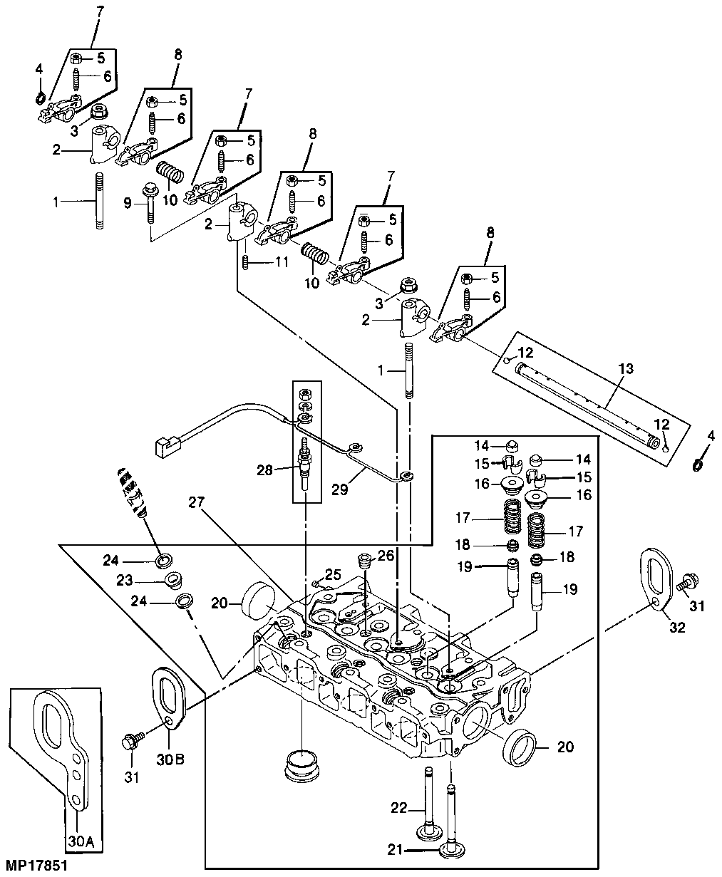

Feb 3, 2010 / JD 4100 Glow plug number #1 M MRBLUBLR New member Joined Feb 3, 2010 Messages 5 Anyone know the part number for glow plugs for a John Deere 4100? Thanks
Feb 3, 2010 / JD 4100 Glow plug number #2 kennyd Advertiser Joined Jul 6, 2003 Messages 13,843 Location Westminster, MD Tractor John Deere 3720 CAB/TLB, JD455 Welcome to TBN You are registered at jdparts.com aren't you It free! item#28 AT110814 PLUG Hope this is what you need...Have you tested them with a ohm meter? Attachments 4100 gp.gif 32.6 KB · Views: 1,649
Feb 3, 2010 / JD 4100 Glow plug number #3 B Barry Bowen Gold Member Joined Nov 21, 2009 Messages 264 Location Freeland, MD Tractor 706 IH, 1066 IH, and 301A JD have you also checked to see if you have current at the connection to the glow plug. Sometimes the module goes up.
