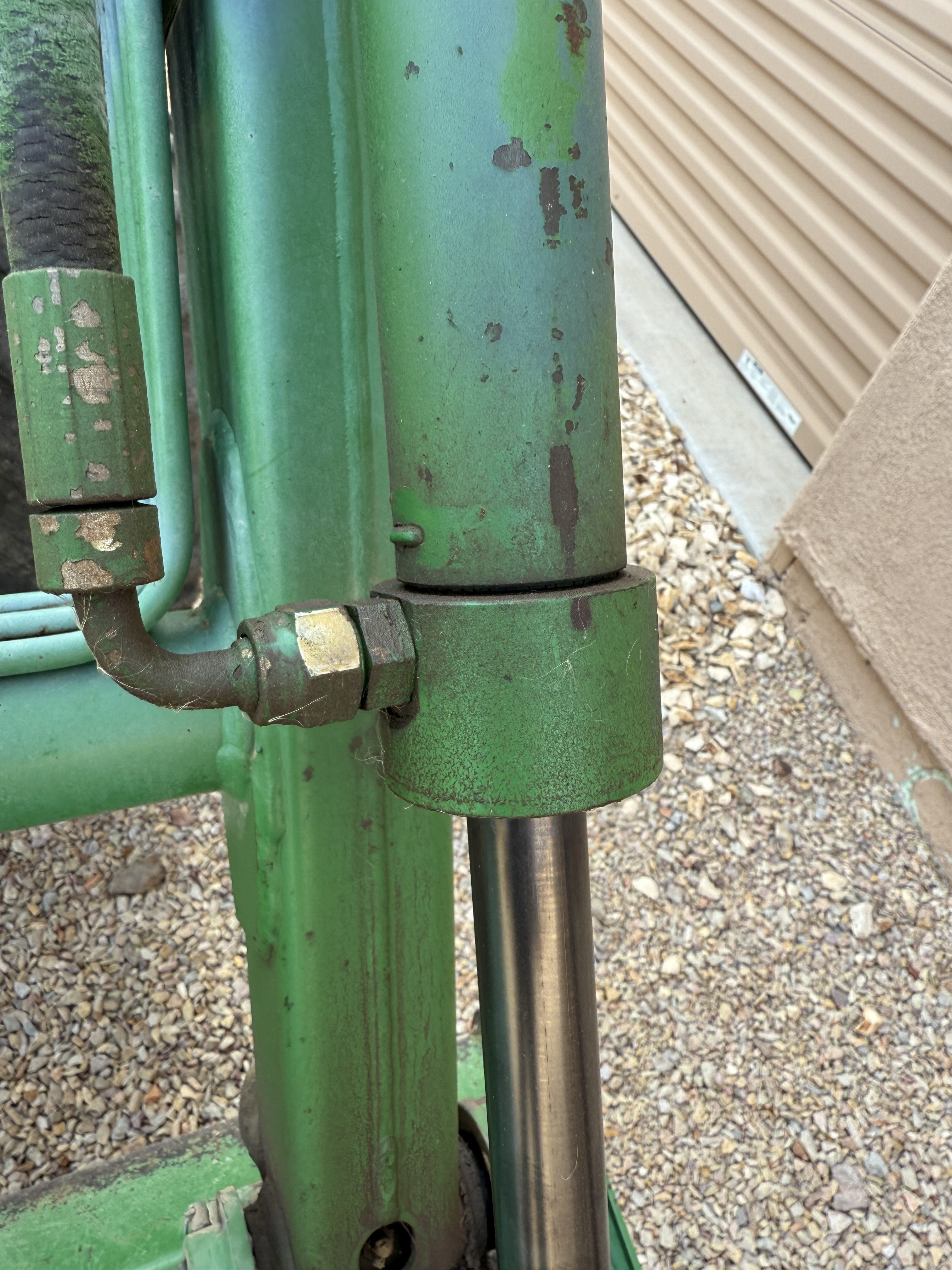

It’s been a long time since I’ve been on this site. The old 410 has served me well but one of the tilt cylinders on the loader is now leaking. I rebuilt them many years ago but I’ll be darned if I remember how to take it apart. I know the bucket end unscrews but I think there’s a lock pin somehwere and my notes don’t show it. Any of you old timers out there remember how to do this?

I used to have a JD4100 with 410 loader. I actually removed and reinstalled that cylinder. From what I remember the cylinder was easily removed with wrenches. Just jiggle the joystick a few times after shutting off the engine to release pressure.

Thanks but I need to know how to get the cylinder rod guide off the cylinder itself.
   / JD 410 loader tilt cylinder rebuild #4
Does it have the wire threaded in there to lock it?
My mistake. Your photo shows it on the loader. I removed it and took it to a hydraulic shop.
I cleaned off that part, looks to be just a dimple. I’m pretty sure the rod guide just screws off with a spanner wrench and that dimple is a guide. I’ll find out in a few days when the weather gets a little warmer.
