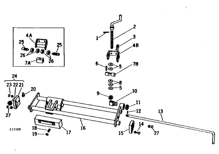

There is a knife grinder to mount on the chopper, that runs a stone back and forth if I recall correctly.
I'd be stopping by the Deere dealer and talking to them, as well as finding a manual that tells about adjusting the cutters and the stationary cutter bar. Both are adjustable, and suspect it is similar to sharpening and adjusting an reel-type lawn mower.
Here is what is shown in jdparts. #17 is the stone and #2 is the crank that adjusts the stone setting. #13 moves the stone back and forth over the cutter head.

And you are sharpening with the tool shown in the drawing above?
If so, then I'd visit the mechanics at the Deere dealer and discuss the problem.

And you are sharpening with the tool shown in the drawing above? yep
