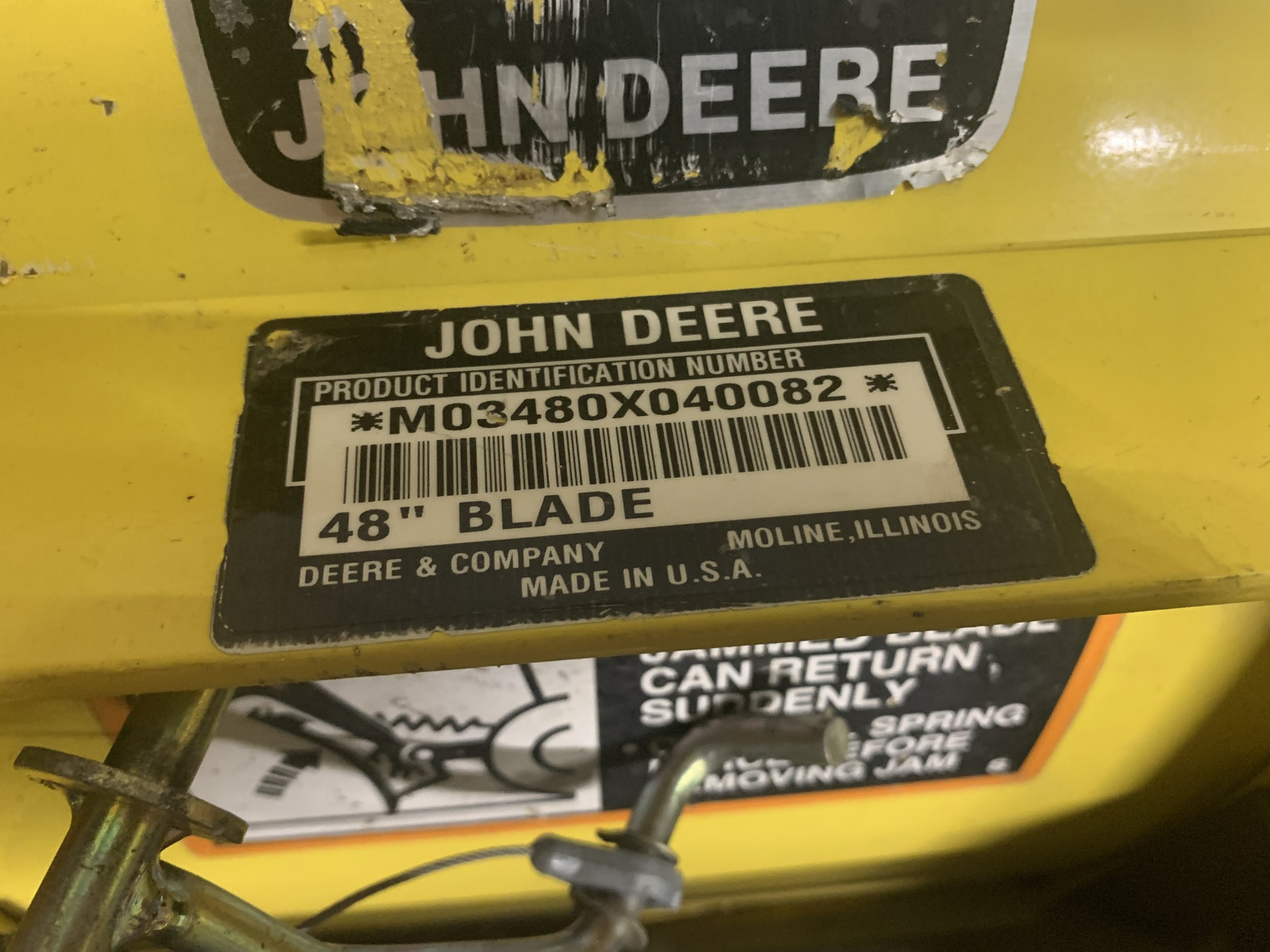

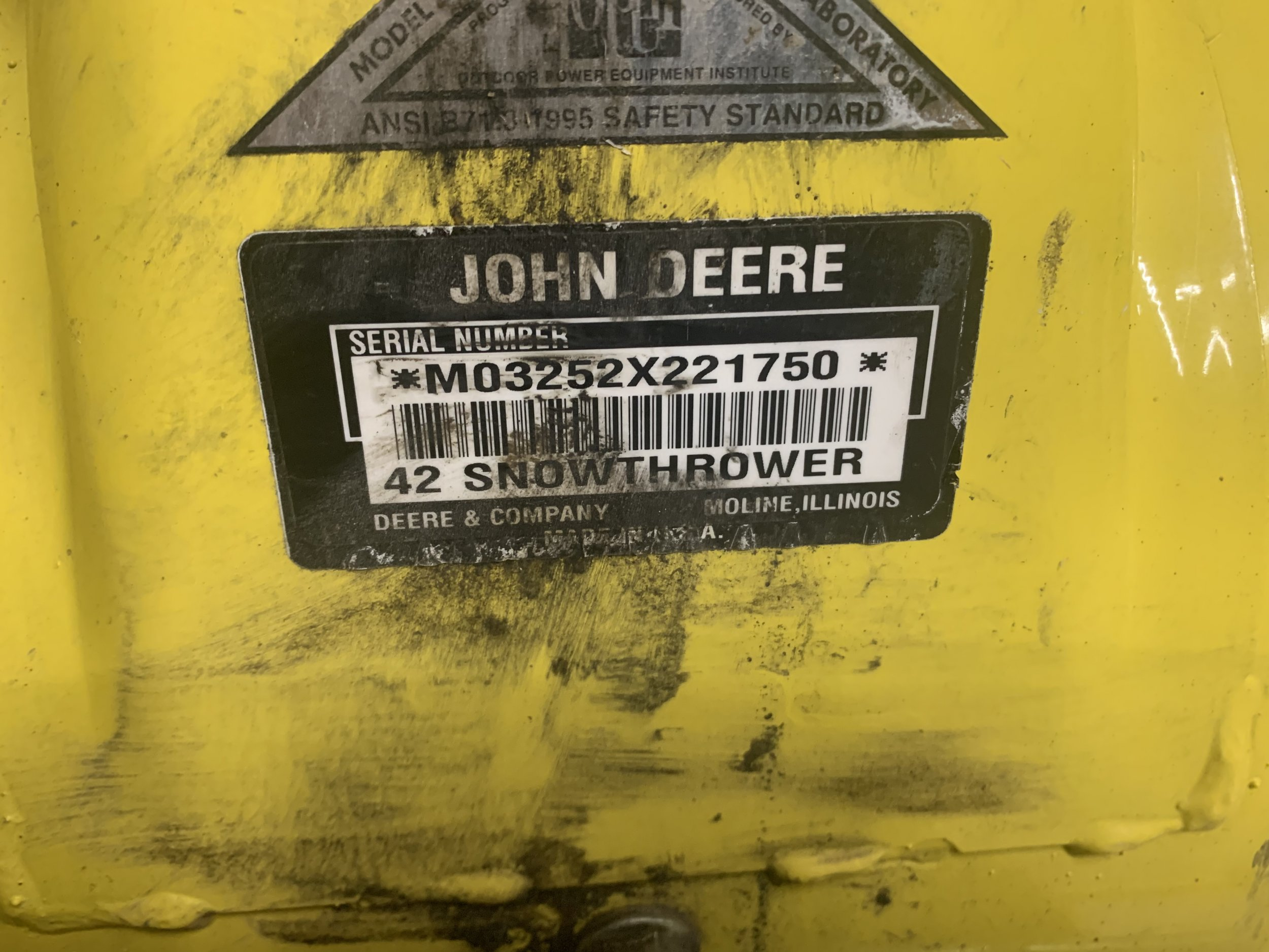

I have a JD345 and tonight I bought a 42” snowblower M03252X221750 and a 48” blade M03480X040082. Can anyone confirm these are the correct attachments for my 345? They came off a 325 so I think they will work. I didn’t get the front lift kit with them but I’m going to call the guy and see if I can get it. If not I will be looking for a lift kit.

I had a 325. Those are correct for your tractor.
The lift kit is available and can be looked up on the Deere parts website.

I have a John Deere GX345 and can confirm that snowblower is correct for your unit.

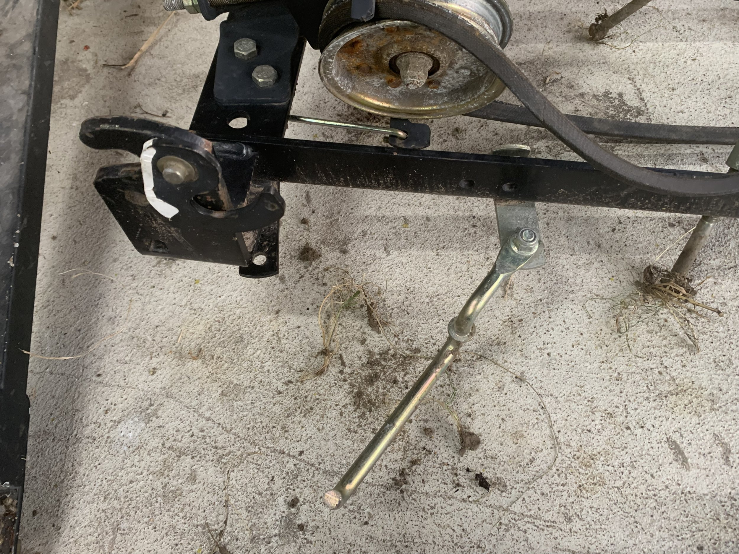

Can anyone provide a photo of the belt tensioner mechanism for this blower? Here is a pic of the tensioner on mine but I feel like it’s missing something as I don’t see how it would work as is. I cannot find a parts diagram online for this unit. If anyone has a manual or can point me to a parts diagram I would appreciate it.

Search the Deere parts website for 42 Inch Snow Thrower. It's there. There are two serial number breaks for the 42 Thrower.

Did you look at the links ?? Apparently not. There are two different snowblowers for different s/n 345's. Suspect you have the later model 345.

Sorry, I I thought the links were for the mower. That is the correct diagram. Thank you for the help. Not sure why I couldn’t find that as I use the JD parts site frequently. Looks like I’m missing a spring. Thanks again!
