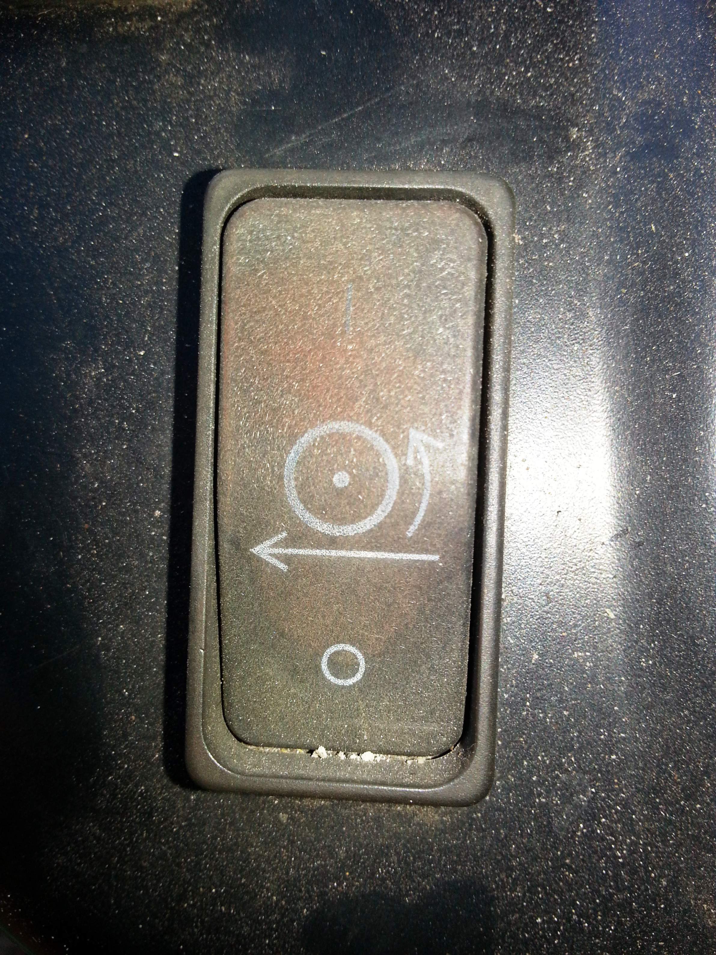

I own a JD 3320 I've looked at this switch for 3 years and have no idea what function it has and more importantly under what conditions I would want to use it ? Any help would be appreciated. switch.jpg

Total shot in the dark as the cab controls look a little different but is that your speed lock cruise control?

thanks guys so it's a load match switch ..... SO when and why would I use it ?

I use mine when using front bucket getting a deep heavy load, for dirt and stone and when climbing a hill mowing or moving stone or ag...kinda acts like a governor.
/ JD 3320 what is this switch for ? #9
Loadmatch will drop the transmission range down as soon as the engine begins to lug/stall under load... allows you to work at the speed you think you want to until the machine determines you picked the wrong one and "downshifts" to protect itself/keep you working.
Mine has only been turned off a handful of times... if you haven't had it "on", turn it on! Works great & keeps you from having to stop & shift constantly doing loader work & ground-engaging... also if you're transporting & hit any grade ("C" is anemic). I don't believe the PTO is influenced by it, except it keeps rpm's up when your mistaken selection range would start dragging the engine down.

I keep mine on all the time too. Although in almost 3 years of year-round use on 30 acres of steep Kentucky hillside, I've yet to experience it "downshifting" the transmission range. Mine intervenes as a rpm versus speed manager only. See LoadMatch switch

I never use mine. I prefer to decide when to stop pushing instead of the computer telling me when it is too much.

Same here on both the 4320 and 3720. Tried it on both tractors but prefer operating with it switched OFF for most work I do.
