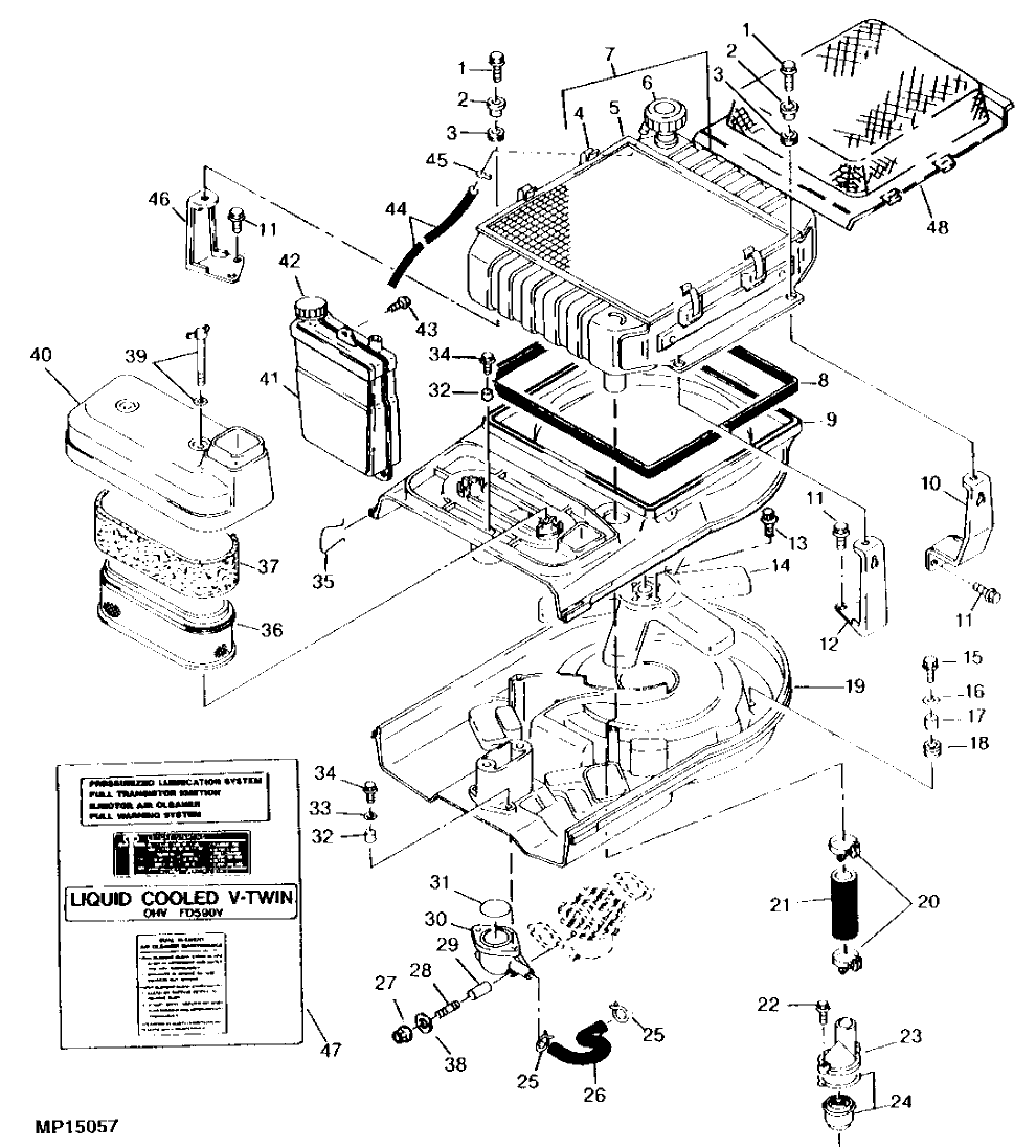

I'd like to take the radiator off so i can see whats underneath.....i'm scared when i disconnect the two larger black hoses from it the coolant is gonna go flying everywhere.. does anyone know how to take this off?

Otherwise to take the radiator off is a messy job but only take maybe 2 hours.
Drain the coolant from the lowest hose and then you can take the radiator and all this off.
You need a place so you can hose it down with some cleaner during all this, and air to dry it all off.

That's a good point I forgot about. Make sure your tractor has the metal heat shield that covers the muffler. The muffler is very close to the carb on that engine.
Would a muffler go 'bad' and create more heat than it should causing the carb to get too hot? is there a screen on this mowers muffler? like a spark arrestor or something of that sort that i need to clean/clear?
/ JD 320 stalls when engine gets hot/warm #27
The parts list show a spark arrestor kit, but I have never seen one installed. If so it would be inside the outlet of the muffler.
They are hard to get out unless they rust and deteriorate and blow themselves out.
It's just a real cheesy little baffle/catalytic converter that supposedly reduces noise etc.
It seems to me that this would make it hotter. A manual will tell you to take these out and clean them.
The only place I have even seen one is on a 4-wheeler or a motorcycle.
Can you stick you finger easily up into the end?
A HOLE in the muffler could cause excessive heat depending on where it's at, but you normally get abnormal noise with a hole.
They can possibly be welded by a muffler shop.
IF you really think this is the problem, order some new gaskets and take it off to inspect it. (Quan 2, Item 12)
