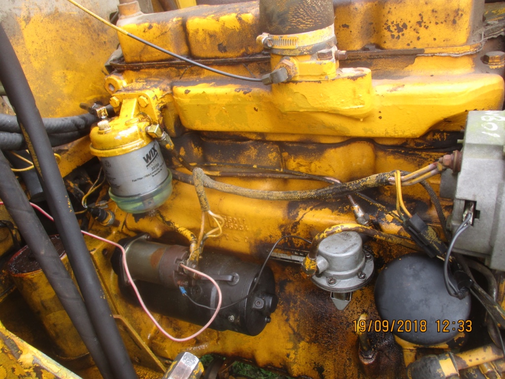

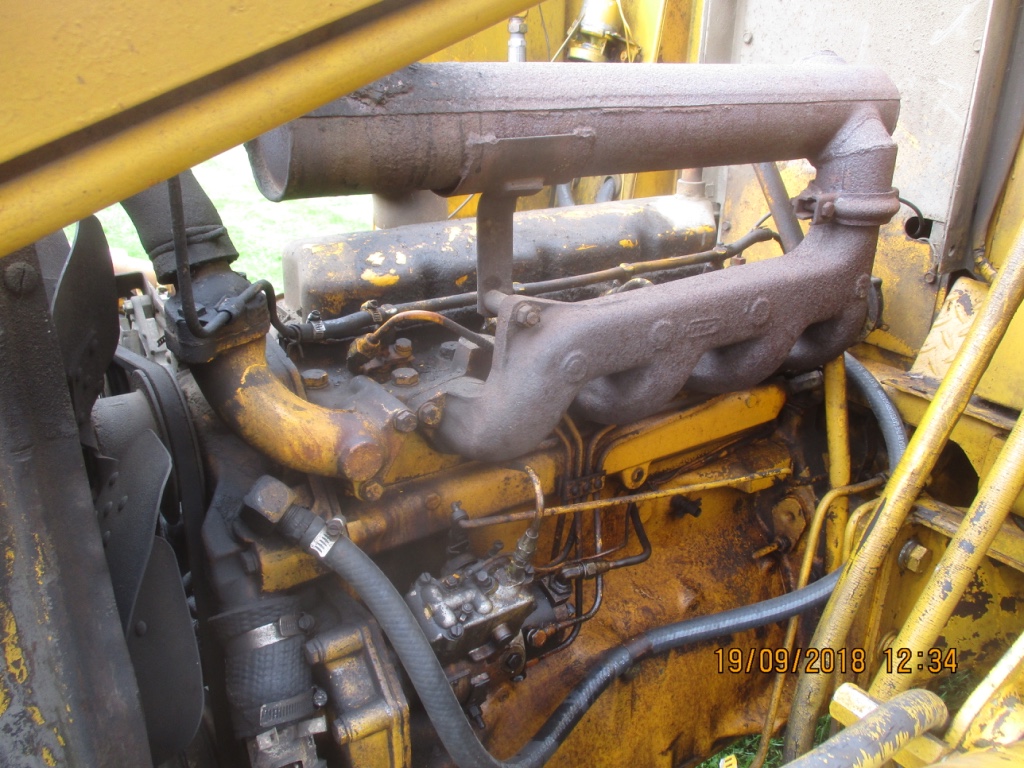

I have owned a 1978 JD 310A for the last 28 years to work (mostly to improve the decor)
on my small farm.
Last week, while working to pick up some heavy dirt, it quitted on me. No way to start it again.
A mechanic friend of mine, though not an expert on diesel motor, checked to see if the fuel was coming
through the filter, the pumps and the injectors. When everything was screwed back in place, surprisingly it worked again
for a while, although the motor was not settling properly, turning faster and then slower.
Yesterday, I changed the fuel filter and I was able to start it to move it a few feet as needed.
Today, nothing. It seems no fuel goes to the injectors. The transfer pump was taken out, checked and
is in working order. Fuel runs freely from the tank to the transfer pump.
It also goes to the injectors pump but still it does not start even with ether.
Does somebody knows where I should look at to fix this problem?

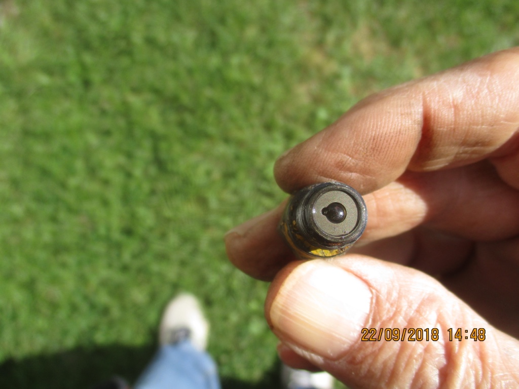

Yes.. u see that fitting on the top cover on the injection pump?? the 1 the return line screws onto..
Remove ALL the fittings.. ALL THE WAY DOWN to the alum. top cover.. you should have an open hole on the top cover..
NOW START IT..
IF it starts, the check ball in the fitting is clogged.. & that's not a GOOD THING.. prob. means the flex ring inside the pump has broken up & is sending chunks back to the tank.. or trying to..
The reason it shuts off is.. if u cant get fuel OUT.. u cant get fuel IN..
I rebuild those pumps & have 25-30 years experience.. lemme know if I can help.. TPG

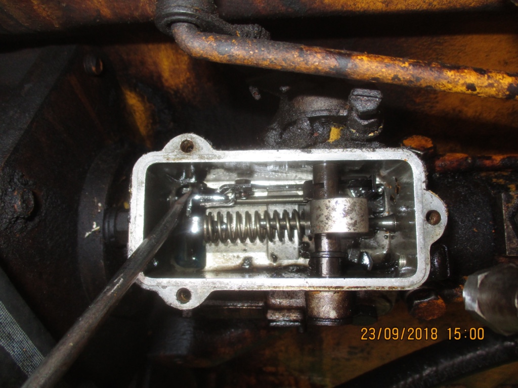

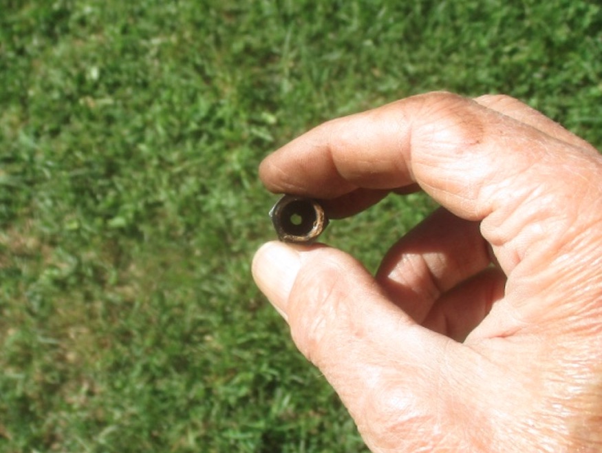

Well, it did not start and I hope it's a GOOD THING. The glass check ball looks clean and move easily.
I put the fitting back on but the motor did not want to start.
I primed manually the transfer pump and fuel would come out on top of the fuel filter once the plastic bold was loosened. Still, it did not want to start even with some ether.
Would you have some idea as to where I should look for?

/ JD 310A fuel/air problem or? #8
Did u try to start it w/ the check ball fitting removed?? That's what u need to do..
1 more test then.. try to remove the top cover on the injection pump..
Its just 3 screws.. The metering valve might be stuck in the shut off position..
Just google > "roosa master metering valve" to find what your looking for..
Did u make sure u have power going TO the electric shut off solenoid, located in the top cover of the inj. pump??
U should be able to HEAR it click when u turn the key on.. & FEEL it thru the t. cover....

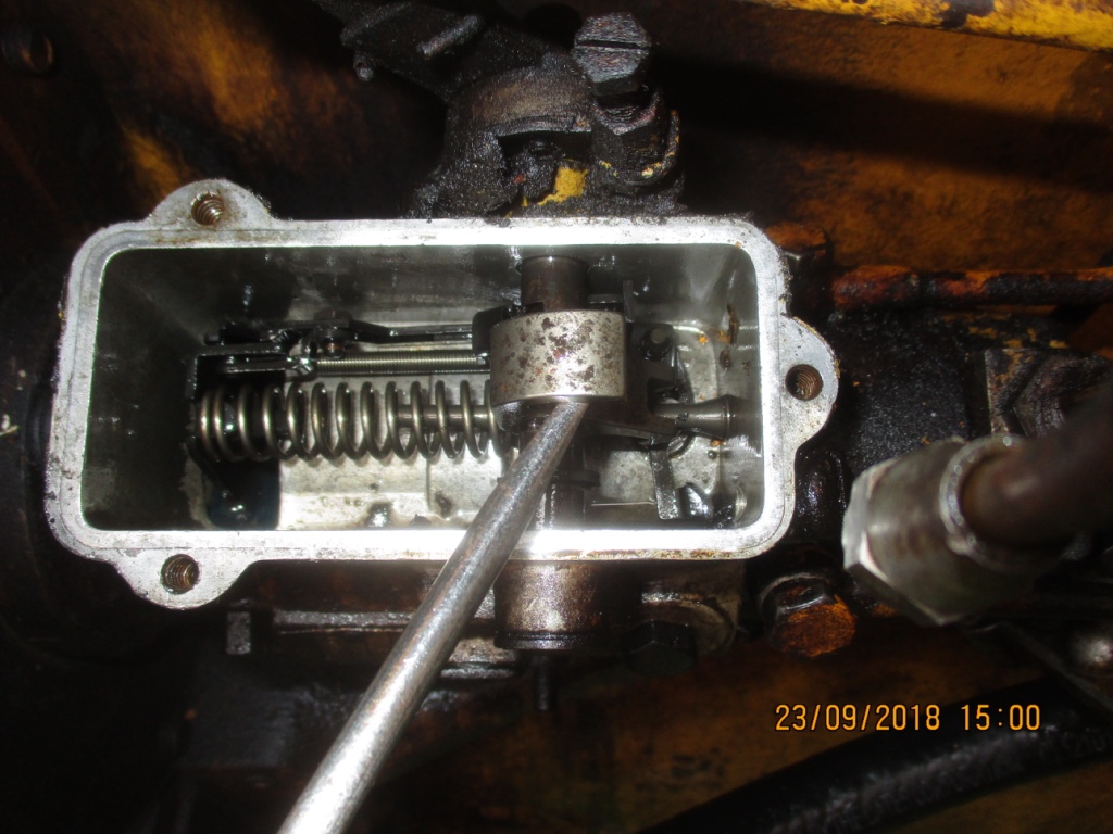

Yes, I tried to start it with the check valve removed.
With the cover off, I can see the metering valve, but I am not sure what to look for.
I am not sure if the electric shut off solenoid works, because when I am in the cab I can hear clicks but I cannot say if this its from this solenoid.

Yes, the MV moves freely.
I got a surprise when I took the cover off. It was full of fuel that I drained off and then saw some black gunk.
Where do I go from here, talk to my bank manager?
Thank you again TPG, you're helping me a lot and probably some other people also.
/ JD 310A fuel/air problem or? #12
That's the classic "mouse turd" syndrome.. or coffee grounds..
The flex ring has come apart inside the pump.. & a rebuild is required.
I can help you out w/ that.. just click on my name..

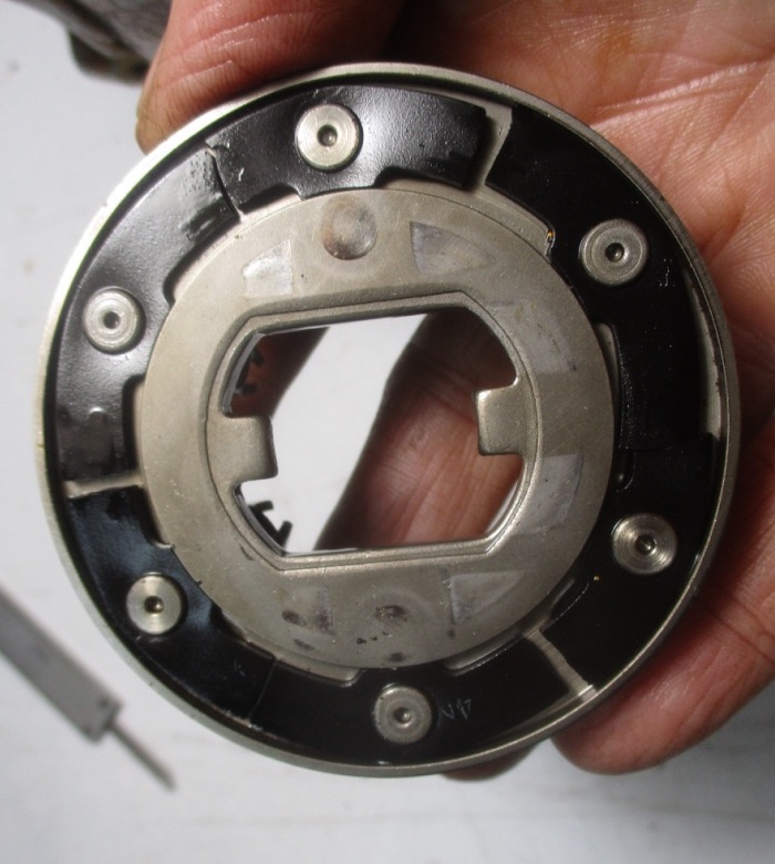

Well, TPG was right. The flex ring had come apart, 6 parts to be exact.
I am doing the rebuild myself to save a fair amount of money. It's a bit scary.
There are so many parts. I doing on slowly and I have some videos on my
computer by my side. And I take pictures all along. So far so good.

How did u get the cam ball out?
Are u going to use a new flex ring or an EID weight retainer?{solid}
Does your pilot tube have any grooves?

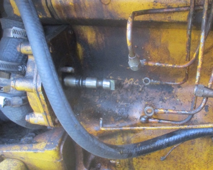

When I reached the flex ring, I stopped dismantling the pump.
The flex ring I put in came with the rebuilding kit I got. Probably made of nylon.
This took me a while since I was afraid to tear in up. If the weather is nice,
I'll try to put it back on tomorrow. But before that, I need to figure out how
to change the umbrella seals on the shaft. I thought this shaft would come out
when I pulled the pump.

/ JD 310A fuel/air problem or? #19
Take a GOOD LOOK at the seals & reff. your pic.. 1 goes towards the engine & 1 towards the pump.
There is a tool{tube} that slides over the shaft & then u slide the seals on the tube..
You can use a plastic bag to help glide the seal on.. the plastic will help the seals from not entering any grooves..
Lube the H*LL outa them.. I use vasoline, as it washes away.. UNLIKE grease..
The DS seals are very forgiving & flexable.. Don't be afraid to pull & tug on them..
