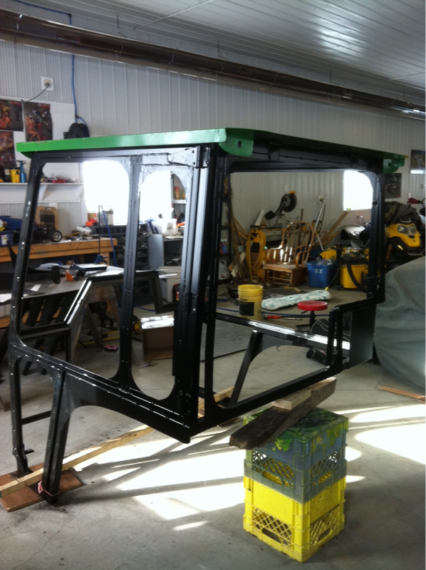

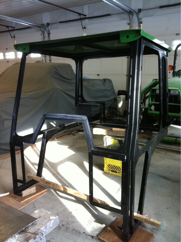

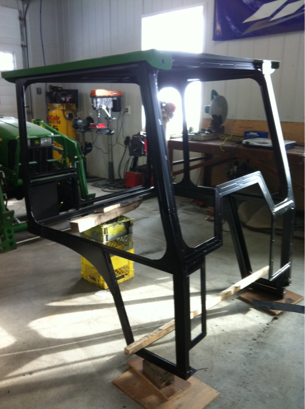

Pics of cab returned from powdercoater.
Nice job on the cab!!!;)
Have you did anymore work on it ??... I've been planning to build a cab for a couple years now, Just have too many projects going on right now!:eek:
Thanks for sharing!!!... Lookin' forward to seeing it finished!

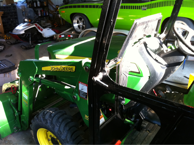

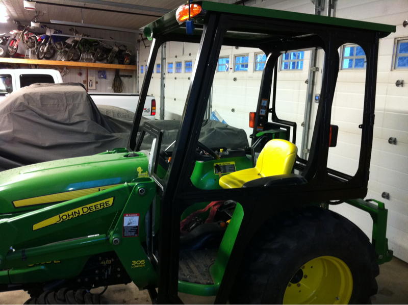

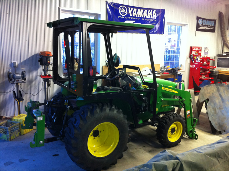

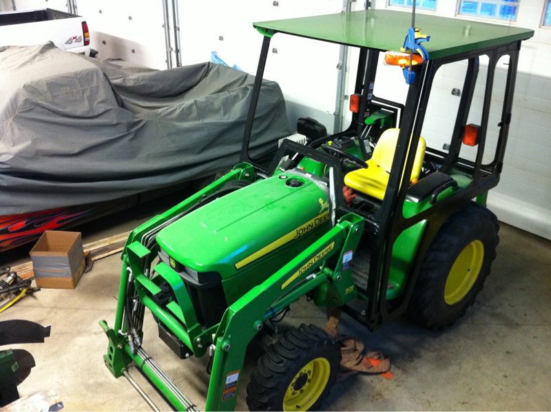

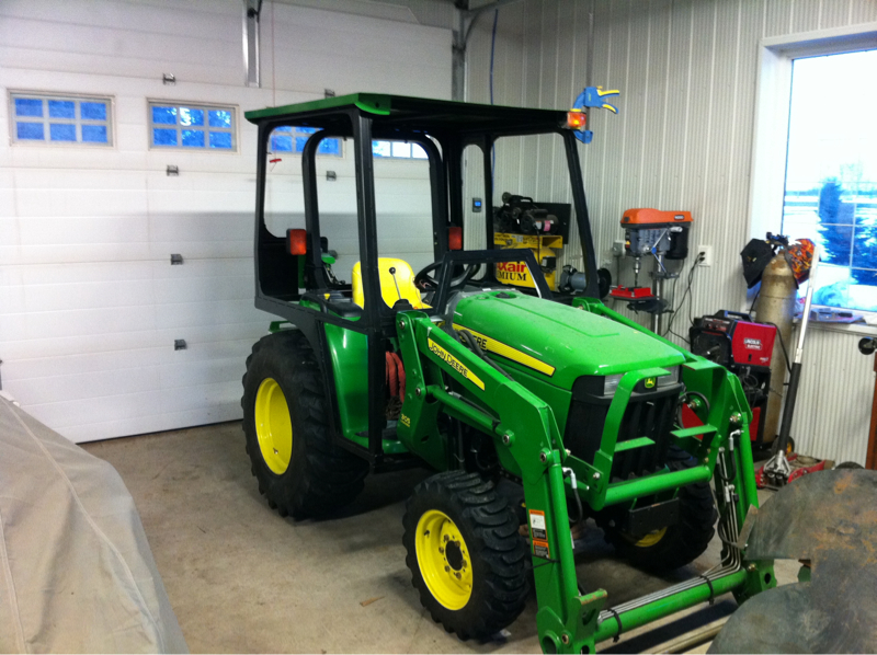

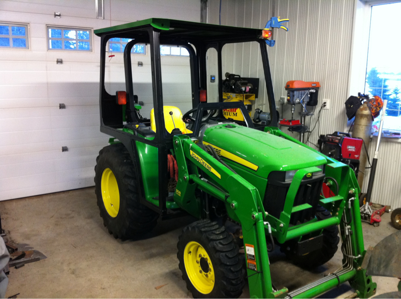

Was able to get a free minute and decided to install cab on tractor. Worked away from home most of March and haven't had time to work on cab. Looks like I will be busy at work for a bit but am still hoping to get a few little things done in next few weeks.

   / JD 3038e Homemade Cab #26
Looks great! :thumbsup:
   / JD 3038e Homemade Cab #27
You did a great job on your cab!!!:D... It looks great on your tractor too!!!
I just noticed the top and I like how you made it!!!... Can't wait to see pictures when you get the glass installed!!!
Do you have any idea how much it all weighs ??
Thanks for sharing!!!;)
Bill
   / JD 3038e Homemade Cab #28
Looks great!
   / JD 3038e Homemade Cab #29
Looks more like factory than home built. Couple questions..
What guage metal for the top ? Did you have to reinforce it with strips inside ? Also what did you use to hold the gasket material on the windows ? Did you go with thin metal strips welded to the tubing ? How far does it extend past the structure... or does it depend on which size gasket material you use ? Did the powder coaters do both semi gloss black and green top ? Ballpark figure on cost of powder coating. How well did the hockey pucks work out ? Any noticeable change in vibration ?
Thanks in advance for the info. Alot of hours but very nice improvement.
#30
Sorry been away. Think I used 18 gauge For Roof.(Think)
There is 1" Square tubing down the center as was planning to use 1" styrofoam or equivelent and cover with some type of material. Extends approx 3/4" past fenders. 3/4" by 1/8" thick angle for trimmed for windows as most gaskets require 1/8th. Have no windows but am going to take glass and rubbers out of few of father in laws old junk combine and swather as old ones are safety glass and can be cut. 300 ish on powder coat.(with blasting) I never paint anymore. Been using cab as pics show when I need it and no issues with pucks no noticeable vibration. as all floor is coverd in 1" thick rubber mat also. I am only home 2-3 days a month so unable to get anything done unfortunately.

Overall I think a full cab intimidates some. The build itself isn't that difficult with a good bandsaw and wire feed. The plan is the most important issue. This build is typical of the many others out there with a good design and taking the time to make metal openings square for a good door / window fit. Nice job. Sure beats spending 3-4k on a manufactured piece. Most of the materials can be purchased for the shipping cost of a new one. I don't know if the hockey puck idea is that functional. They are hard plastic with little give. I will use some form of rubber belting that can obsorb some vibration and eliminate its transmission to the roof tin. I am a fan of safety glass so I would seriously give another look to using a plastic counterpart. I don't know if it would make a huge difference but adding dynomat to the interior surfaces sounds like a good idea.
I plan on building a cab for my 4110 John Deere. Depending on how it works out there may be another for the New Holland TC55DA.
Again, nice work. Thanks for posting. It may encourage others to take a closer look at new fabrication ideas.
   / JD 3038e Homemade Cab #32
You can get dense foam rubber "street hockey" pucks that should take the load and provide more of the dampening effect you're looking for.
