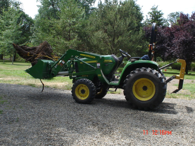

I really like how the position control performs on the 3032e.
