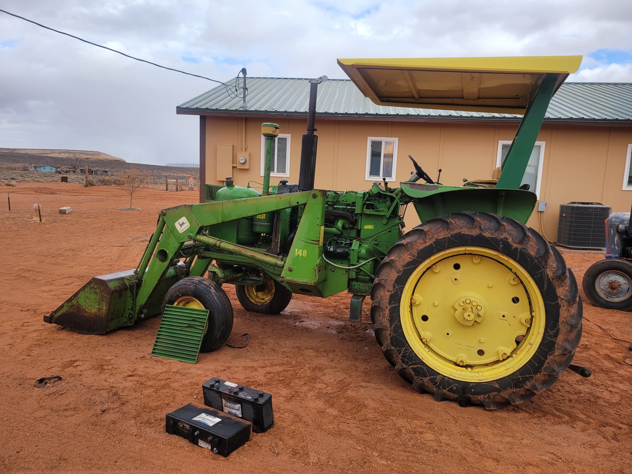

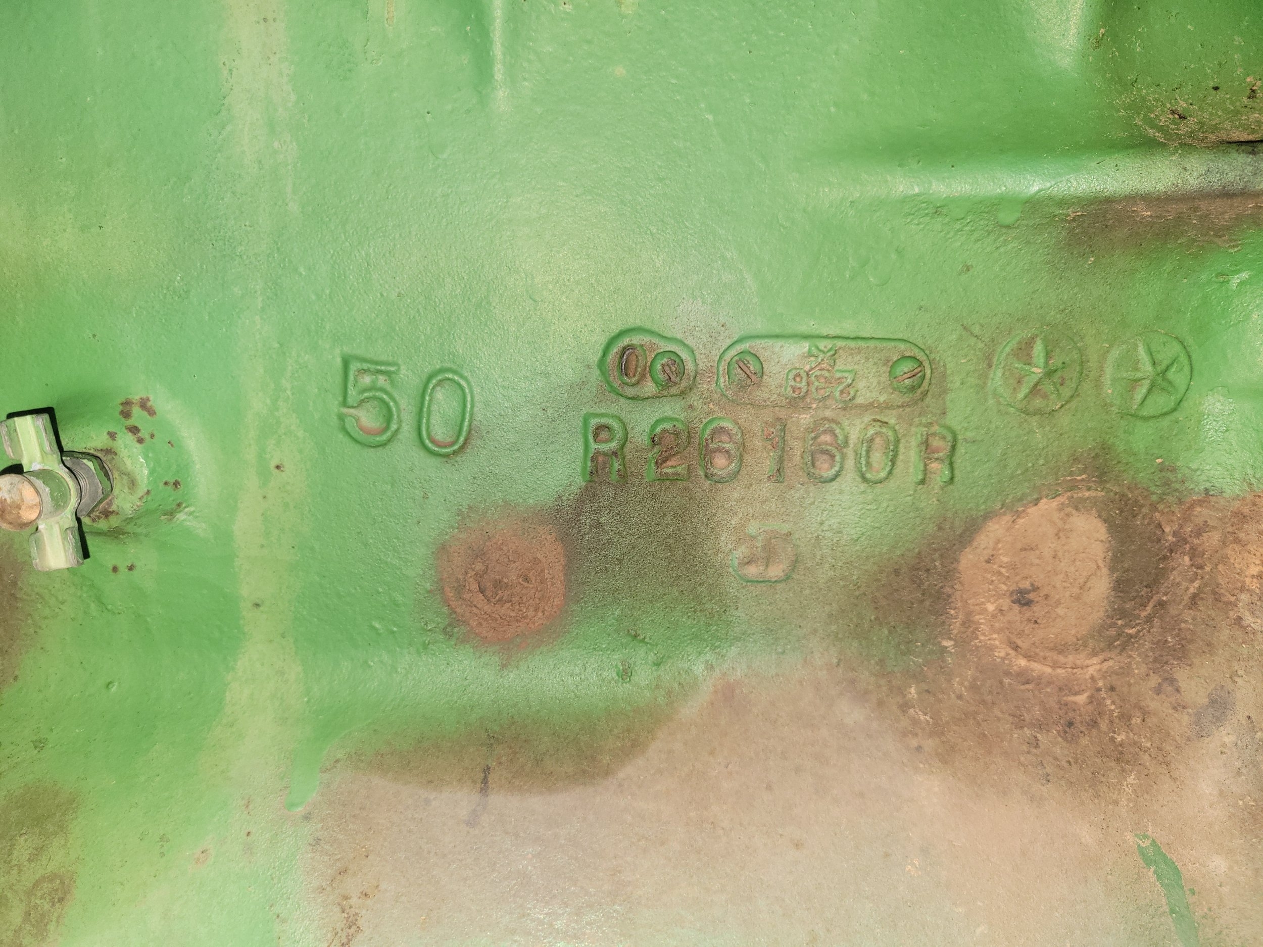

I'm new to the forum and new to this tractor so thank you for any help you may be able to give. I got this tractor from my father in law who said he was moving some dirt one day and the tractor just shut off and wouldn't restart. He had the low pressure pump and all the filters changed and no difference. He gave up on it and gave it to me. I've included the serial plate and can't find any information on the numbers I have stamped here. Looks like "11T 4331" to me. Also the tractor is supposedly a 3010, the engine casting says its a 3010 engine but the injection pump from my understanding and research is off a 4020. Is that correct? And can a 3010 use a 4020 injection pump or is that one of my issues there? I'm looking at getting it rebuilt but not sure if I even can or if it would be a waste of money. Any information is helpful, thank you.

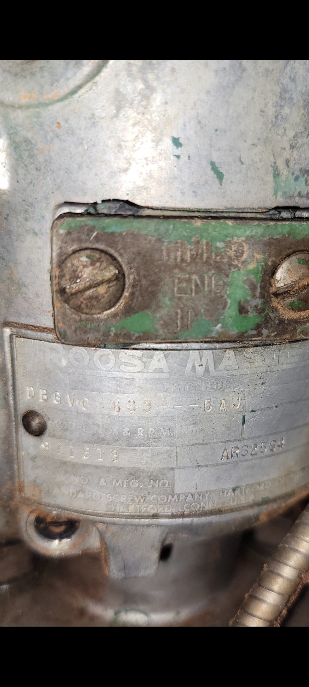

Thank u for posting the inj pump name plate.!!
That is indeed for a 4020..

Hold the bus..
The inj pump name plate that u posted..
DBGVC 633-5AJ is a 6 cyl pump..
THAT won’t work on a 4 cylinder engine..

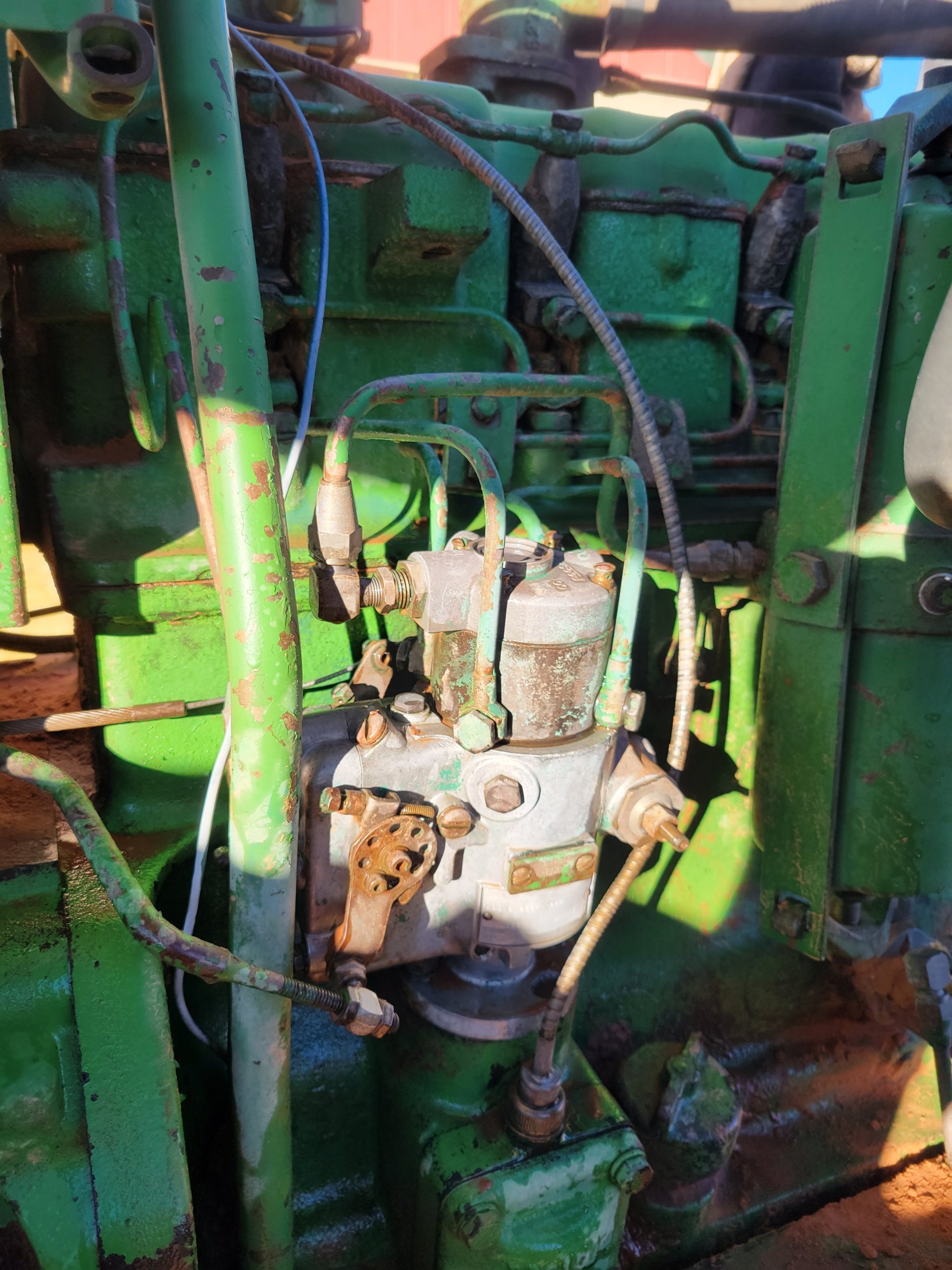

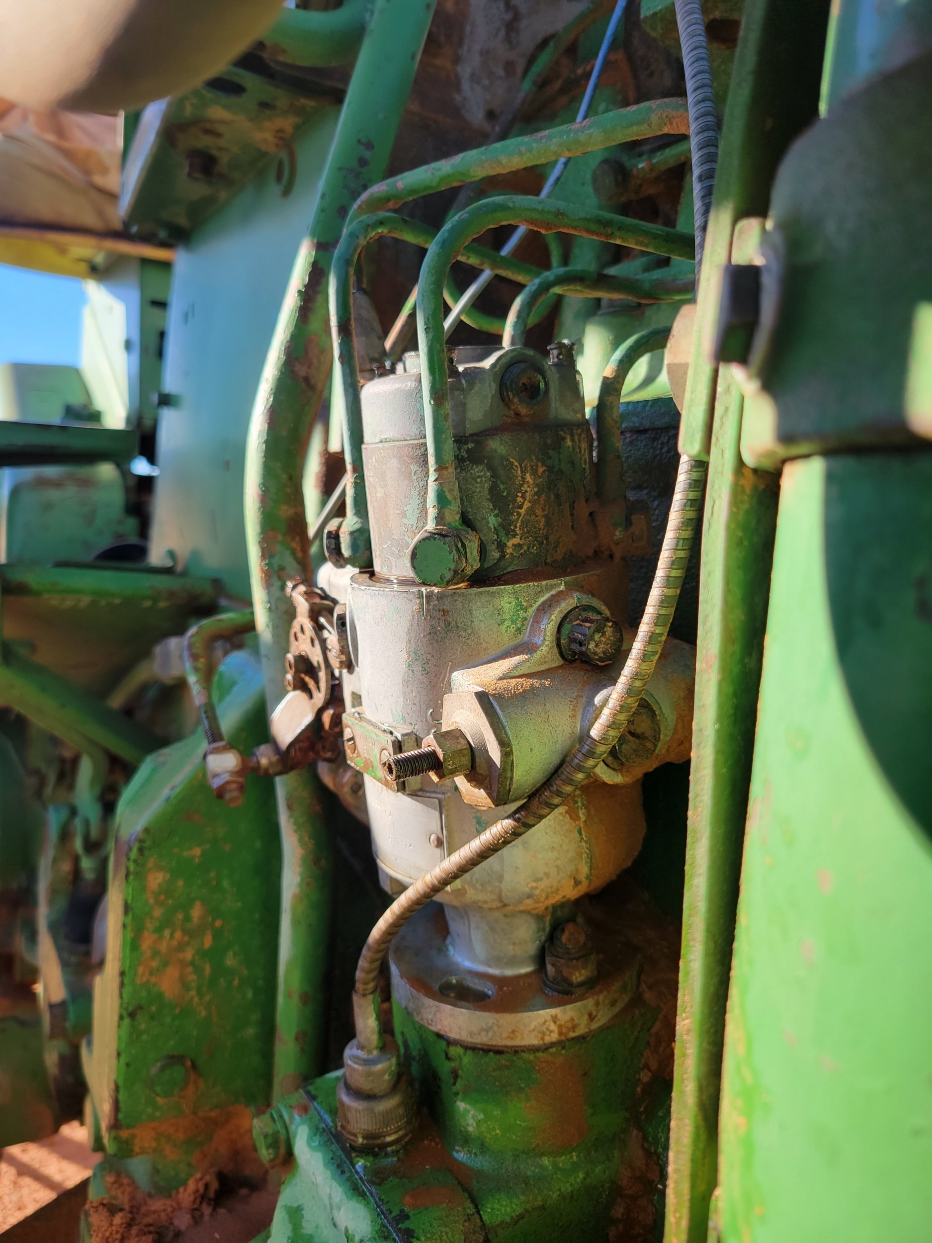

Yup, that's what I just noticed. I'll post a picture of my pump so you can see how it's set up.

For reference, the 1st # after the letters is the # of cyls..
DBGVC 431/433 would be a 4 cyl pump..

/ JD 3010 serial number and injection pump help #11
That sure looks like a 4 cyl from where I’m sitting..
/ JD 3010 serial number and injection pump help #12
Yes u r correct.. but I haven’t a clue how that happened.
