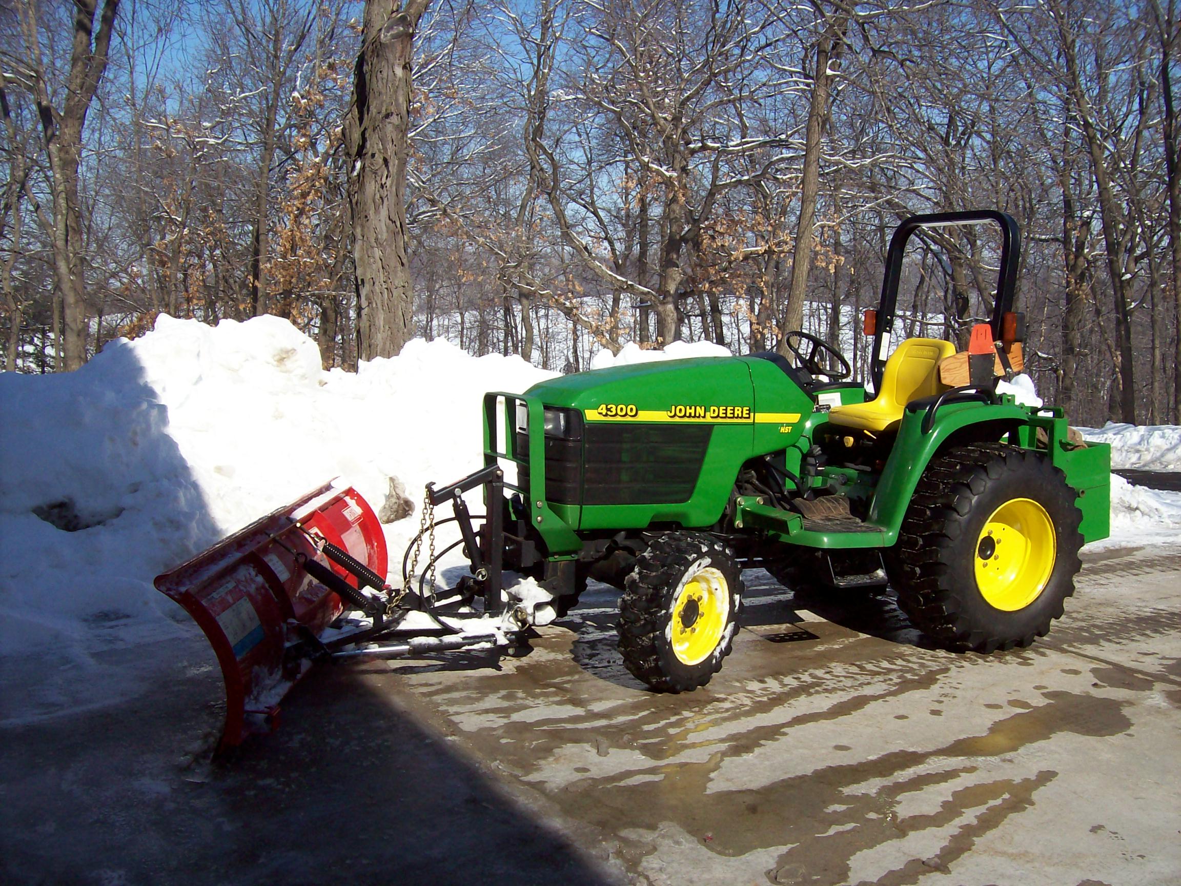

Hi, I have a Chineese Tractor with a copy or the JD quick attach system, only they put the pins on the inside instead of the outside and have a 1" steel across the top of the FEL bracket instead of the the hooks on each side. Anyway I did fab up an adapter for an 8' plow I attached to the FEL frame. It may be of some help.
Good luck Dave
Existing Loader Quick attach Bracket
This a clip from the thread and a video of the entire setup
HI Kenny,
It actually worked great.I forgot to post the update here. Too many forums and not enough brain cells. Below is the update from another site.What I forgot to mention was the quick attach. I can take on/off the plow (one pin) to use the new adapter for other uses and then the adapter comes off easily to put the bucket back on.
Its been awhile but after a few changes, I finally got to test my plow mod with some great advise from many. I adjusted my loader adapter
Old
OLDNEW
NEW
You can see I moved the part where the plow bracket attaches back about 1.5' to improve the balance. I also beefed up where that bracket attaches. Something I wanted on this adapter was to be able to have multiple uses, so added a 2" receiver on top for any other 2" hitch attachements. With this ,it also gave me a spot to hook the chain for the plow to further support and balance the weight. (this is an older 8' steel plow-very heavy duty). The welding is not great as I was doing it in not the best conditions but wanted to get it done.
I was very happy with the results
With Plow Attached
I adjusted the skid shoes so the plow edge was at max height until a good base on the road was set and then I could lower to a better height. Soon I will get the hydraulics for the angle set and get a better paint job and then it will be all set. I was by myelf so I couldn't get any action videos. Maybe next time.
