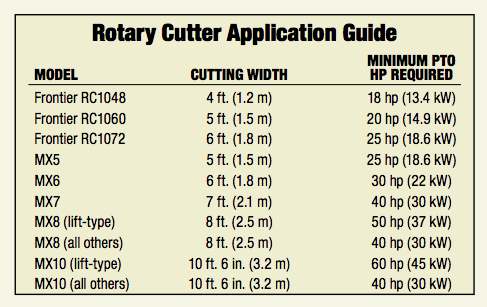

/ JD 2720 - Bush Hog Advice #3
- Spindifferent

Good information. Maybe the 5' versus the 4' would be a good choice for reaching into the sides of the trails.
