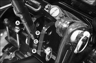

   / JD 2520 Snapped Axle #85
there was a rash of breakages of the top link bracket several years ago. I think that was attributed to using the wrong link hole.
Roy, just wondering which hole I should use on my Kubota, does it matter that much? Is one recommended over the other? I use a weight bucket (for snow removal) and occasionally a post hole digger. thanks.
   / JD 2520 Snapped Axle #86
For light and medium draft loads use the bottom hole. For medium and heavy draft loads use the middle hole. For very heavy draft loads use the top hole. Per JD owner's manual.
Example of a light-medium draft load - landscape rake.
Example of a medium draft load - tiller or box blade.
Example of a very heavy draft load - plow or ripper.

   / JD 2520 Snapped Axle #87
AKfish
AK answered before I did, but I thought I'd add the picture from the manual.
SRS, if your upper link attach point (on your Kubota) has more then one hole, it should be explained in your manual.
