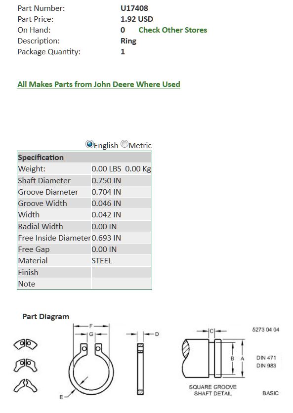

Does anyone know the diameter of the ROPS pins?
/ JD 2520 ROPS pin alignment #32
Here's the spec's for the snap ring used on the pin. Size of pin is stated at 0.750"
/ JD 2520 ROPS pin alignment #33
that's it. Thanks.
