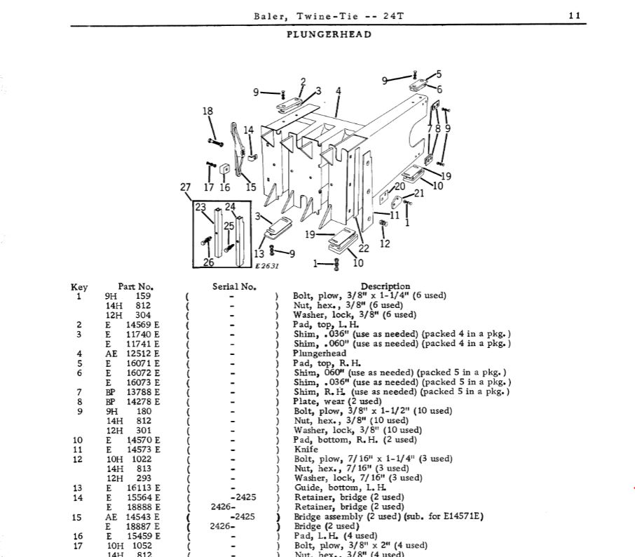

One thing I dislike about JD 24 series balers are the plunger head adjustment bridges with pads(parts keys 15 & 16) that are held on PH with one bolt that have a long history of breaking and the bridge can get lost in the field.
Years back I baled some hay with a JD 214 sq baler pulling it with a JD BO(14 HP). I just dropped hay on the ground IE no hay rack.
E18887 Support - SUPPORT, ADD 186.34 USD 186.34 USD
2 ea - E15459 Pad - PAD, ADD 55.23 USD 110.46 USD
