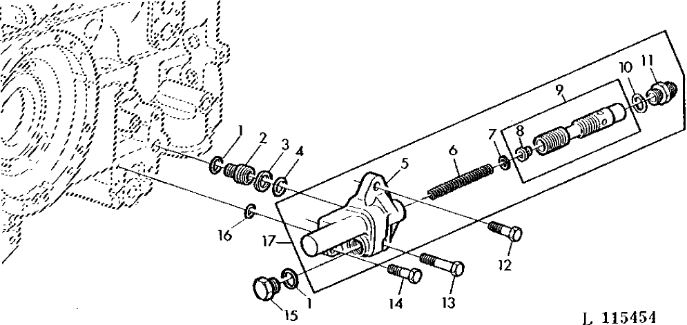

As stated rate of drop screw has ZERO to do with the raising of 3pt only speed of lowering. Problem could be stuck/faulty pressure control valve limiting pressure & flow to rockshaft. Does tractor have a loader? If so does it have an ind control valve or operated off SCV's? Have you ever checked stand-by psi? It should be 2250 #'s.

My tractor has flow control valve. It does not have a svc. The loader takes the hydraulic fluid from it. I have never check the pressure. I will do it.
As you can see, i am new on this, but i can figure out some things.I will check the flow control valve to see if i have some junk inside.

If loader operates quickly flow control valve isn't the problem since loader supply is attached to flow control valve.. Disconnect and cap where the return line from loader valve attaches to tractor. With both loader control levers in neutral,start engine with open return hose aimed in hyd filler hole. If oil spurts out of hose then the loader control valve is your tractors problem. Some hyd control valves have an internal quad ring that can blow caused valve to revert to the open center type.
