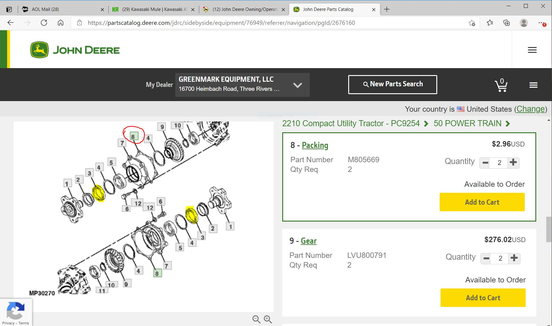

Looks like some wire got wrapped around my axle and it tore the seal apart, so constantly filling hydro oil. Has anyone replaced the seal? Is the gasket just RTV sealant, or is there an actual gasket- I don't see one on the parts diagram.
/ JD 2210 axle seal #2
I am guessing seal key 3 and gasket is key 8?
/ JD 2210 axle seal
i think that is the front axle, but i did finally find that the rear does use a liquid RTV sealant.
