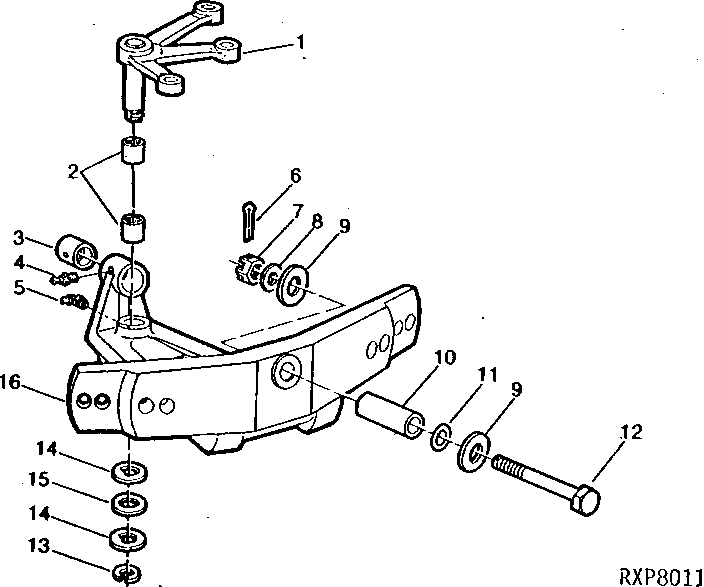

I have a JD 2040 with a fair amount of play in the steering wheel before it reacts at the wheels, what would cause this.
/ JD 2040 steering issue #2
Steering arm could be loose on shaft,worn drag link tie rod ends or loose bellcrank bushings/brgs. Remove rear most inspection plug in clutch housing and check bolt for tightness.

MY 2030 has a lot of play in the steering wheel too.
I've checked the steering arm at the gear box = tight. New drag link, knuckle bushings, bellcrank bearings, and wheel bearings. The only thing left is the four tierod ends.
I think it is in the steering box itself and just their nature. As long as no hydraulic leaks, I'll live with it.
