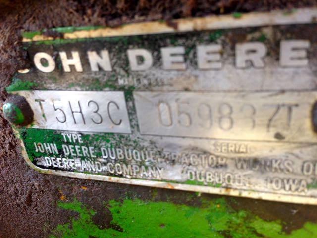

JD 2030 Tractor Serial number. Please see photo of serial plate.
can anyone tell me about this tractor. year of manuf. etc from this serial. thanks in advance

I Googled "T5H3C" and that took me to Tractordata page for a 2020 which would make your tractor a '67 model. Where is serial number plate located(under seat on trans case or frt support above axle)?
On 2030's there were 2 different models built(1 for sales in N. America & 1 for sales in European countries).
/ JD 2030 Tractor SERIAL #?
serial plate is under the seat on right side. I'm told it's a 1974? tractor has markings 2030 all over.... JD dealer told me if it doesn't have front lights (it does not) it was not made in germany.. tx
serial # reads: T5H3C 059837T

Here is an explanation of the 2030 serial number. It appears that this is a 2030. "T" is for tractor, "5" is for 2030, "H" is for Hi crop utility, "3" is for diesel, "C" is for collar shift transmission.
Well, on further research, I am confused as well. Apparently The "5" can mean a 2020 as well. The 820 and 1020 utility tractors have "4" in that position of serial number.

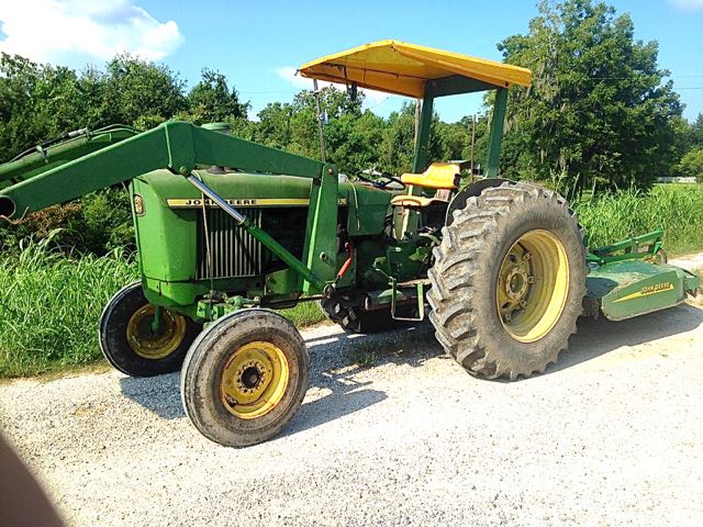

/ JD 2030 Tractor SERIAL #? #12
By the way, could you post a picture? Don't see too many hi crop utilities around this area.
#13
that's good information. high crop utility? i like it....
yes i will post some better pictures asap... tx

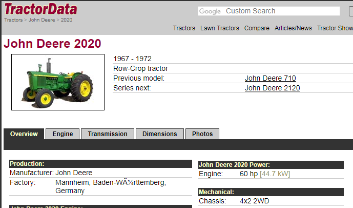

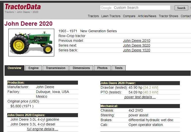

Tractor data says 2020s were manufactured in Germany?
/ JD 2030 Tractor SERIAL #? #16
Although Tractordata is a very informative site there is some incorrect information posted on it. Plus as I previously stated there were 2020's built for sales in N America which were built in Dubuque,Ia & 2020's built for sales in Europe which were built in Mannheim,Germany. I've never seen a 2020 built in Mexico but I'll bet they went to Spain. There are 2 different listings for 2020 in Tractordata.

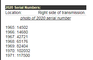

/ JD 2030 Tractor SERIAL #? #17
059837T doesn't show up in 2030 serial number range but it does fit in 2020 serial number chart..
