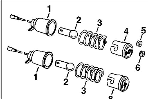

Are you aware you can view 2020 parts catalog for free at JDparts.com plus if you register with a JD dealer you can check price plus dealer availability of part?
Parts key 1 AT44165 Wiring Lead - LEAD, LIGHT ADD 17.76 USD

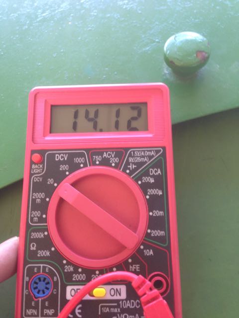

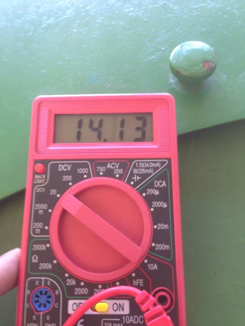

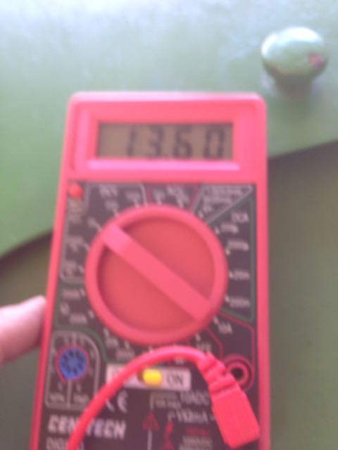

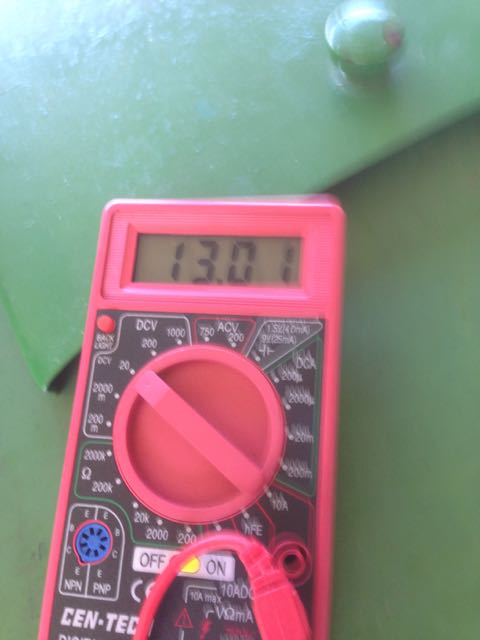

Deere shop says alternator was fine.
on the voltage meter the battery registered 13.03 off, 13.65 at idle and 14.13 with higher rpms. so i'm getting juice back to the battery.
AND when i upped the rpms the new jewel LED alternator light actually shut off. i did order the replacement JD alt light but guess now it's not needed...
