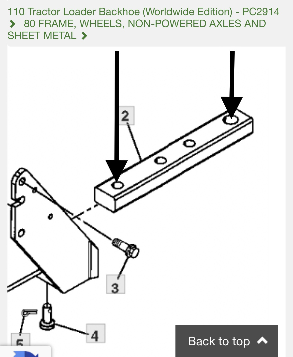

Could someone help me with the center to center measurement of the drawbar? I’m using a drawbar from one of my parts tractors.

Just full of knowledge aren’t you. Reread part of my first post below.
‘I’m using a drawbar from one of my parts tractors.’
Hence wanting to follow JD spec.

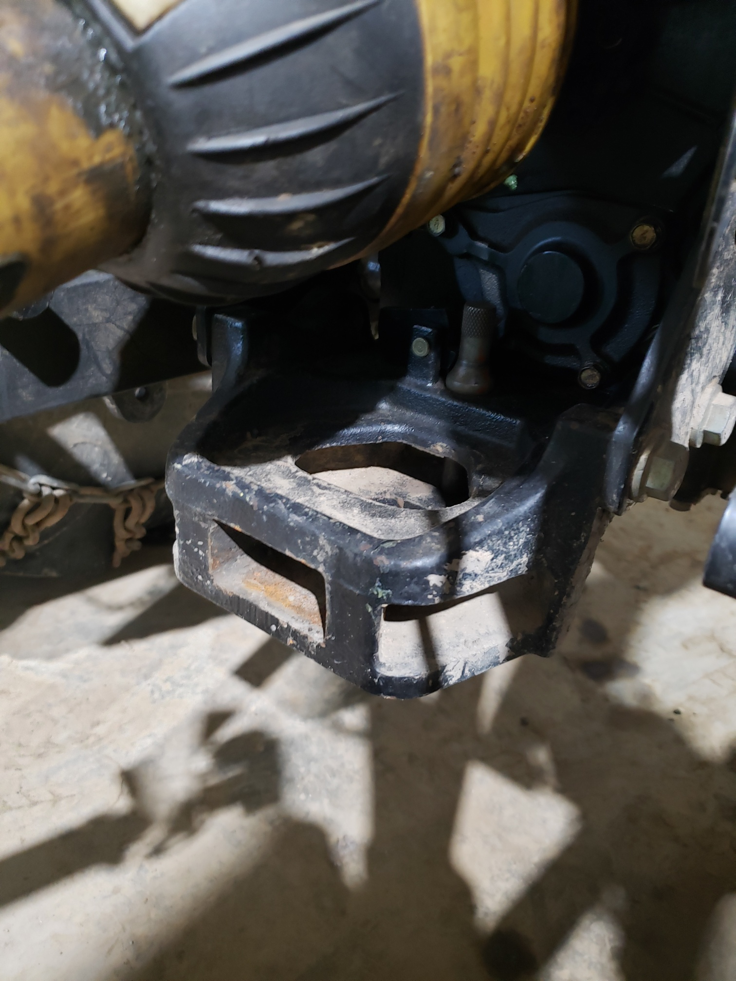

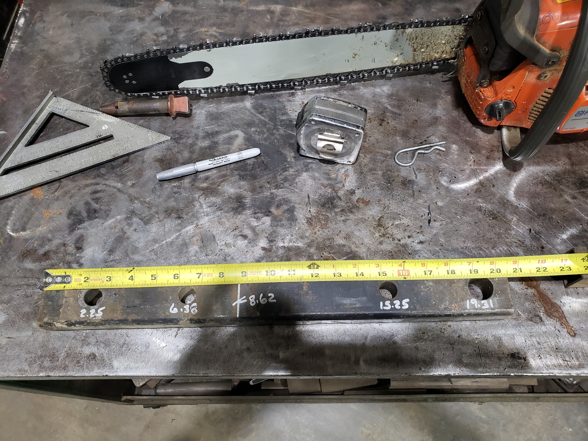

These attached pictures and dimensions are of a JD 4320 compact tractor. I think this 4320 tractor is a cousin to the 110 loader backhoe. The draw bar is 1.25" X 2.50" X 20.50".
The pin connection to the tractor is at the 2.25" dim. The 8.62" dimension is the end of the support shelf on the tractor adapter. The draw bar over hangs/ is not supported/ from the 8.62" dim to the 19.31"/ connection point. Because of the tractor c plate interference, the draw bar cannot shortened and pinned 6.38" dim. It only pins at the 2.25" dim. The 15.25" dim should be for a safety chain connection. Hope this helps. Later.

Thank you much, Oldtimer. That's a short little fellar, LOL, compared to my Case 5250. I do have the welded drawbar hitch bracket but believe the dimensions to be the same. You are a life saver.
