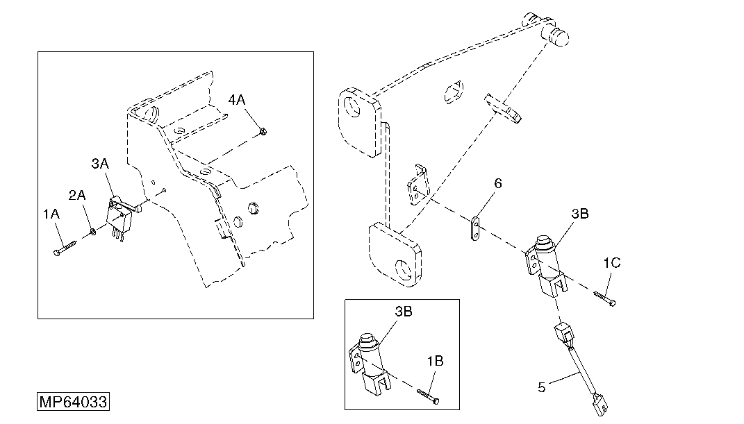

Hey all....
New guy here....anyone know where the brake light actuator switch is on my jd 110tlb.....stopped by the dealer, even they couldn't figure it out??? I took out the relay to shut off the brakes from staying on .....any help appreciated....:confused:

This is from JDP, not sure its going to help:
Brake Switch
Cart key PART NO. PART NAME QTY SERIAL NO. REMARKS
1A 19M8072 Cap Screw 2 - 310999 M3 X 25
1B R67654 Cap Screw 2 311000 - XXXXXX 4.826 X 12.700 mm
1C 19H3370 Cap Screw 2 XXXXXX - 0.190" X 5/8"
2A 24M7029 Shim 2 - 310999
3A RE30714 Wiring Harness 1 - 310999
3B LVA13307 Switch 1 311000 -
4A 14M7354 Lock Nut 2 - 310999 M3
5 LVA13664 Wiring Harness 1 311000 -
6 LVU18776 Plate 1 XXXXXX -

Hey thanks for quick response....the dealer brought up that same pic, but had no idea where I should look...my search takes me to the fact it has to be behind the fuel tank....and in that case..I'll just do with out brake lights..I was hoping to switch was actually assessble..oh well..
/ Jd 110 tlb brake light switch?? #4
third item in the service manual for that repair is "remove fuel tank" !!

Greetings Mr. Trauner. What year is your 110, or what style of brake light switch does yours have? If it is the earlier style with the small metal tang/lever instead of the newer plunger style you might be able to modify (bend) the metal tang so that it senses when you push the brake pedal. I have seen one where the tang relaxed, and would only activate the lights if you stood with all of your might on the individual brake pedal that the sensor 'sees'. Bending the tang allowed it to see the brake depressed with only normal, non-super human effort. I would suggest doing this a little at time, as too much would leave the lights on all the time, or break the switch.

I have a JD 110 2005 what is the year for the difference you were referring to in this post? Thx
/ Jd 110 tlb brake light switch?? #10
I do not know the year when they changed from 'tang' style 3a (in the parts diagram) to the 'plunger' style 3b you would have to look and see. but let us know... I know by 2005 several updates were made, but one should always confirm on the machine, rather than blindly trust what a computer says 'should' fit.
