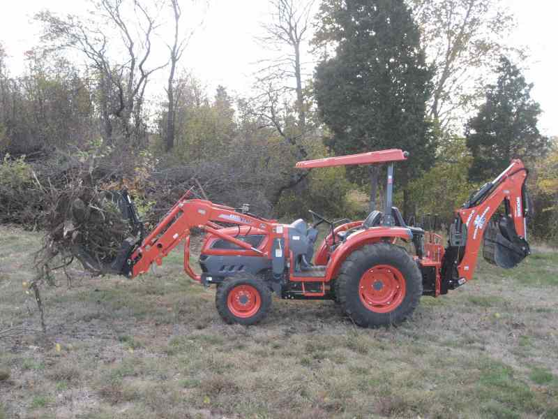

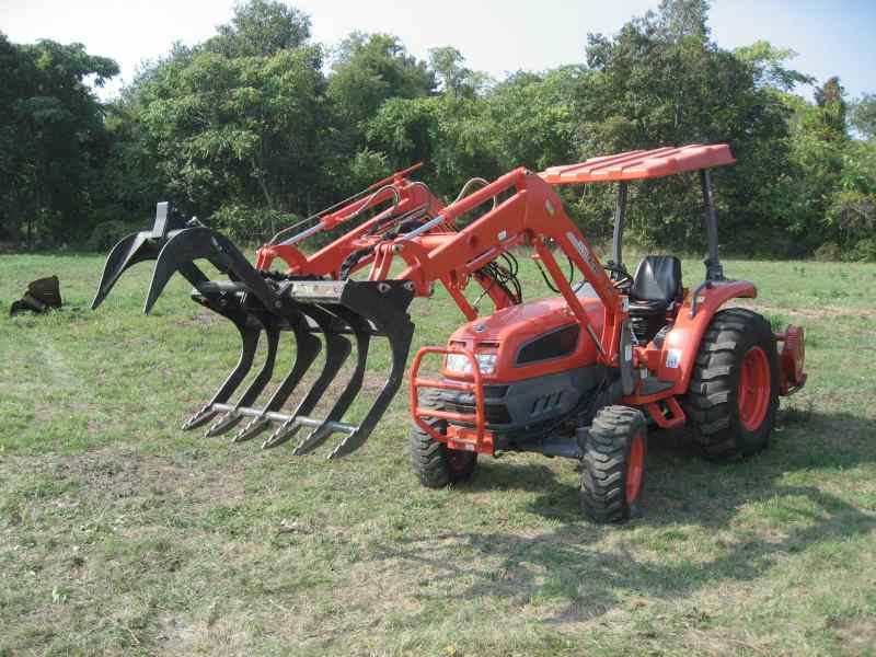

I don't know how many JD owners have Markham grapples. Ask this question in the Attachments subforum and you will get a lot of positive feedback from the Markham owners. I don't have one myself but I have three years experience with a similar Millonzi light duty grapple. From my perspective you should think about a 48 inch Markham light duty version (under $1000 delivered) with perhaps some extra bottom tines. That would be about equivalent to what I have. I use my Millonzi on a 5000lb tractor with a 2700lb lift capacity and the grapple is perfect. Don't get one that is too heavy or too wide and don't fall into the trap of thinking the grapple should be the same size as your primary bucket. Simplest way to control it is with rear remotes but many guys prefer diverter valves or electric over hydraulic both which cost much more.

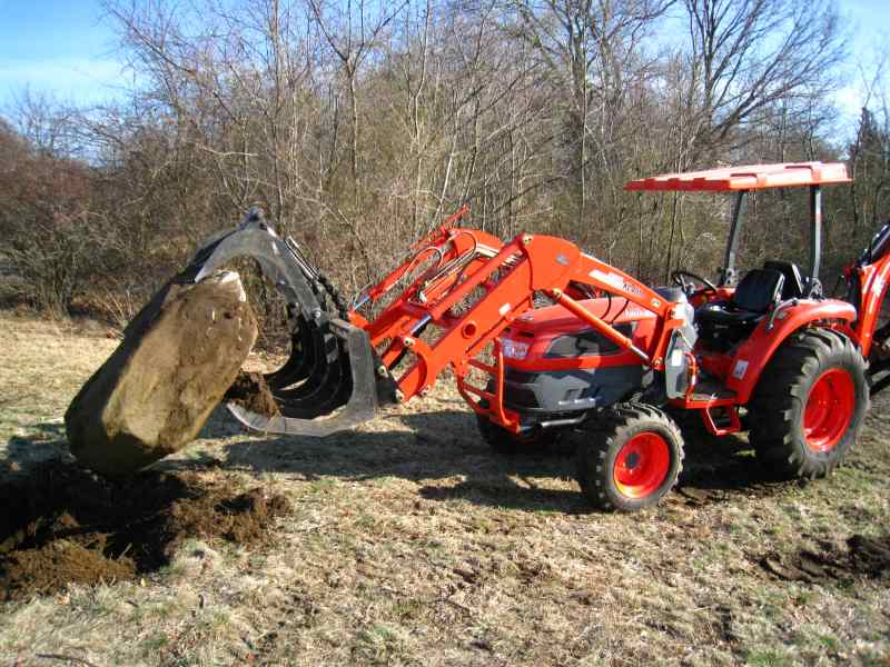

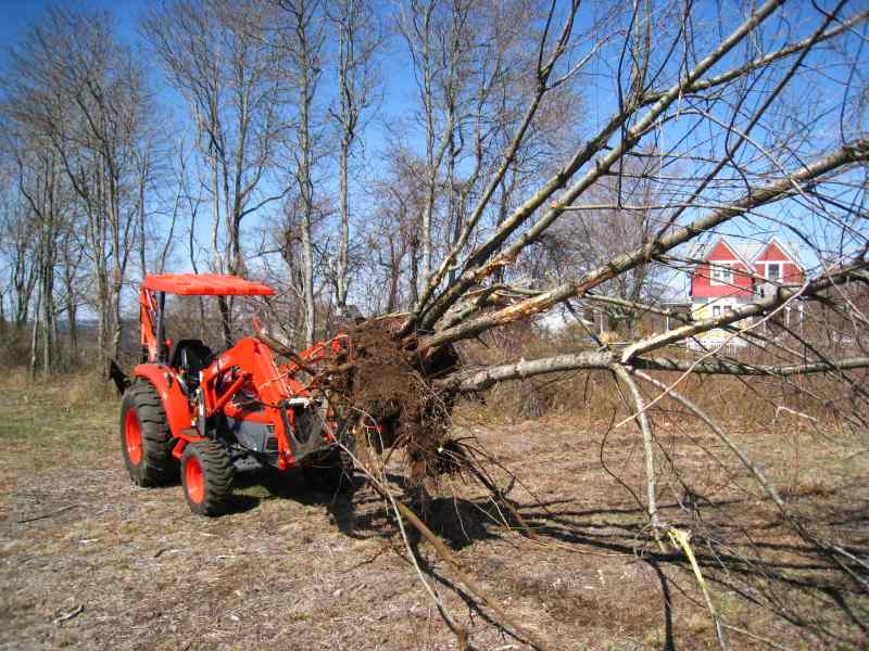

I own both grapple and forks. Love the forks and I agree that you could indeed carry a bunch of logs or carefully stacked small trees/branches with the forks but nothing beats a grapple for being able to uproot, load and crush brush as well as whole trees and tree stumps without needing to get off the tractor. Additionally, while one can cradle a loose load with forks, it is a lot safer to contain it between the upper and lower grapple arms when traveling.

Grapples work pretty well for roots. I would not suggest just putting the grapple tines into the ground and driving forward on a fishing expedition but when you know there are roots in an area you can easily dig them out with a grapple.

And they're not a "cure-all", either. They're meant for grabbin' onto stuff and rootin' up and tearin' out small trees, roots, vines, brush and haulin' it to a burn pile and dumpin' it on! If that's the work you have in mind - they'll do it!
There are some things to watch out for when you're using 'em, too. Carefully pick your battles... big stumps and thick roots can unbalance the load onto one loader arm and bend or twist your loader. Either the loader arm or one of the base stancions. As well, when picking up trees - with or without the root wad - try to balance the load. The longer the tree, the longer the lever. And there are significant twisting loads exerted upon the loader arms that can quickly make one arm "a poor cousin" to the other loader arm..
Many times, I will cut the root wad off and/or cut the trees up into shorter lengths.
