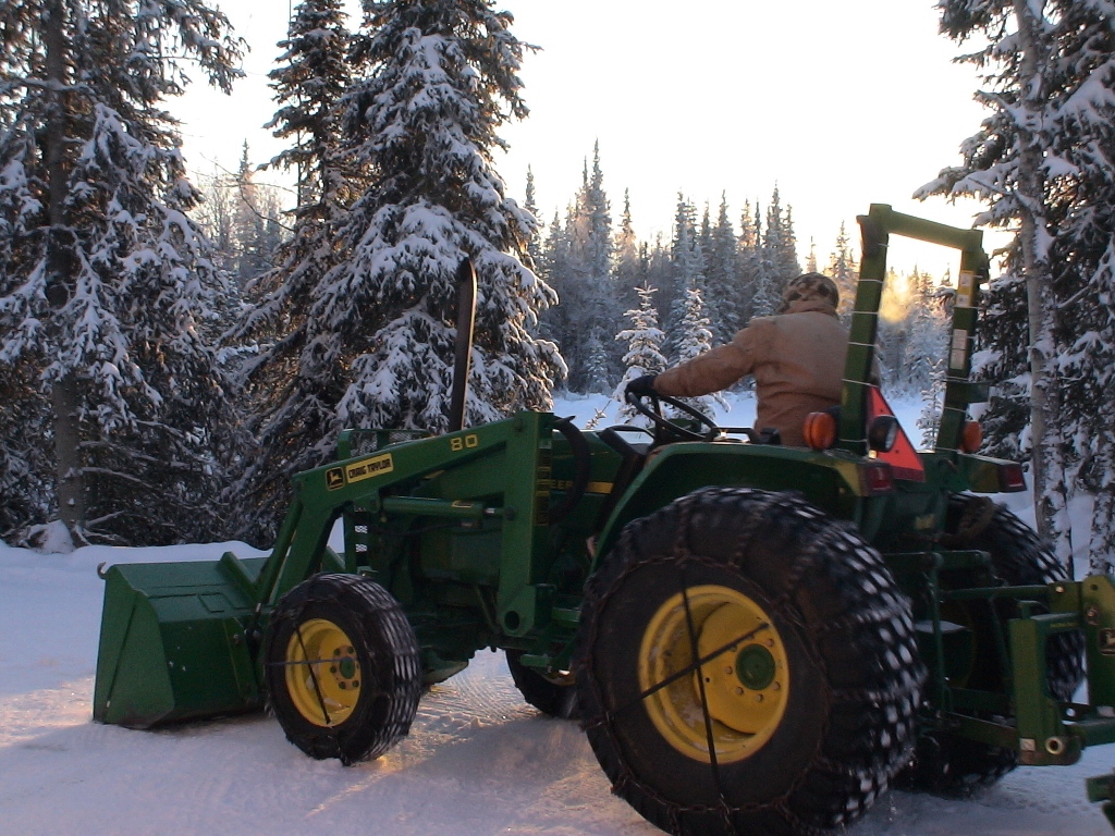

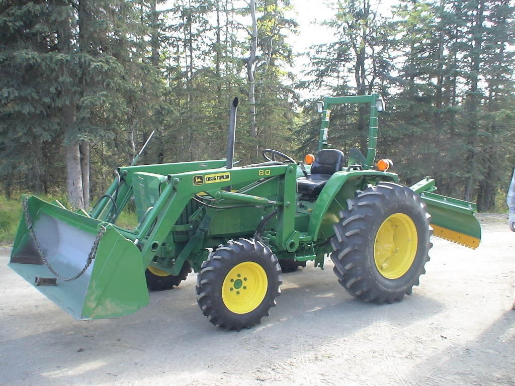

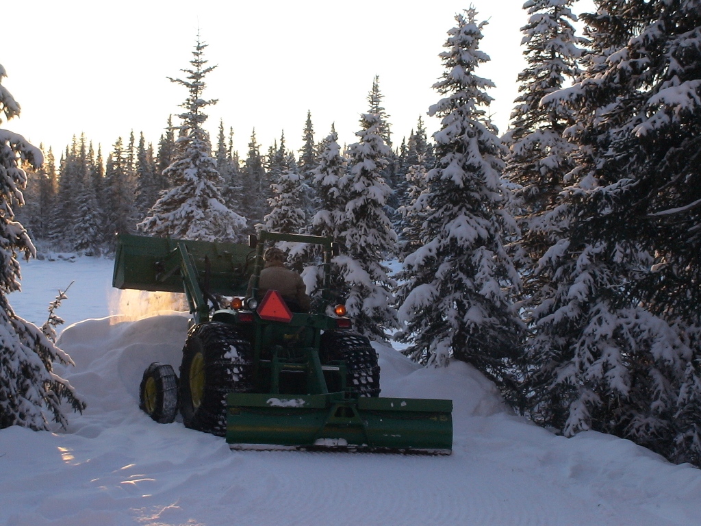

I had the same rear tire as you on my JD970. It was better in snow (with chains of course) than the R1's I bought later on. I didn't have them filled and I didn't ever think it was necessary - traction wise. (Although, in the summer, crawlin' around the woods really sucked! I was stuck (well, I always got out; but man, I tore stuff up) alot!
Put a chunk of ice-blade on my rear blade and 2 sections of train rail on top (see pic). I think the added leverage of the quick hitch helped as well on the rear blade.
I also modified my FEL bucket to increase the capacity for moving snow. Click the FEL into "float mode" and a touch right or left on the rear breaks once in awhile and down the road...
Best of luck.
AKfish

No question that weight (liquid or iron or a garbage can full of ice or road salt) will help. Try lowering your tire pressures a bit to get more forward bite. You need to watch out that the front grip and rear grip are balanced. The front and rear need to work together. If one axle has too much slip relative to the other, it will aggravate your traction levels.
There are traction coatings that can be sprayed onto tires to give them more bite if you look around. They eventually scrape or wear off, but work long enough to benefit your situation. You also should consider using a chain on the top link to let the rear blade float over road bumps. I modified my setup to stick a truck plow onto the front of my 1070. Never have had a traction problem (have rear tires filled 2/3 full) and have 6 suitcase weights on the front weight bar (240 lbs).

Moving snow is a matter of "adjustment" for me, generally. Deep snow or heavy wet snow - I won't even use the FEL on the first run down the road. Drop it down just off the top of the snow and lower the rear blade into the snow, but maybe hold it up 4-5 inches off the road surface.
That way, the blade doesn't load up with snow pukin' over the top and stackin' up into a big ball all the way into the 3pt arms on the tractor.
Might have to take 3-4 swipes to clear all the snow down to the road surface. Usually, by the 2nd pass I can use the front bucket without having the front end want to crawl off into the ditch..
There's no doubt -- having filled tires is a tremendous advantage for good traction. But there are some downsides as well. I didn't want the headaches of big ruts and tears in my pastures and lawn areas with filled tires.
Best of luck.
AKfish
